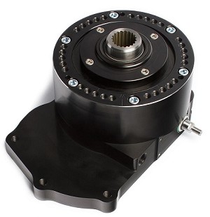

What's the word on this? Worth a lick or what? Thanks in advance. I have not been able to find much info.

I asked the Previous owner why he didn't want it in his 60? He said it was hardly used and didn't like the noise it made, but the noise could have come from the rebuilt H41(pictured) and when he removed it, drained the tranny said the tranny had mucho metalic particles. Probably the source of much of the noise!? He went with H55 and Sumo gears in the split case.
He said the tranny was rebuilt by SOR. Ill have to check the Black box out before I install. Ill contact NW Fab and get some advice.
I hope its not too noisy. My goal for the pig is to drive it to the Rubicon(or other trail), Run the trail, then make the trip back home.
