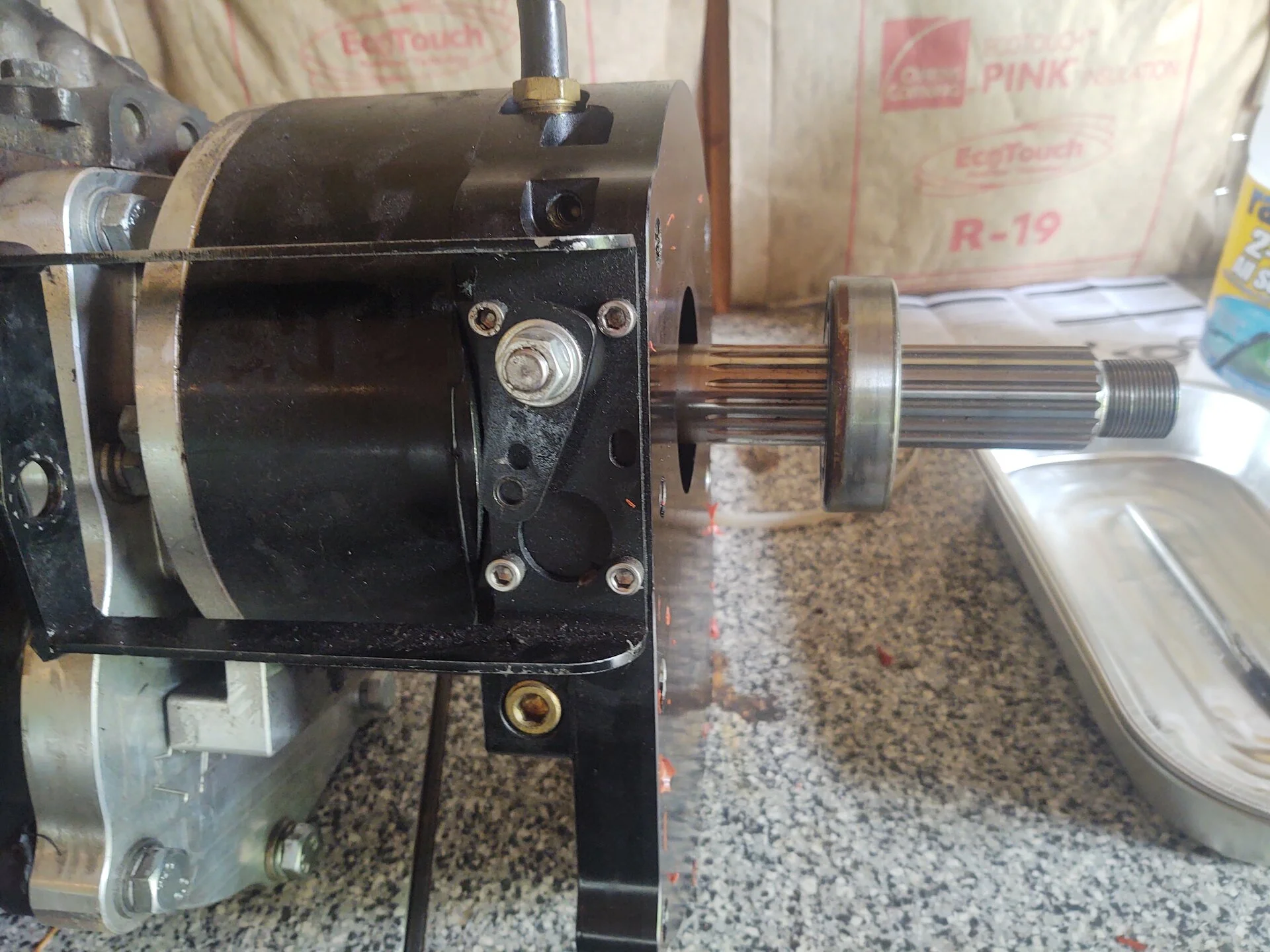

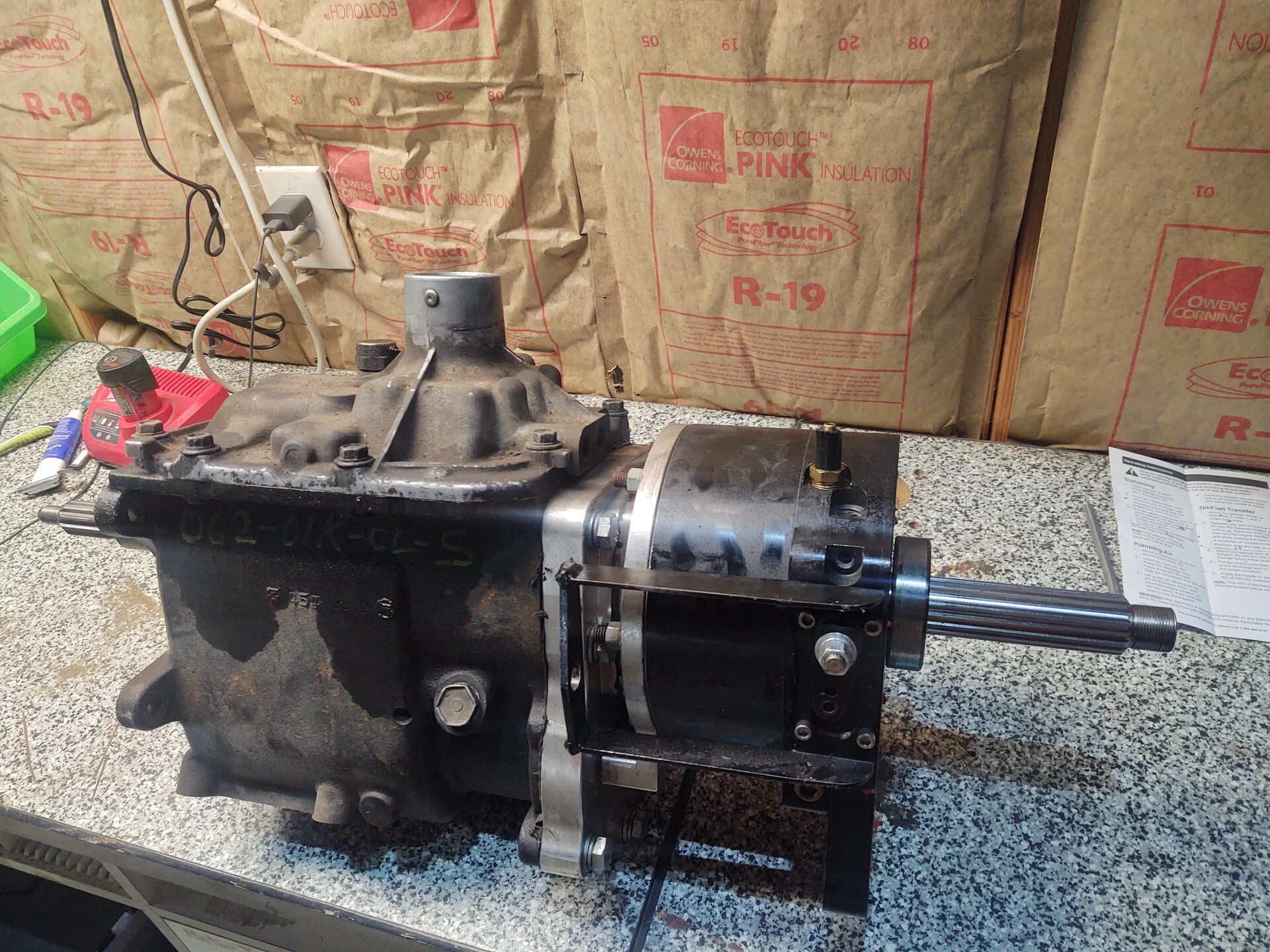

Here it is mounted to h41/2. 4 speed. It should bolt right up to my H55 then the split case should bolt to the box.
Just got off the phone with NWF. Had a great phone conversation with a guy that gave up a tremendous amount of information on the Black box.
I explained how I came into possession of my Box and how the previous owner said it was noisy. He explained some important details on the install dealing with a maximum input shaft length and support. So if you get a box definitely call them to get the details of the install!! He also suggested an external pump cooling coil and reservoir. Gave me a part number for pump.
Anyway I was on the fence about actually putting this thing in my Pig and now I'm doing it for sure. First thing is to tear it down and make sure the PO didn't damage it.
