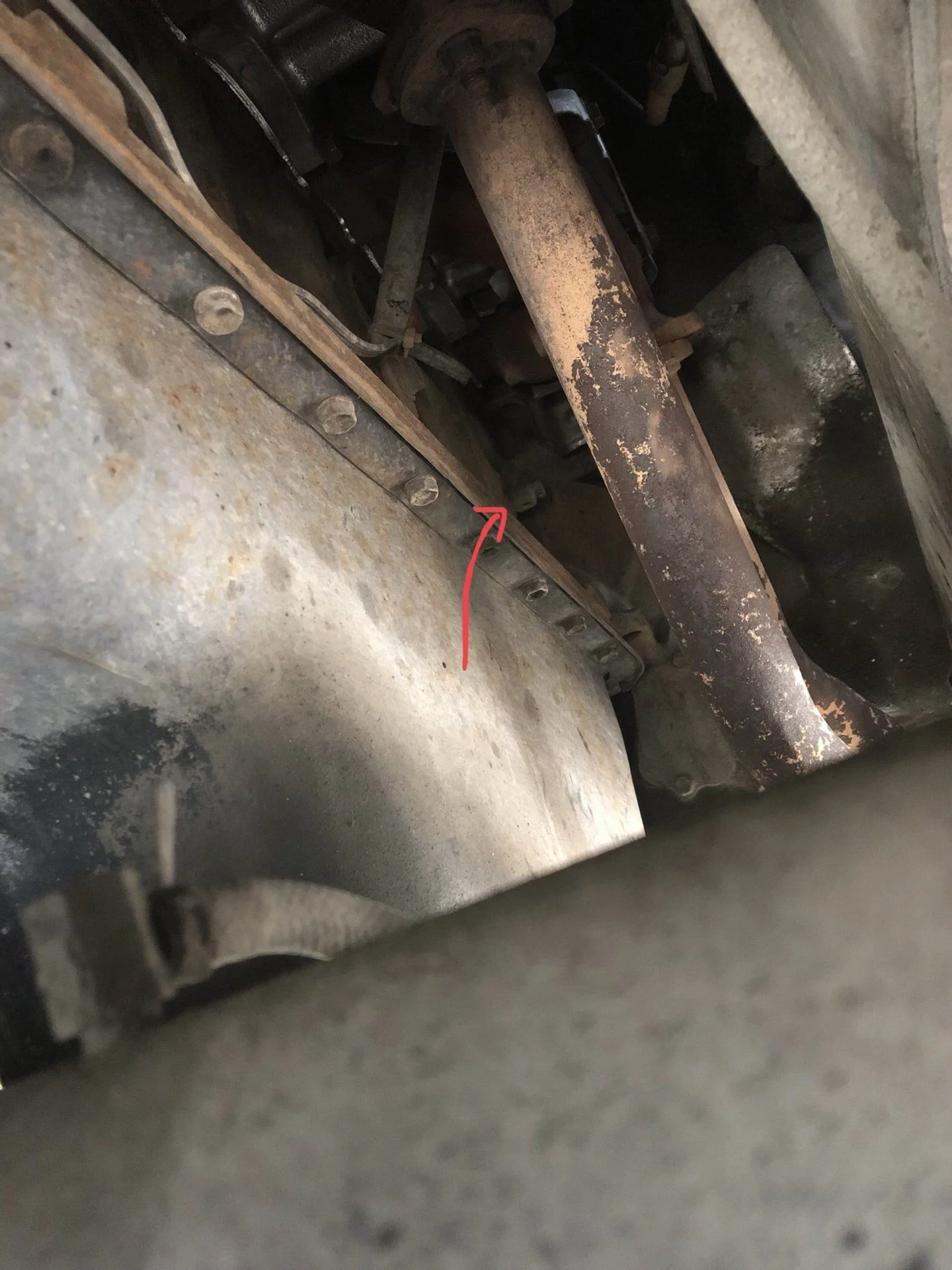

Hey all I am RIGHT in the middle of all of this but cannot find the engine coolant plug. Any help? Closest I can find searching here is "down low towards the back of the motor on the driver side," but I still cant see it. any help??
Here’s a pic, arrow pointing too it. It’s on the driver side above the back of the oil pan.
Gotcha and thank you,

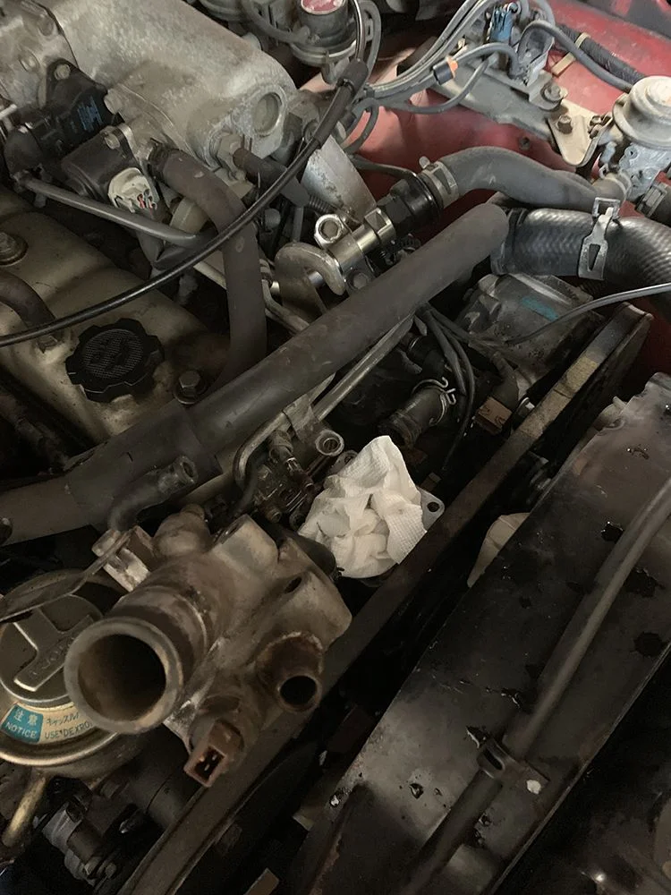

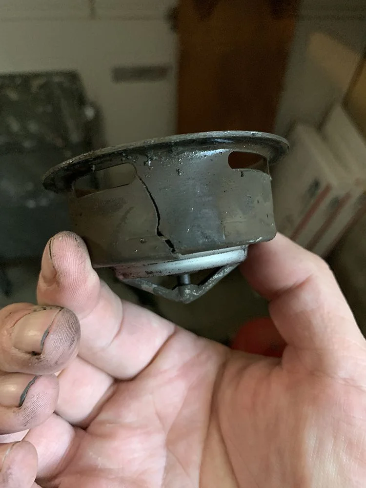

Alright, another question...

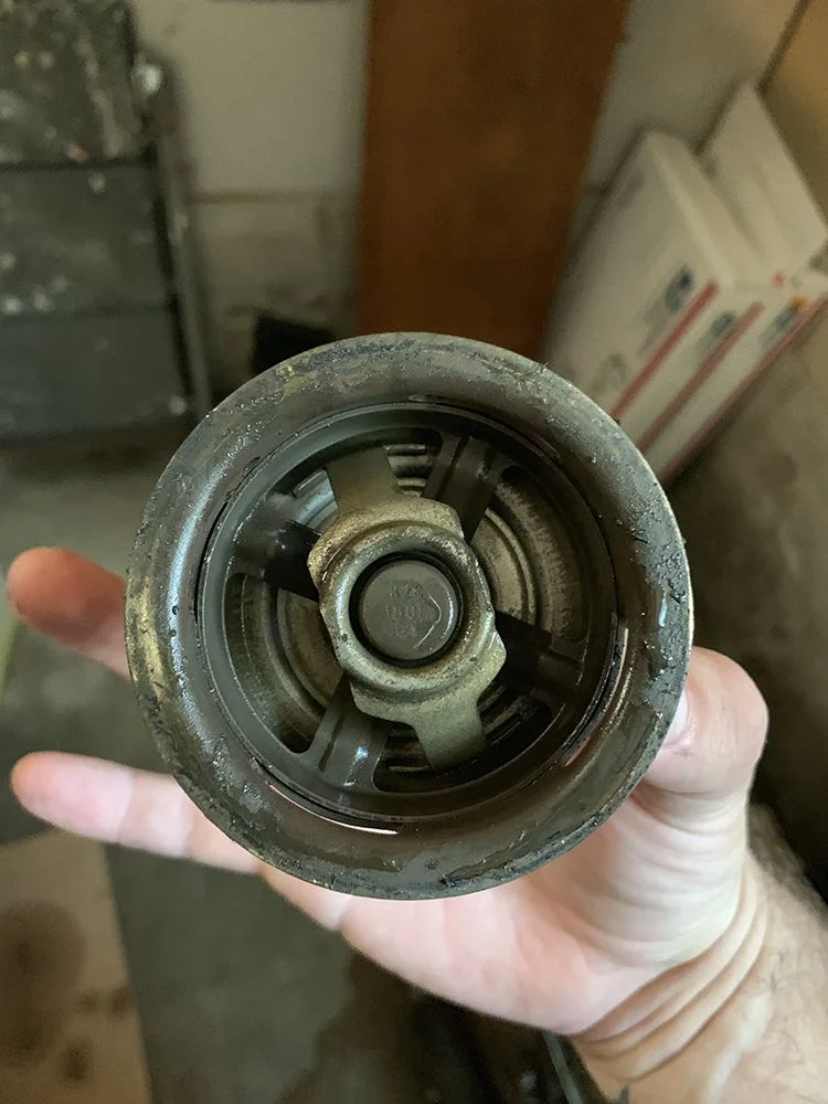

I wasn't going to replace the thermostat but decided it should come out so I can get a more complete flush.
This is what I found:
2012917
2012918
And it was missing the top gasket.

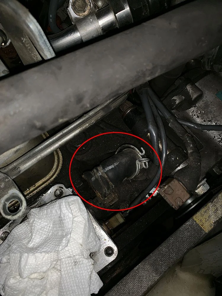

So I guess I will be replacing it... but I had a few questions:

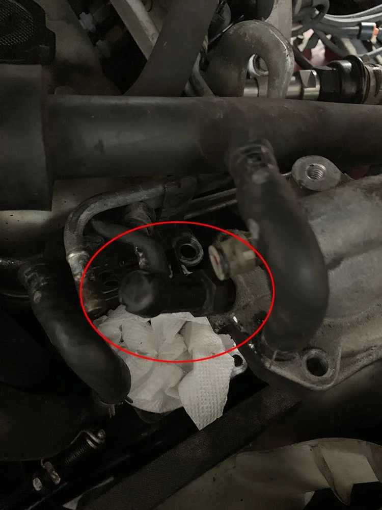

First, what does this hose go to, and is there an easier way to get to it??
2012919
Second, do I need to disconnect this? Or can I just bolt this B back down and flush the system?
2012920
Overall view:
2012921
The final question is: The other part I was considering replacing is the water pump, how can I determine if it needs it or not??
Thanks all.
-A

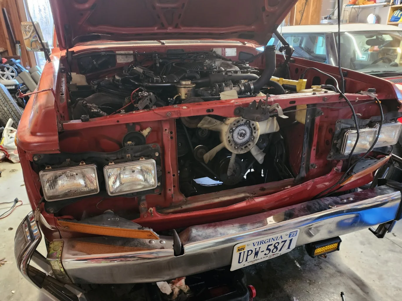

I just wanted to say thank you for this write up. It made swapping out my radiator so much easier. Put in a Mishimoto and so far, everything it awesome.

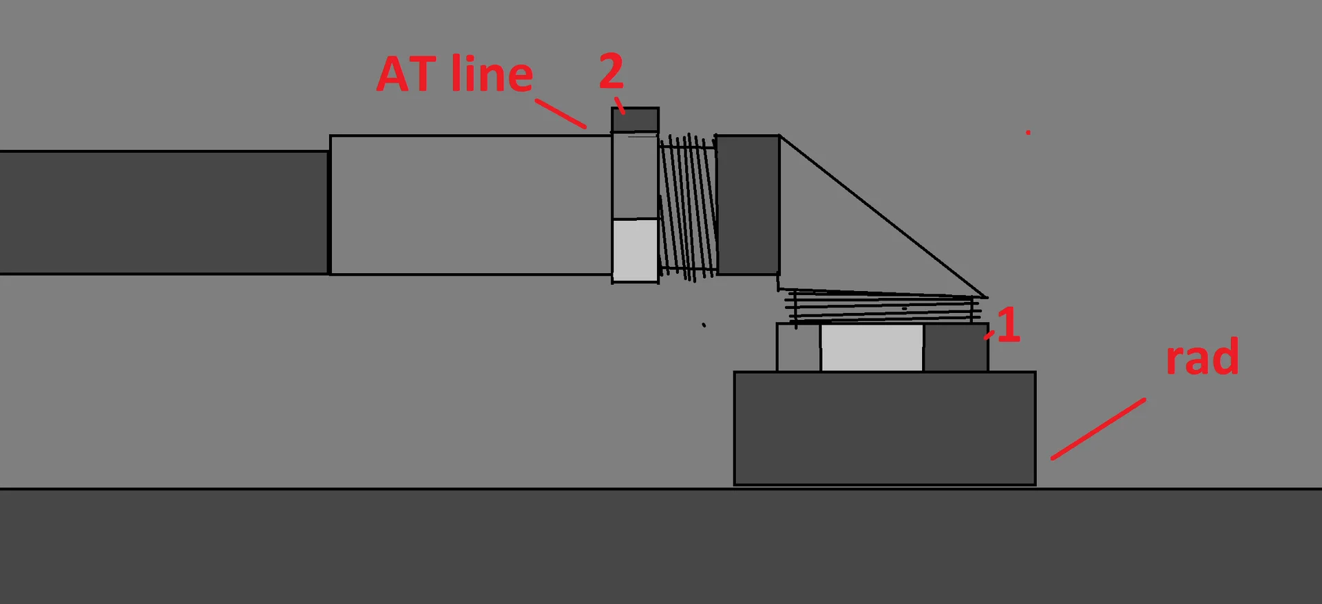

Is there a trick to getting those darn ATF lines out? Do I unscrew 1 or 2? 2 barely moved, 1 moves easily but not enough to unscrew the whole line. I had to rotate the rad to get it off.
