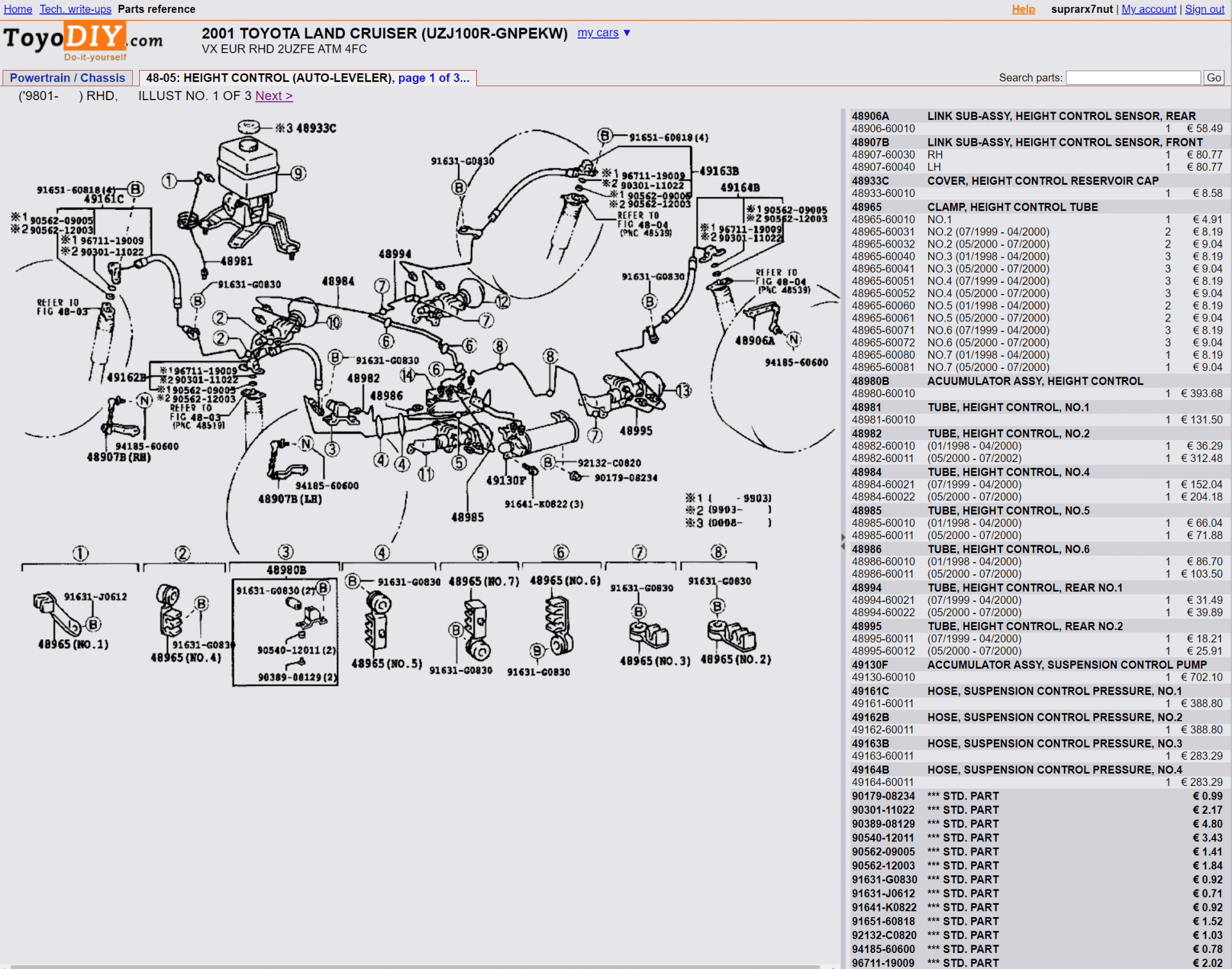

I think there are a couple different part sets pending your exact model, so this is likely wrong. However, if you happen to have a RHD VX from 2001 with the 2UZ and an automatic, here's a page of numbers that might be helpful, haha. SIgn up for Toyo DIY and go explore yourself. :)

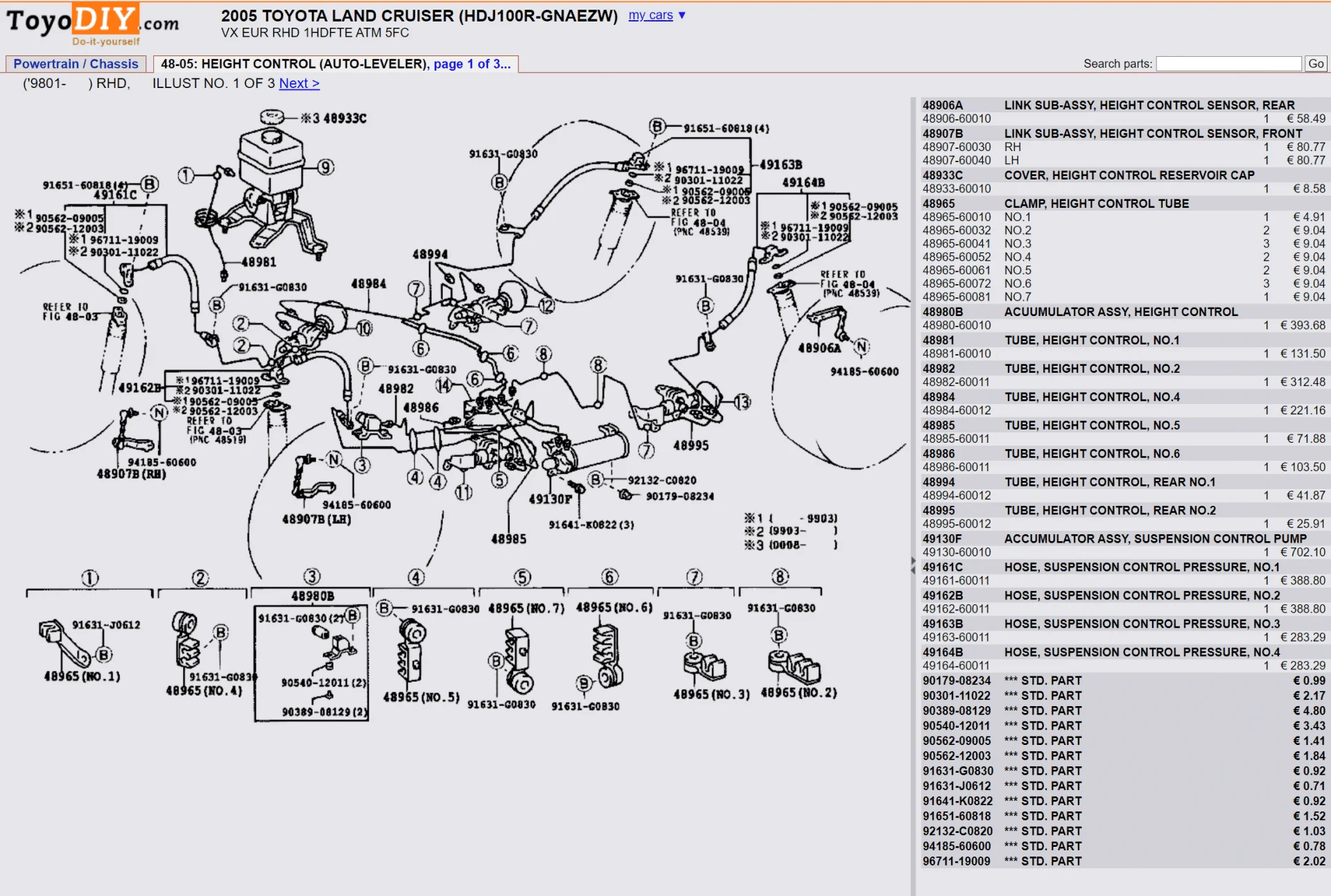

Ahh.. yes should mention that I have 2005 4.2 100 series Amazon. Many thanks fir the info. db
Guess number 2, not sure what Amazon means in the context of the codes on ToyoDIY, but here's another page.
