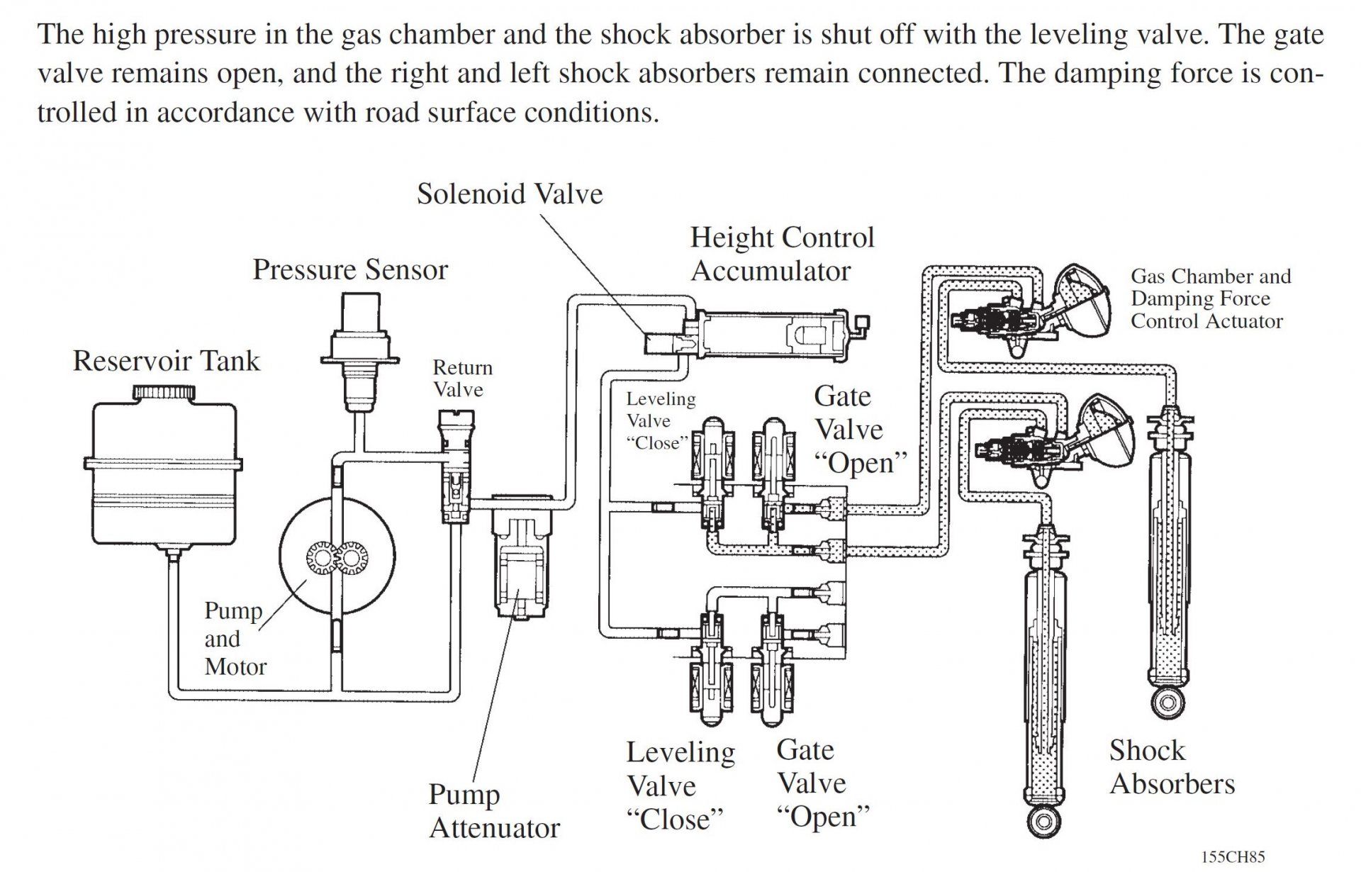

It is worth doing the 16-step test just to be sure that nothing strange is happening at each individual corner. It is also worth being confident that the Front and Rear Levelling Valves are operating properly – you can do the “Active Test” for this but good evidence also is that the vehicle ‘shuffles’ upwards normally, alternately at Front and Rear, when rising from “LO” to “N”. You can also use Techstream to watch the signals sent by the ECU to the levelling valve solenoids during the rise – watch ‘SLRL’ (for Solenoid Rear Levelling) and ‘SLFL’ (for Solenoid Front Levelling) on the Techstream read-out during the rise. This operation also can be heard/felt at the Control Valve Assembly. Checking that the Gate Valves actually are working correctly is more tricky because the ECU uses speed, steering and other inputs. Watching ‘SLRG’ and ‘SLFG’ on Techstream while someone else is driving and turning sharply at speed may give an indication.
Anyway, assume that all relevant valves are working correctly. If so, then the Gate Valves remain open when the vehicle is travelling in a straight line, OR, when the vehicle is at rest. The hydraulic connections then are as shown below, except that when the "LO" or "HI" button is pressed on the console switch, the Levelling Valves open and the vehicle falls, or rises with pump operation, as required.

AHC Circuit for Straight Line Driving or Vehicle at Rest:
Source: https://lc100e.github.io/manual/
then follow the index tabs starting right at the top:
New Car Features > CHASSIS > Suspension > Active Height Control Suspension.

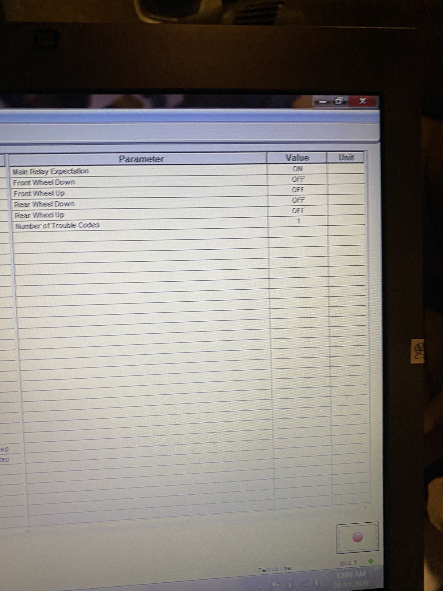

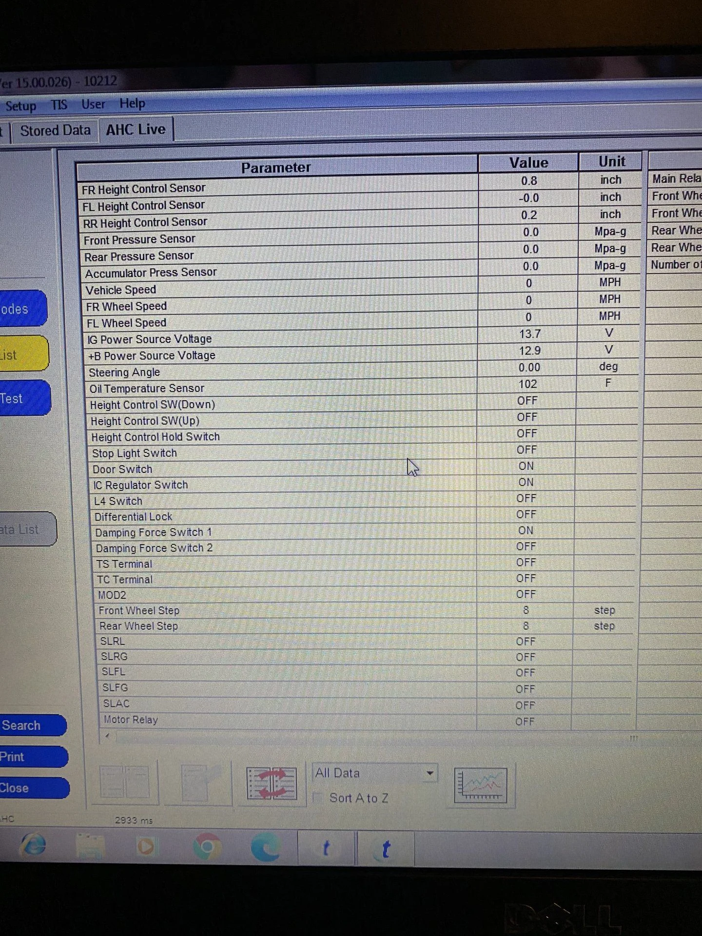

Hello All!
I’m a new to to AHC. Just installed a techstream. On my ‘03 Land Cruiser’JDM’ with a 2UZ-FE, the ride is extremely uncomfortable. The suspension is very stiff and i can feel each and everything. My car doesn’t go up to ‘hi’ mode, it blinks 2 times and stops. Hooked up techstream and the neutral pressures are stated as ‘0’ both front and rear.
Please somebody help me out what to do in this situation. The heights are almost good.
In this situation and can’t do a gradation test as it doesn’t go upto ‘hi’.
Can anyone please help me out? I’m really sick of driving it like this. Thanks
Here’s my techstream info:

Sounds like you probably have very high neutral pressures. To get pressures readings, you have to hook up your reader, then go from L to N and record the numbers. The system doesn't give "live" info.
Tried it. I'be gone from L to HI but still same result. it shows me a 0 reading. how can i adjust a TB if I even don't know what my pressures are? I'm thinking to do a complete AHC oil flush. Do you think it will help?
Something is not working with your TechStream or with the AHC. Which Trouble Code do you have? (Your TechStrem page says there is one)
Does it move from Lo to N? And still no movement in the pressure readings?
Do the height sensor numbers change when you go from Lo to N?
What about actual heights - are they at spec?
That the damping step numbers are fixed on 8 could indicate that you are in "limp mode". You could check the pressure sensor on the pump. Do you have the FSM?
Also, if the TBs have not been adjusted for a year or more, you can safely tighten them a few turns, to make it lighter for the ahc to lift.
