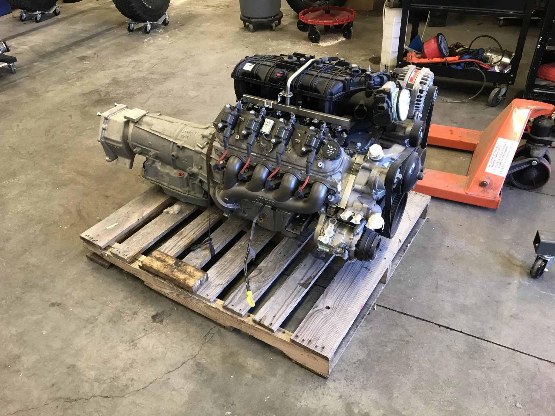

We said goodbye today to Tony’s v8/6spd combo.
We are now back to a bare rolling chassis.
