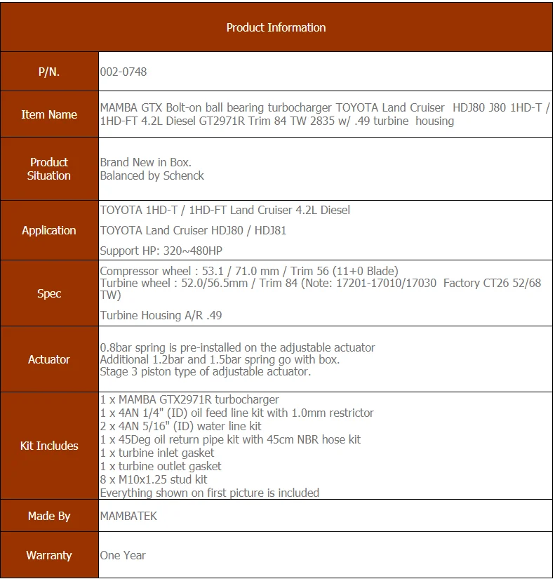

That's a very large, top end HP turbo. To get the advantage out of that you would want an upgraded injector pump, aftermarket airbox and a very large intercooler. Personally for stuff from Mamba I'd look at a TD05H 18g, it will still have good drivability with your auto but can still make very good power if you want to do all the supporting mods later on.

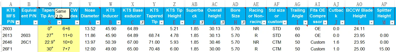

KTS also makes a 10+0 with 50/67 inducer/exducer p#2646c. this would be closer to a TD05 18G. Would require machining the compressor housing, but i will probably be doing this anyway. Also an 11+0 in the OE dimensions is shown as well. What do you think?

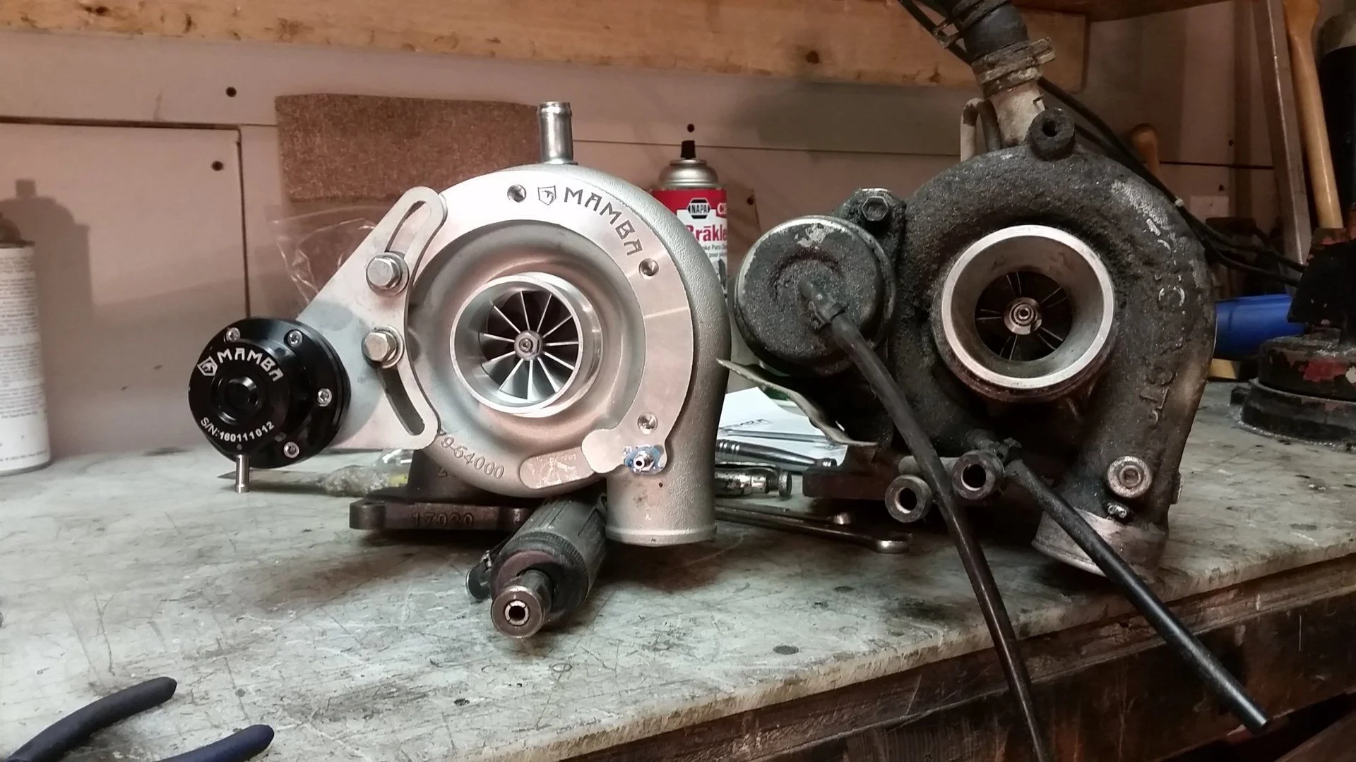

My Mamba has about 15,000km on it. I had the turbo apart to install a 12blade exhaust wheel to replace the 9 blade. Upon inspection of bushings and thrust washers things still looked new. Running 24psi at the manifold post intercooler. Mamba TD05-18g hybrid CT26. 11blade compressor extended tip
