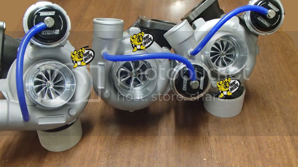

Did you opt for the option with more top end flow? Looks like you have a different wheel than I do.
No, I'm pretty sure I didn't since that's not what I was looking for. Is my mind playing tricks on me or does your compressor wheel only have 7 blades? Mine has 11 same as the photo that was posted in the group buy thread:

Yes, mine has 7 double blades. I don't know what the difference is but I believe Tom got some hybrid version which should flow more top end. Initially they sent out the email asking everyone what their goals were and I said low end because I am towing a boat. I never heard back again. When I was getting back in touch with Luke about th shipping I reiterated that I was towing and that they never responded and he said it would be fine for me. Maybe Tom can shed some light on the difference. Here is a photo from the email they sent out and it shows the two different wheels

@MonsterCruiser I think the 11 blade 71mm compressor wheel was the original version. That is the one that the supplied pictures and dynograph are of.
@vwluv10338 I did get the upgrade wheel which is the 7+7 blade 73mm. It looks like you got the same wheel. I was told it would have greater efficiency up top but should have as good or better response down low also due to the differences in design.

@vwluv10338 I got some clarification about your 7+7 wheel.
Your wheel is in fact a 7+7 blade (as is obvious looking at it) but your wheel measures at 71mm. That is, it's the same size external diameter (exducer) as the 11 blade wheels but with the design characteristics of the 7+7. Where my compressor is 73mm, for extra flow up top.
