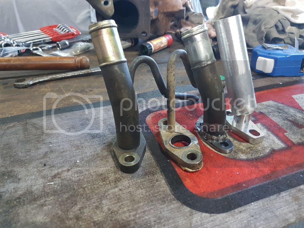

You can see a stock oil drain, then it old stock oil drain with the pipe cut off. Next is a Garret oil drain with my oil drain pipe welded on. This was our version 1 oil drain but this one leaked as the mounting flange must have been warped and the ultra blue silicon did not take up the gap for too long. This warping was ever so slight, but it did leak so we went with the supplied o-ring drain with the alloy pipe welded to it as you see on the right.
No you would be thought to be a fool and wonder shy it's on gumtree in the first place. Did someone drop $2800 on a new turbo and decide they didn't need it? It does appear however by the photos to be out of the box from Japan with grease proof paper seals over inlets etc. it would warrant some hard questions and nerves of steel. Worth investigating though.
