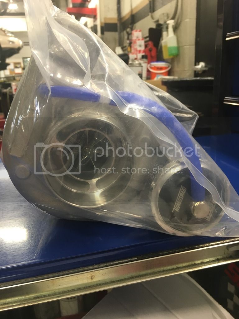

I got mine the other day too. Looking forward to getting it installed! :)
