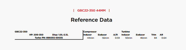

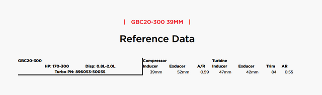

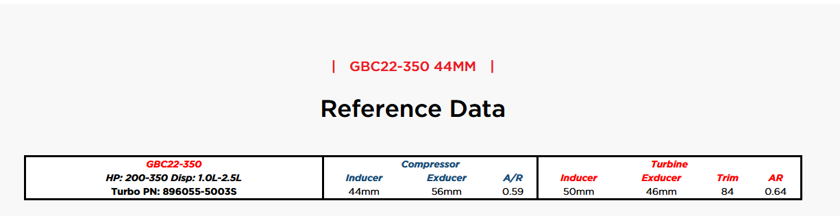

Garrett GBC20-300:
Garret GBC22-350:
Whats the thoughts here?

I think you're barking up the wrong tree.
Looking at the compressor and turbine dimensions, I think those turbos are both too small for a 4.0litre diesel.
They are designed for 2 litre petrol engine. A petrol engine had very different needs than a diesel engine in terms of turbos.
12ht which is also 4.0 litres uses a ct26 turbo. Check out the compressor and turbine dimensions for a comparison.
Search this thread for the Mellett Turbos spec sheet
It lists a lot of info for toyota turbo compressor and turbine dimensions so you have a comparison for turbo sizes used on different Toyota engines.
I think ( but there's more knowledgeable people here than me) a turbo for a 1hd-fte could be a good match for a 2H.
It'll give low end boost, and will boost way past 2500rpm.

Looks like in comparison, the GBC22-350 is a bit smaller than the CT26 on the exhaust side, although its a much newer design turbo.
