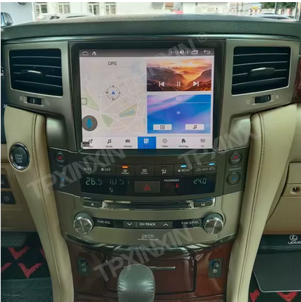

Those were my concerns as well. Was hoping to see one installed. Between the mismatch and maybe the fact that the overlay covers the screen partially? Seems like it may look too bad to be usable. My other option is to do the screen refresh on the OEM screen to at least get fix my fading display screen.
If you mean that the original frame around the display covers the edge where information is still displayed (which results in, for example, only part of the button being visible because of the frame), that might be something we could address. EXTDUDE mentioned here that they will try to play around with the display resolution settings, or they might release an update (maybe they already have). That’s a problem that can be easily solved with software.
What really bothers me is the fact that the TEYES panel color is just dark grey. Such a stupid thing. All the LX models have polished aluminum, and they make a dark grey plastic that just stands out. Maybe it can be solved with a film, but it will be a completely unnecessary hassle. See below.
@lohdaj, is the teyes panel supplied because the display needs a different bezel/trim to maintain an "inset" look, and the lower controls and the upper bezel are one piece, and so there is no choice but to replace those lower controls? I ask because I am wondering if there's a way we could mount the teyes unit in front of the facotry bezel/screen-trim, perhaps with a 3d-printed bracket/trim to make it look clean. This would allow 100% of the teyes unit be accessible, and ideally not have to replace the lower controls at all, keeping the facotry color.
Also, FYI, looks like the CC4-pro is out, and I asked teyes if LX570 is supported, and they confirmed it is. I am thinking about ordering one to experiment with the bezel idea.
Can you take pictures of the install? What year is your lx?
