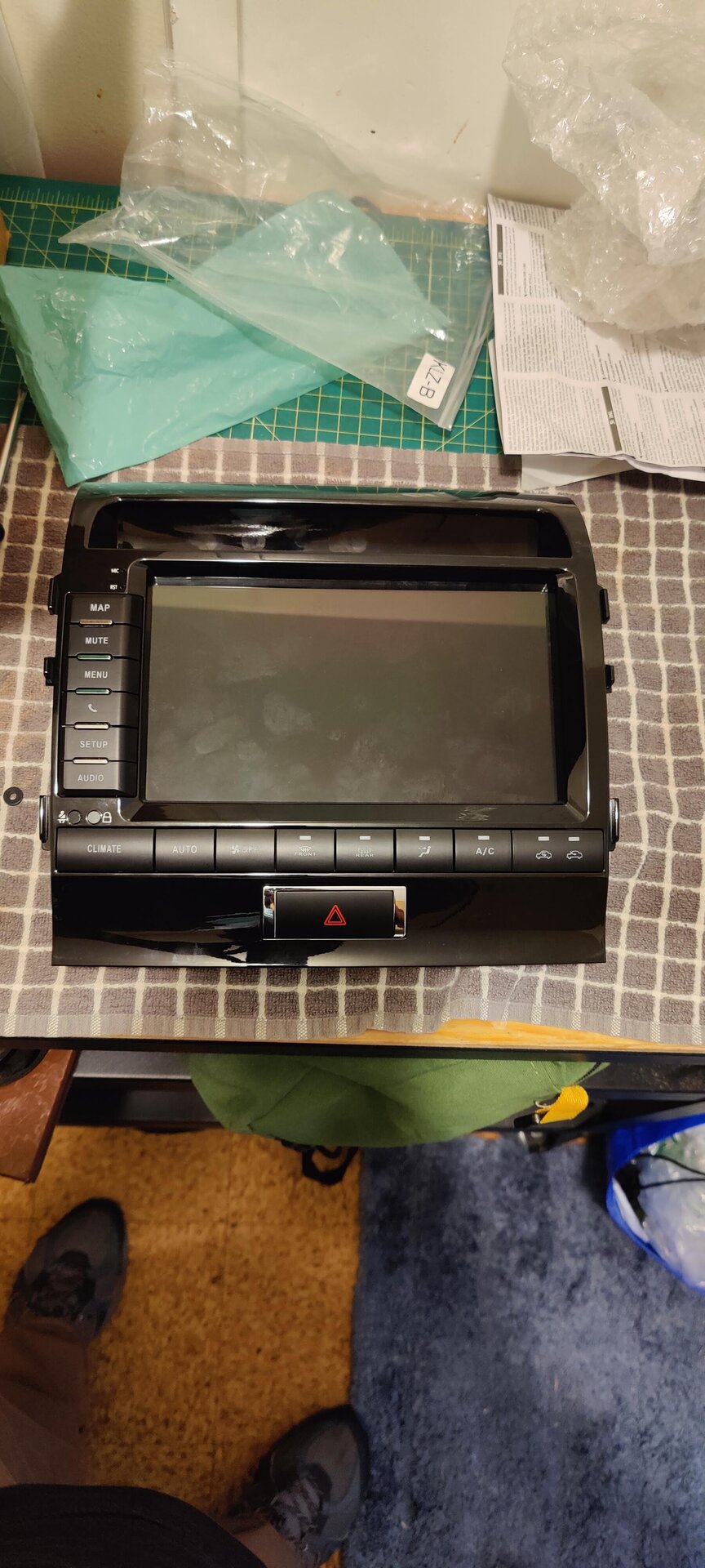

I still haven't heard back from the support. Adding some pics on assembled unit. Will add more pics of the system attached to the car.

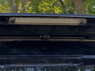

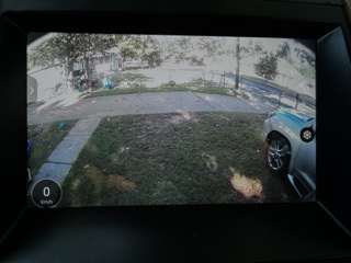

3. The final one was kind of my fault. The factory 360* camera system is not working. The reverse trigger works and puts a camera interface up on the display like it would from the factory, but there is no image from the camera system. These systems require an additional canbus module to retain the factory 360 camera functionality. I didnt verify she purchased it after she placed the order and she had forgotten to add it to the order. I ordered the part last night and it should arrive next week. TEYES For Toyota Land Cruiser Prado 150 (2009-2013) & Toyota Land Crui - https://www.teyes.com.au/products/teyes-for-toyota-land-cruiser-prado-150-2009-2013-cable-and-canbus?_pos=4&_sid=712b97929&_ss=r
Its definitely possible this may have something to do with the audio issue but we are about to be hit by Beryl so there is no telling how long I may be waiting on it.

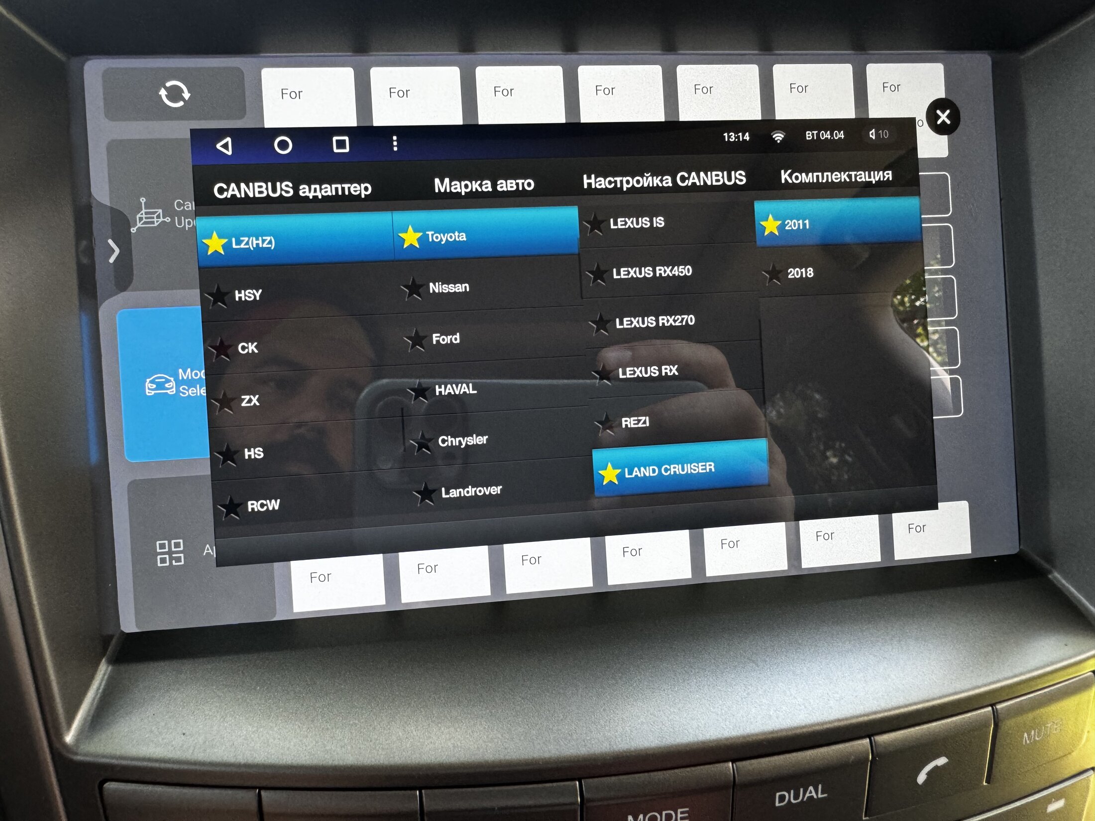

IT WORKS!
Contacted their support team on WhatsApp and spoke to an engineer.
Had to use a specific CanBus configuration
LZ (HZ)
Toyota
Lexus IS
No Air Amp
And I needed to use included RCA cables to tie into the factory CD player deck with an included pass thru harness.
AC Controls WORK
Steering wheel controls WORK
Audio WORKS!

The factory 360* Camera system requires an additional $100ish CanBus module in addition to the radio kit. Hers is ordered so I am waiting for that. They offer their own 360* camera system that is far better quality but you MUST purchase a CC3 360 model when you are purchasing the system. The normal CC3 and CC3 2K models do not support the Teyes 360* camera system.
