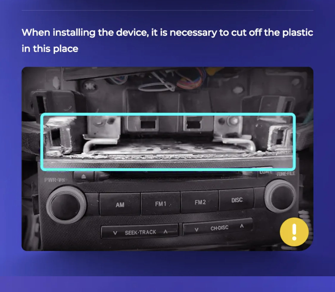

I like that it’s got an OEM style panel/physical buttons. I am just concerned about cutting into the factory brackets. Not sure if it’s reversible.

Interesting. What are you seeing that looks like you have to cut something. I have a 16” Tesla style HU and “not reversible” would be a no go for me. These things are cool but can be glitchy.

I’ve got a JDM import so it might be worth it, but yeah the cutting part is a little concerning. I tried to ask the seller about it, but..their English is pretty rubbish.
Here is the part that needs to be trimmed.

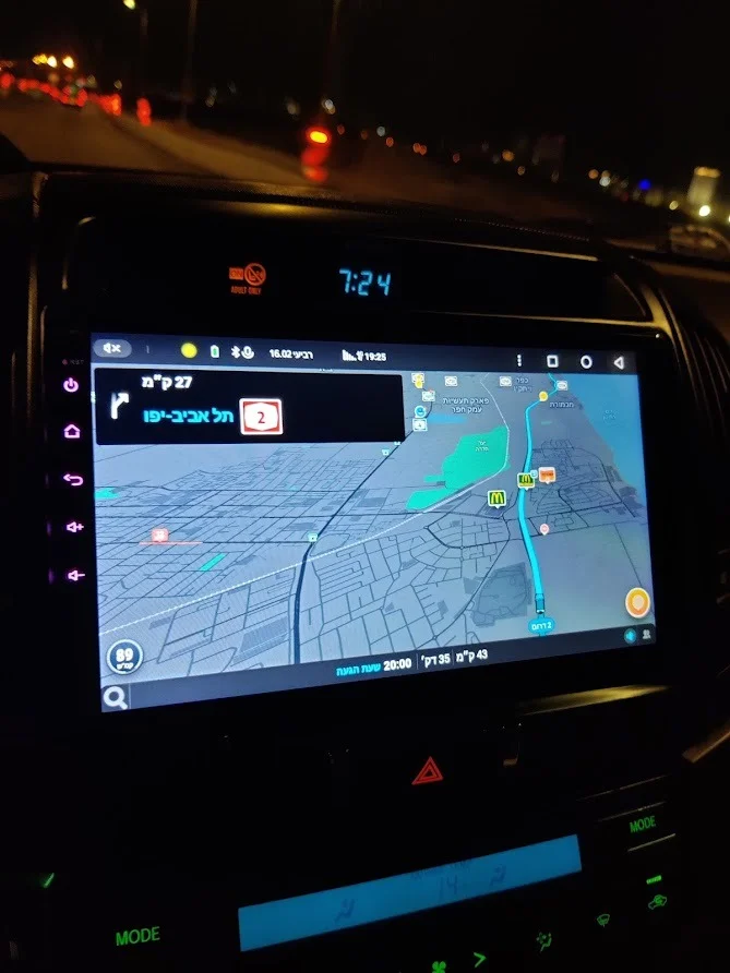

I installed the Teyes CC3 last year. The integration is awsome. Sound quality is superb. I am very happy. the new 2K CC3 should be even better.
