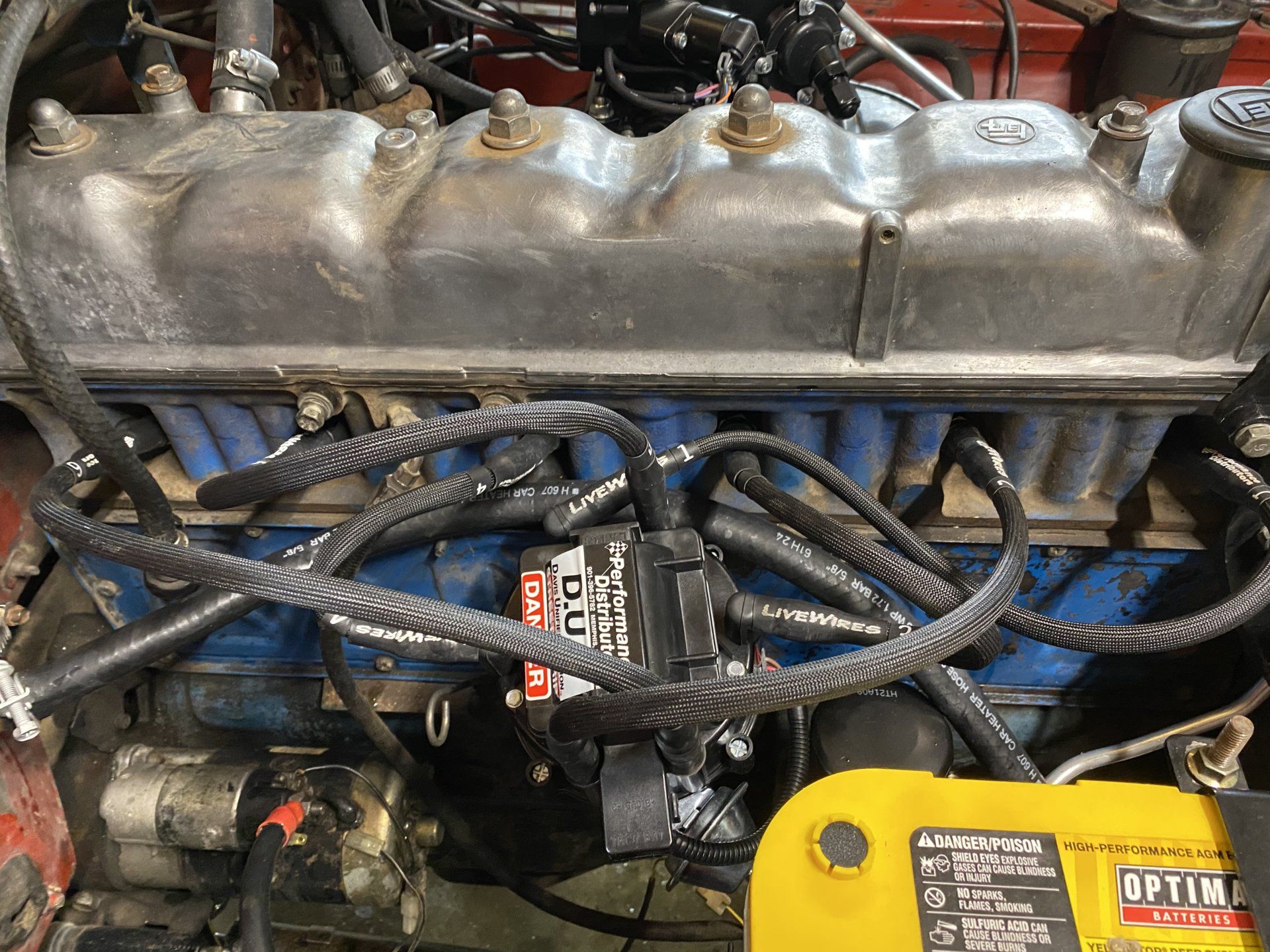

Spark is up next. I am a big fan of the DUI (real one from Davis Unified in Memphis)
These things will lie to you and not seat all the way which is a disaster. So. I add a dab of Indian Head between the gasket and the dissy shoulder. This keeps it in place and makes sure I see it smash when the dissy properly stabs.
I line it up top dead center. On the intake stroke. Turn flywheel until you see the line or the BB and make sure your #1 piston is up (pull #1 plug use a light or a screwdriver)

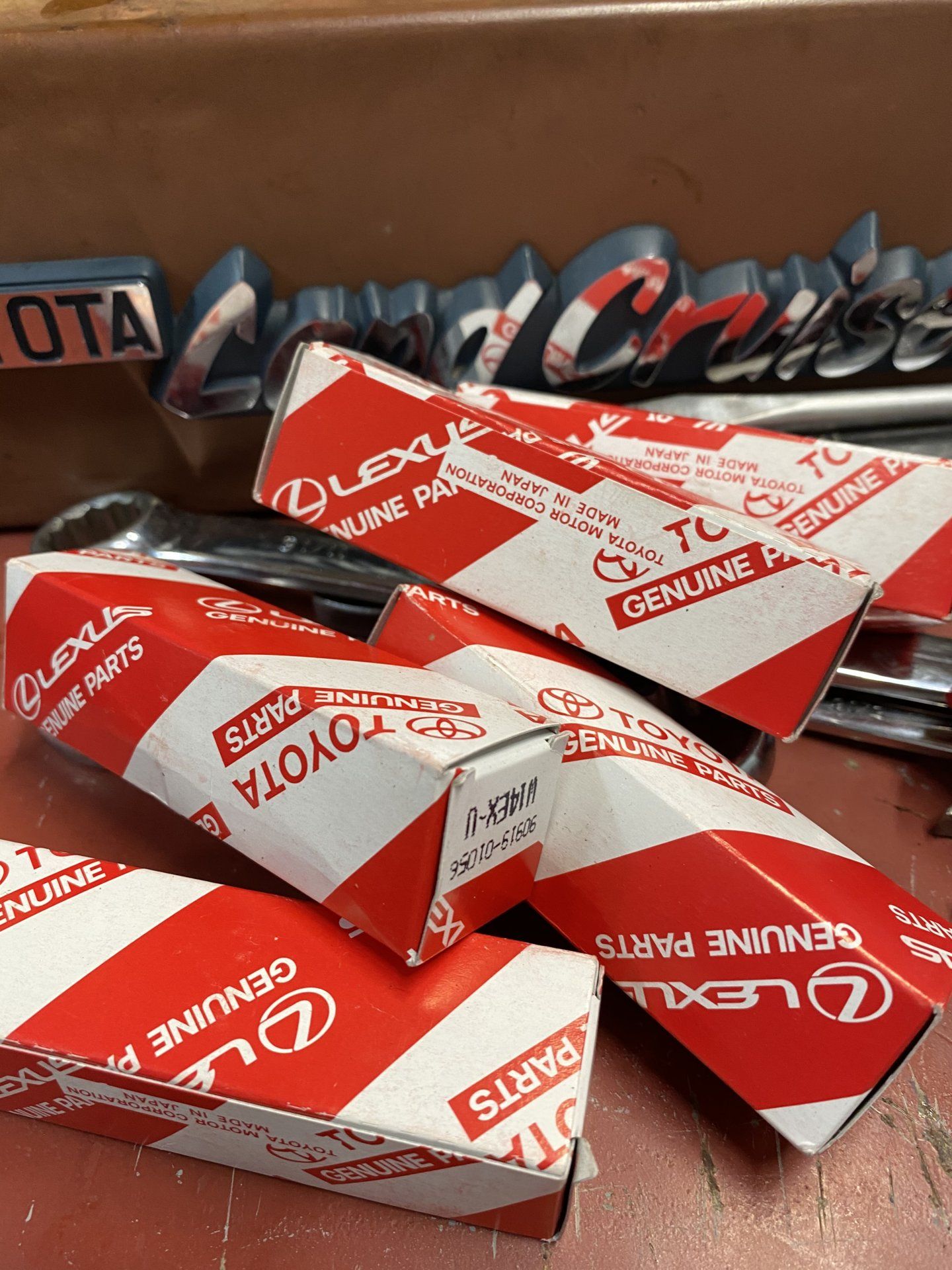

I always start with new plugs gapped a little hotter than stock at .040
I also use the live wires. Clean clean.

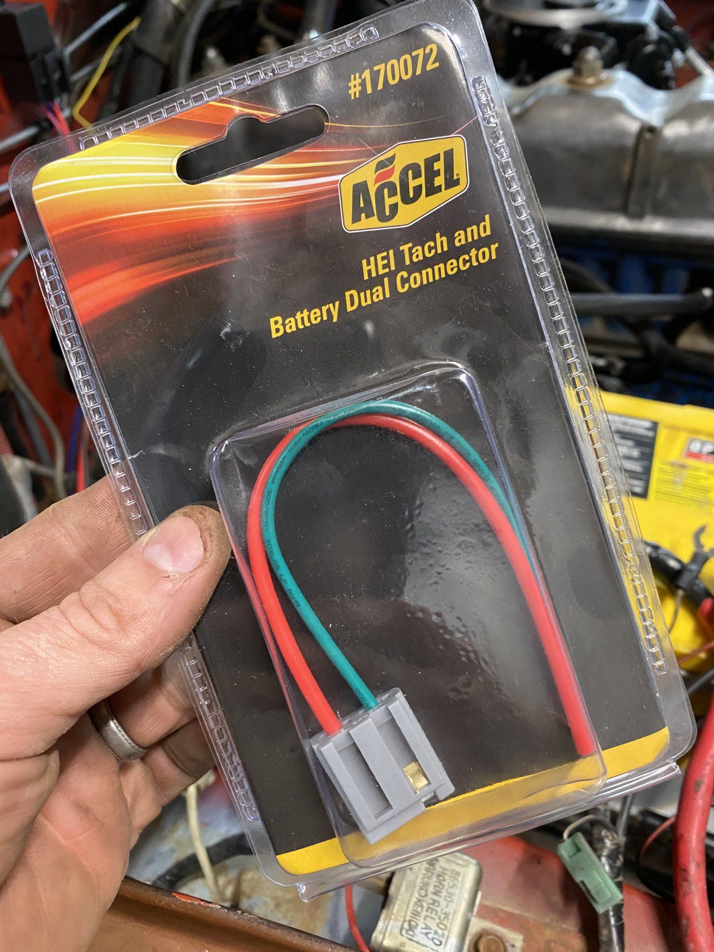

I use the coil switch 12v. Large black with yellow on most Cruisers.

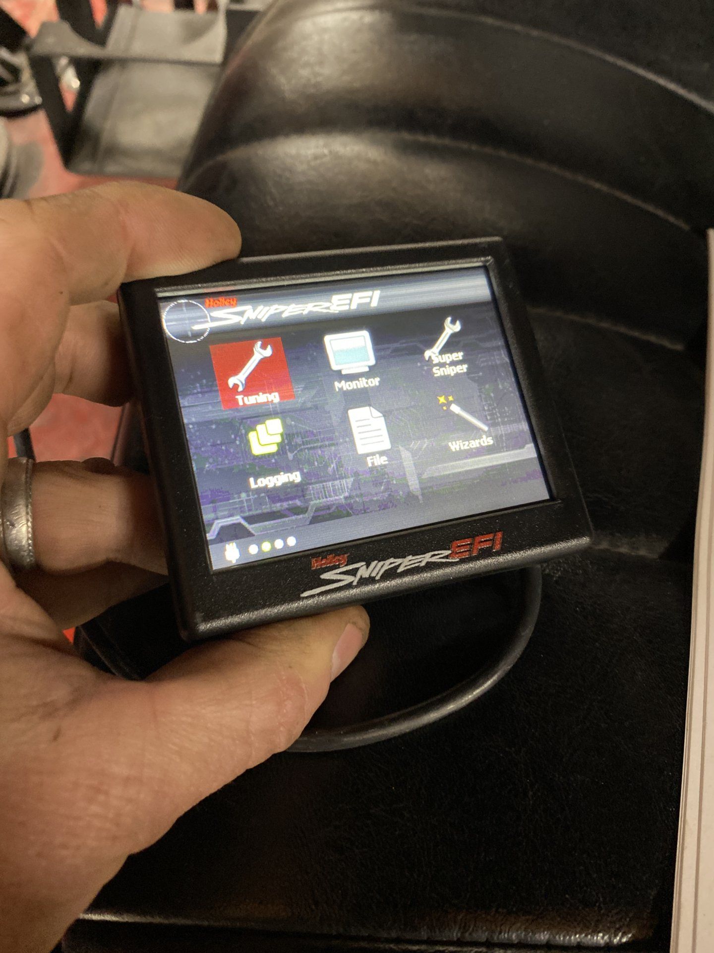

Follow the directions. Program your sniper for your truck.

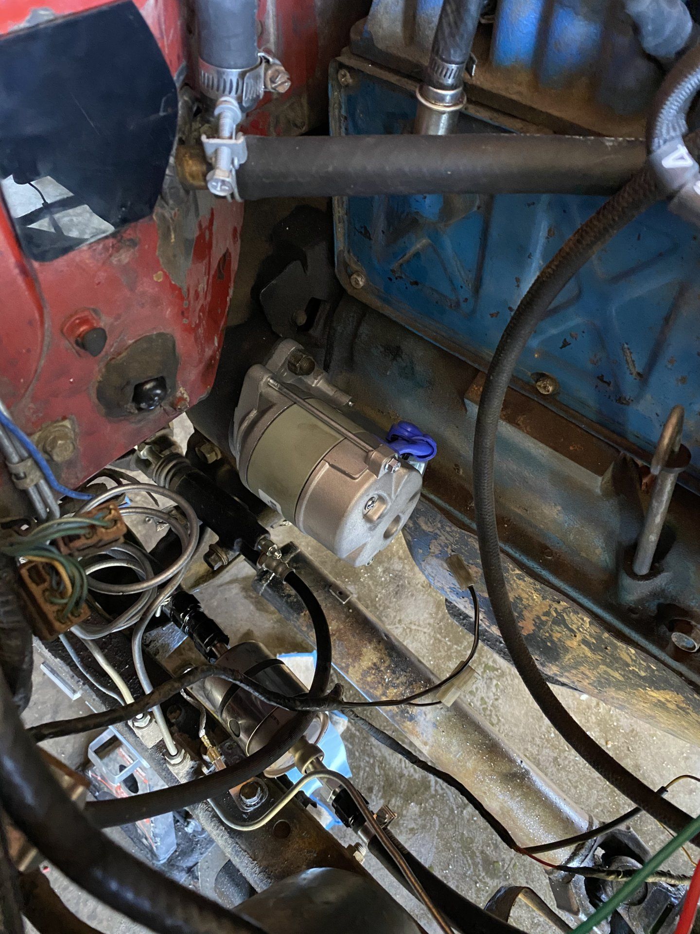

I decided to change out the starter with a gear reduction that Drew wanted. I like these way better.
When I pulled the hot wire off the starter I hit the long brake line for the front brakes and it arched a hole in it right into the curly q section
Unreal. That’s a first.
Then the 22” HD cable would not reach the new post.
@Fourrunner has been summoned for a new cable. And @Cruiser Corps for a new brake line.

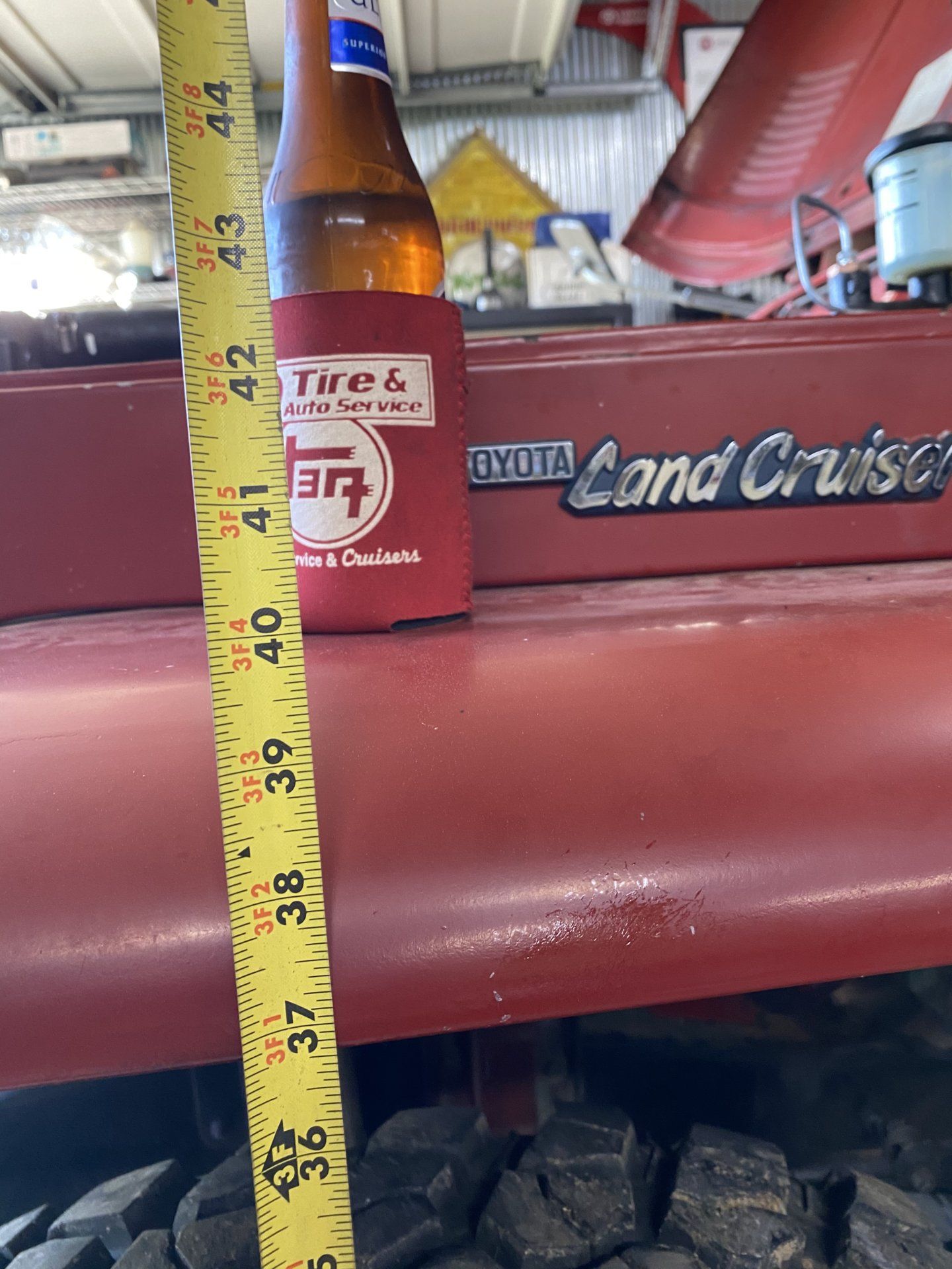

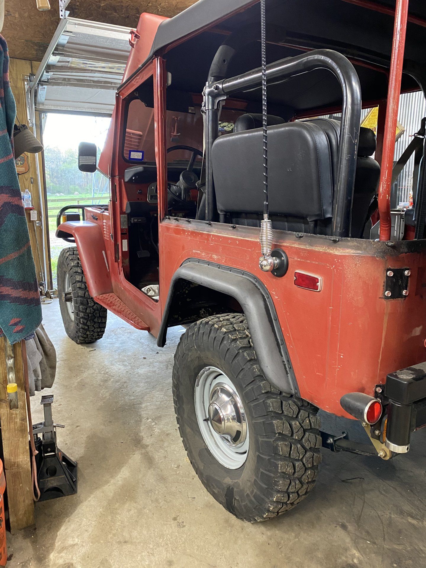

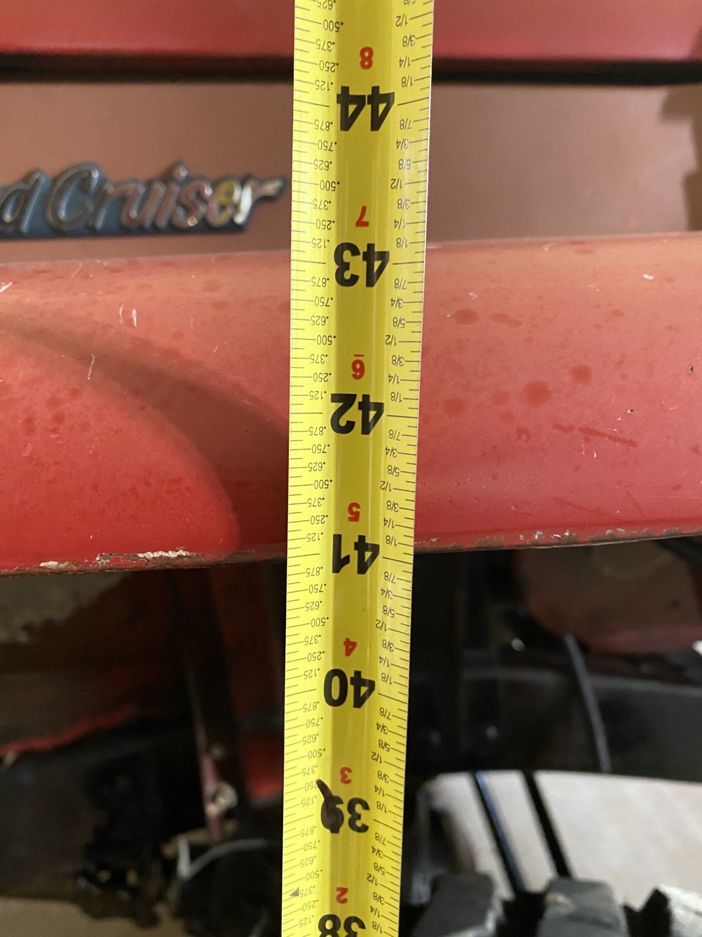

And I’m back at it. Texas Red 1 is no longer a California pre-runner. Front is down a whopping 4” from before.
Before
After. It’s sitting with a nice 1” rake from the rear now. Tomorrow I’ll get the mechanicals finished up hopefully and get some better photos
These aluminum shims suck. This truck has very few miles in the lift and they were already pancaked out. Steel from Valley Hybrids or don’t use them at all.

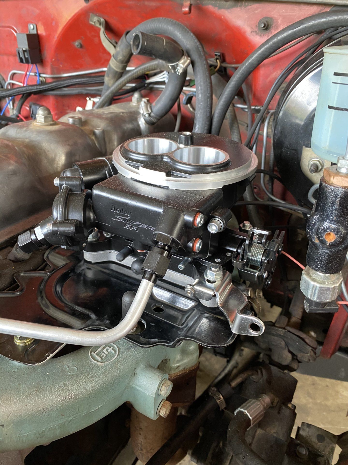

OK. For those of you reading this for the Sniper Install.....I got it sorted out this morning.
First thing was adding the 25” battery cable from @Fourrunner to reach the gear reduction starter. While I was on the positive terminal I redid some crappy terminal ends.

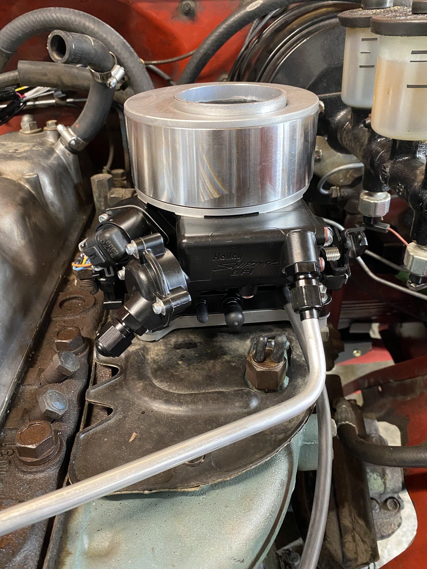

Because I was out of plugs, I had to drill a hole in the pretty new 60 series isolator to reuse a tube with a cap
Turns out, the adapter had slight clearance issues with the 1977 carb isolator so if you use the Mosley milled adapter then do yourself a favor and buy a new 60 isolator.
The isolator comes with a vacuum port in the base. It’s held in with some white brittle putty that screams potential vacuum leak. I trim it off so it won’t interfere with the throttle cable, cap it with a quality vacuum cap and RTV around it
No gaskets needed with a new isolator base. I did add a tiny layer of Indian Head to each side and to the threads of the screws going into the valve cover side of the adapter. Make sure the 3 posts are in the adapter before you bolt it all down to the intake
I install the sniper to the adapter using the supplied gasket dry on both sides.

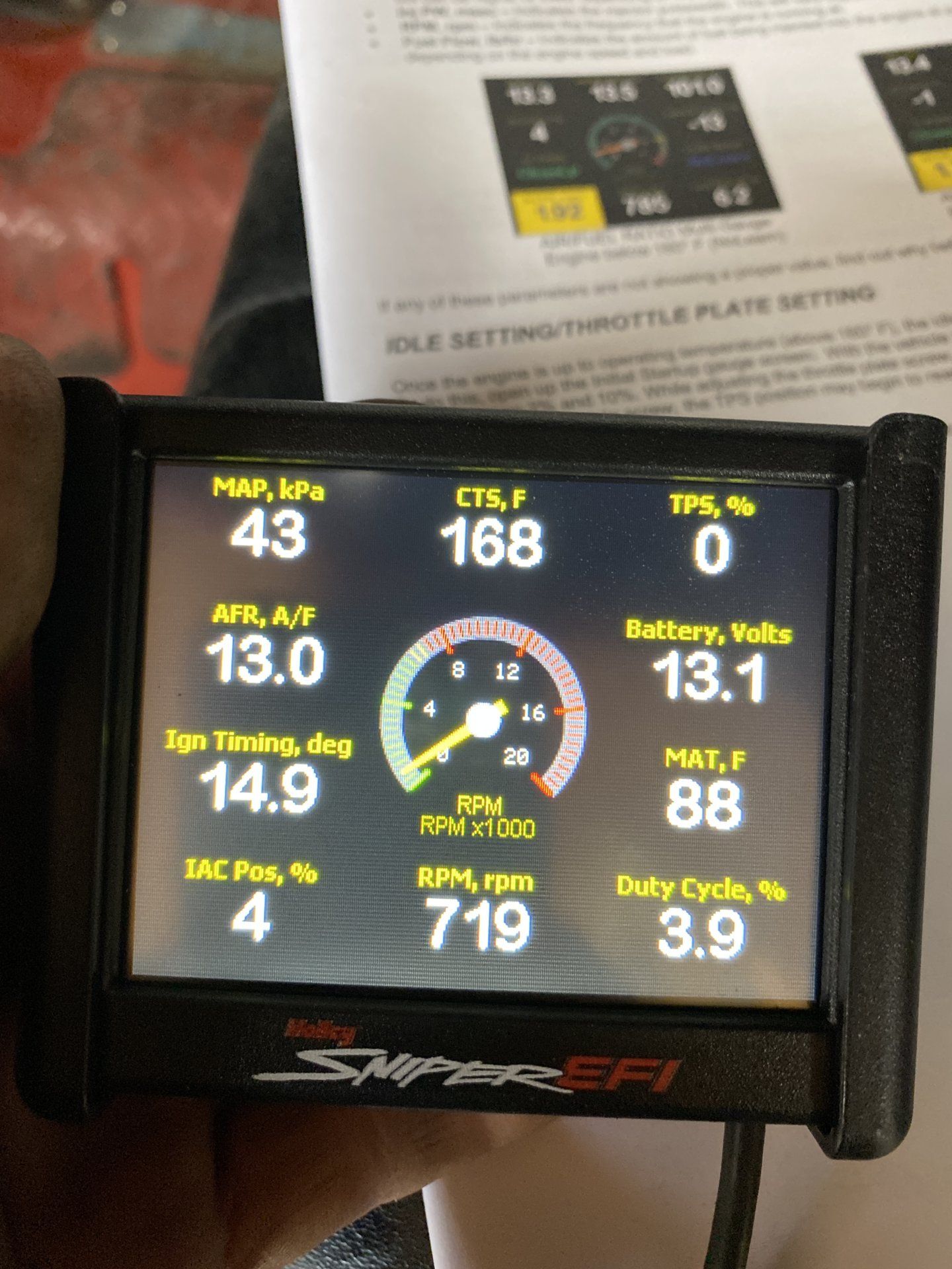

Because I had the IAC out of whack due to the past vacuum leak, I could not “find” the recommended 2-8 while at 700 RPM
I used a method @GA Architect had sent me a link to
Basically all you do is put a piece of tape over the IAC hole where I am pointing.
Use the IAC screw to adjust the idle 50 RPM UNDER target idle. In my case 650 RPM ensuring the truck temp is at least 160 degrees.
Turn off the truck. Remove tape.
IAC in the correct range and the Sniper worked its way to my target idle of 700.
I also like to put the air cleaner on before I do the final adjustments. Like I said, this reading is a bit high on RPM but it took itself there. You DONT use the IAC screw for idle.
Cam supplies a bent rod to mount the air cleaner using the supplied 1/4” wing nut. I trimmed 1/2” off the Sniper side to get a good snug fit all around. I also had to make a bracket for the air cleaner on the front to mount to the valve cover. It’s best to have a nice secure foundation to make sure all the seals work
