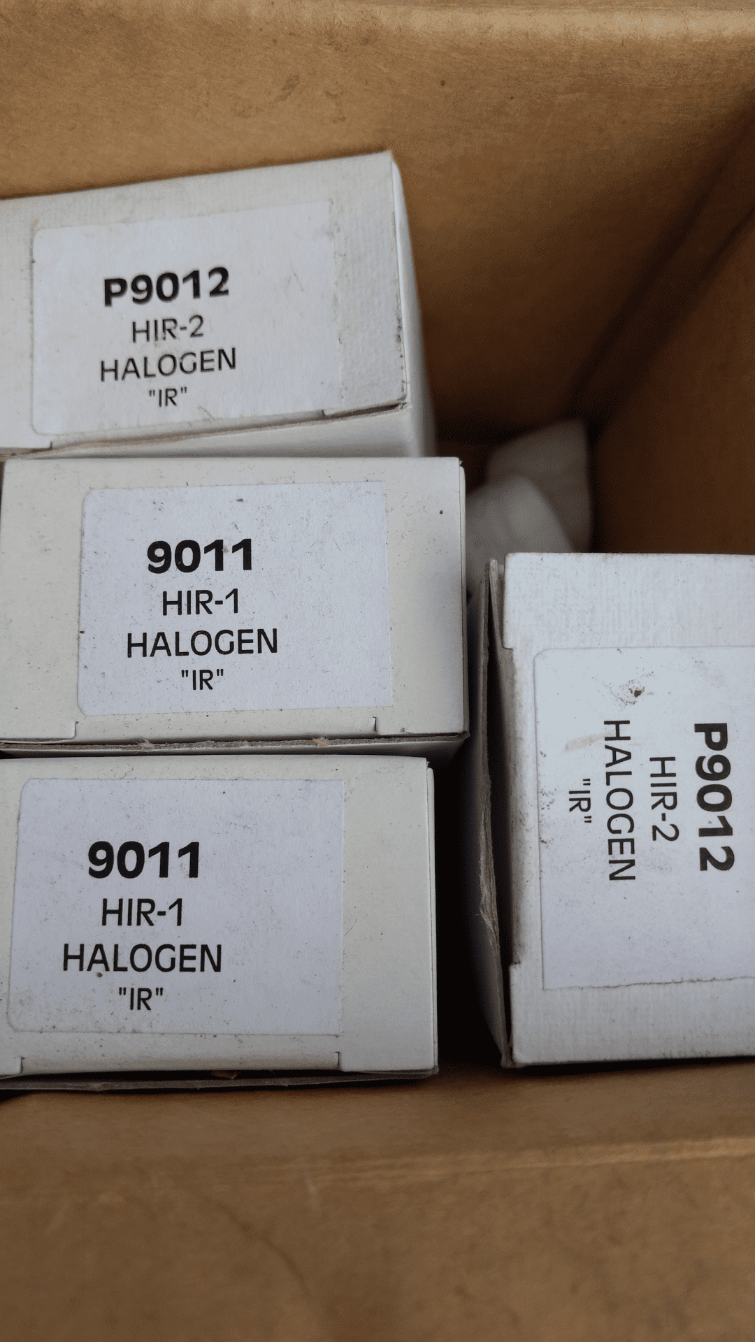

I went with new headlights for my FZJ80, so I have a set of new, upgraded bulbs that I don't need anymore for sale. These are the highly regarded Toshiba 9011/ Philips 3rd Gen P9012 Hi/Lo beam combo from Candlepower. I paid $120 for the 4 bulbs, but all 4 can be yours for $60, shipped. PM me. Slight modification to base of bulb needed for installation. Testing HIR lamps - What I found
If you care to split them up Ill take the Toshiba 9011 today:)or tomorrow:D
