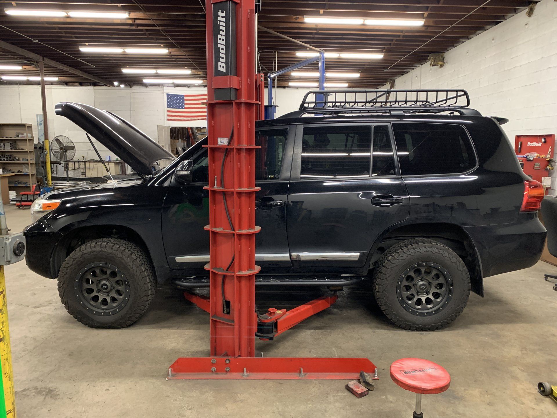

I did this 200 yesterday (parts were used, so I would of recommended a 2721 rear spring instead). It has BP-51s set to 1mm preload, 2722s, and factory front UCAs. The front is exactly 24mm lower than the front, and left to right balance is within 1mm.
If this customer wouldn’t not have had a little off road trailer, I would of set preload a tad higher. But never mind that. For the ride, it is very smooth, not rough or jarring at all, and for the increased height, corners slightly worse than the factory height. It has slightly less “Cadillac float” than factory, but it looks balanced front to rear and like a “stink bug.” So if I put on a softer spring in the rear, and lifted the front higher like the Bilstein picture in the beginning of this thread, I just don’t see how that would feel better. I feel the Bilstein would feel more unstable and less planted.

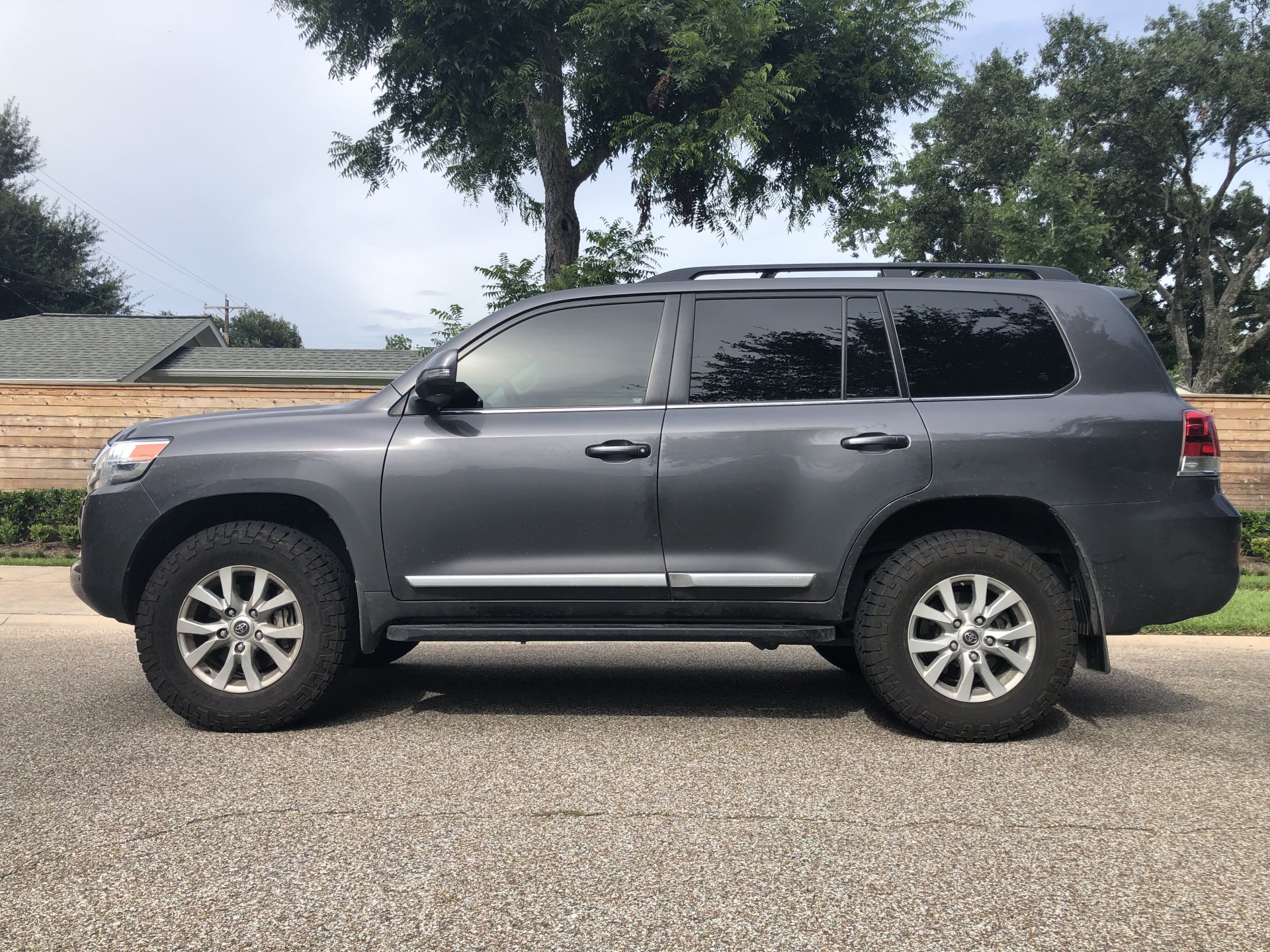

6112 fronts and 5160+OME 2720 rear springs here and love the setup. I can't speak to the Bilstein rear springs but the stock springs were very soft and, while "comfortable", would sag under any load, even a single 200lb adult in the rear seat. The 2720's are noticeably more stiff and seem to have added back a bit of height, but I did not measure before and after. I would say that with the stock rear springs the truck was level to maybe a slight sag in the rear and the 2720s have brought the rear up enough to have an ever so slight rake. I haven't had much in the way of a load in the rear of the truck, yet, but I anticipate it will sag much less, if at all, and will feel more controlled.

Yes, my fronts are at the lowest setting. I don't have any good pics but I can try to get something tonight, if you'd like.
Pic, lowest perch and OME 2720
