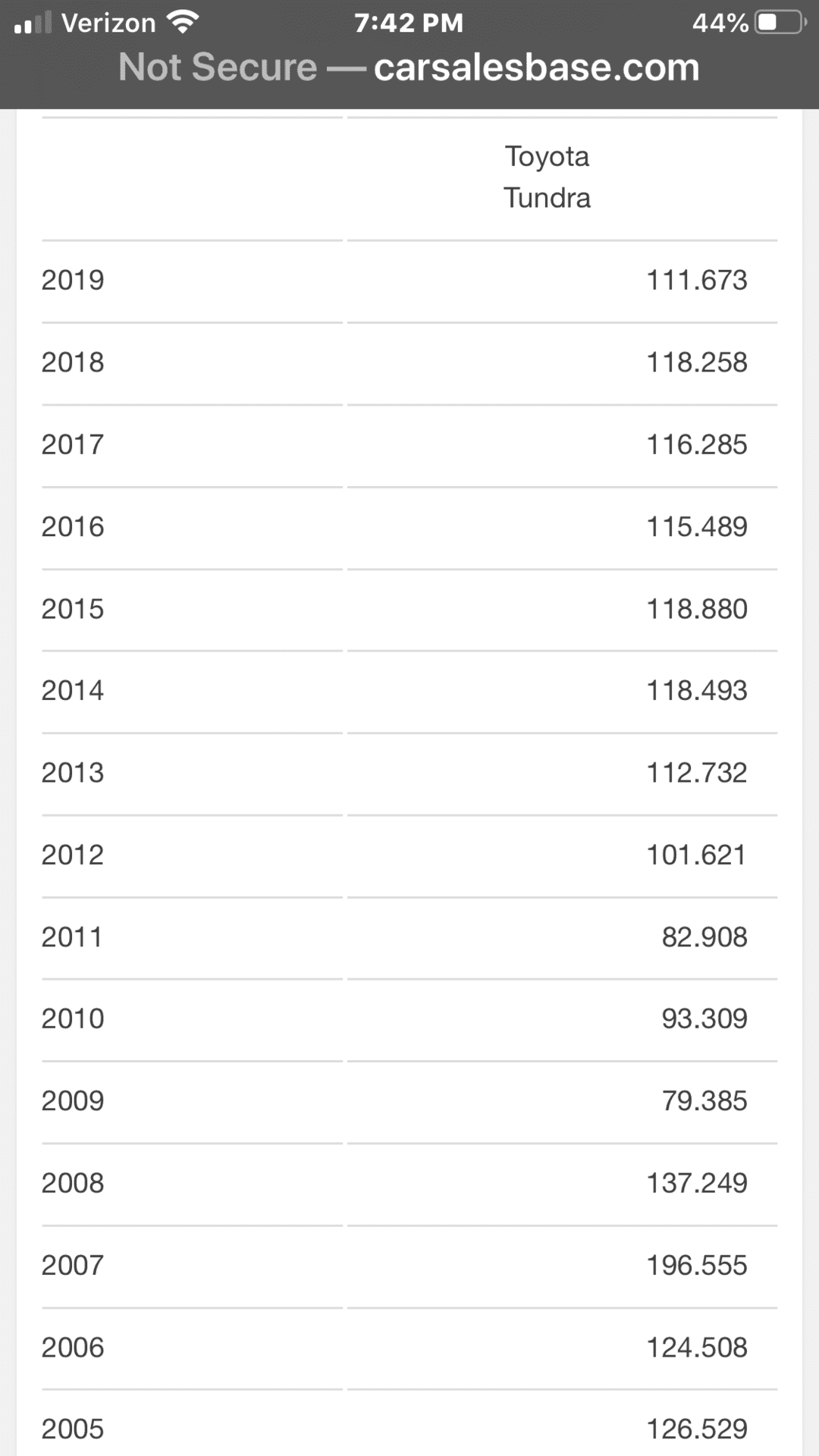

I won’t pretend to know how much they spend developing these things but considering there is a tundra application it should be quite simple to adjust the valving and spring rates and put a kit out. They’d sell a bunch right off the bat just from people that have had great experiences with other bilstein products. Like me. Plus the huge number of people considering used 200s for builds now with the overlanding craze taking off like it is.

But let’s be real... they’re following the money. We’re the 1%. If it was my business I would do the same...

Tundra stuff is already developed, so that shouldn't be taking away from time developing the 200 application.
The Tundra fronts physically bolt in. Would simply involve a valving and spring change, no new CNC other than maybe different reservoir brackets.
The rears would (could?) be moderately more complicated with different ends on the shocks, and again different valving. I guess it's possible different stroke length too. But the vast majority of the work is done.
I get that they are putting the money where it is a good investment, but this seems very simple to wrap up and release, and they'd probably get a fair number of sales right away.
