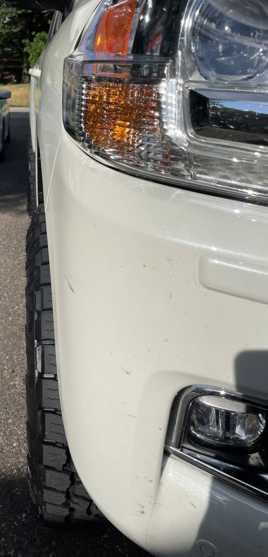

You know. That was the plan and kind of worked, but it ended up tweaking the top hat alignment with the coils and the shock body was rubbing the coil on the mid section. I ended Up pulling it out anyways to fix / do it over again. after the fact a day later 🤦🏽‍♂️ .

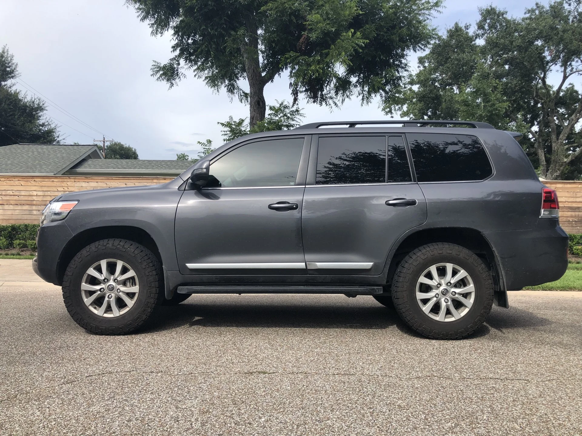

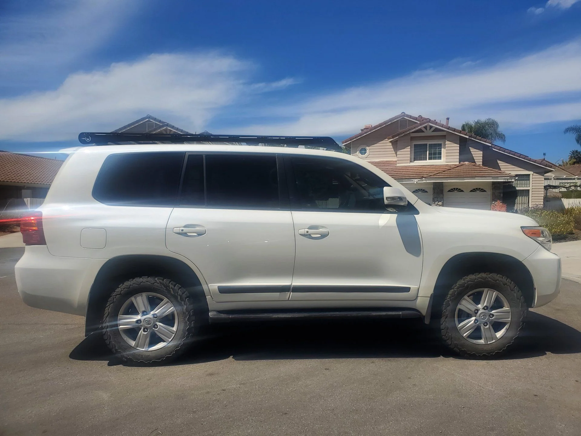

I just got my Bilstein setup installed as I noted a few weeks ago. (Stock 2013, Front Bilstein/SPC UCA, Rear Bilstein Shocks/OME 2721 Coils). I only rode it on the freeway so far and the car behaves great, much more control and not too harsh. I am at ~22" in the front and ~22.25" in rear (full tank and rear seats installed). I pretty much wanted a leveled look and went to 5th perch. Before the install I was at ~19.25 front and ~20.5" rear. I was thinking I should have gained more in the rear but it turned out even better. I will do some off-roading next week (MOAB) so things will settle and I will report how things behaved off-road. Sorry for the crappy pics....

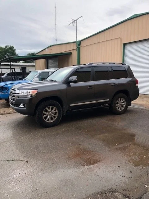

I think I forgot to post the pic here but recently swapped the stock rear springs for OME 2720. Fronts are on the lowest perch. (sorry for the bad pic. I'll take a better pic of anyone wants to see it)
