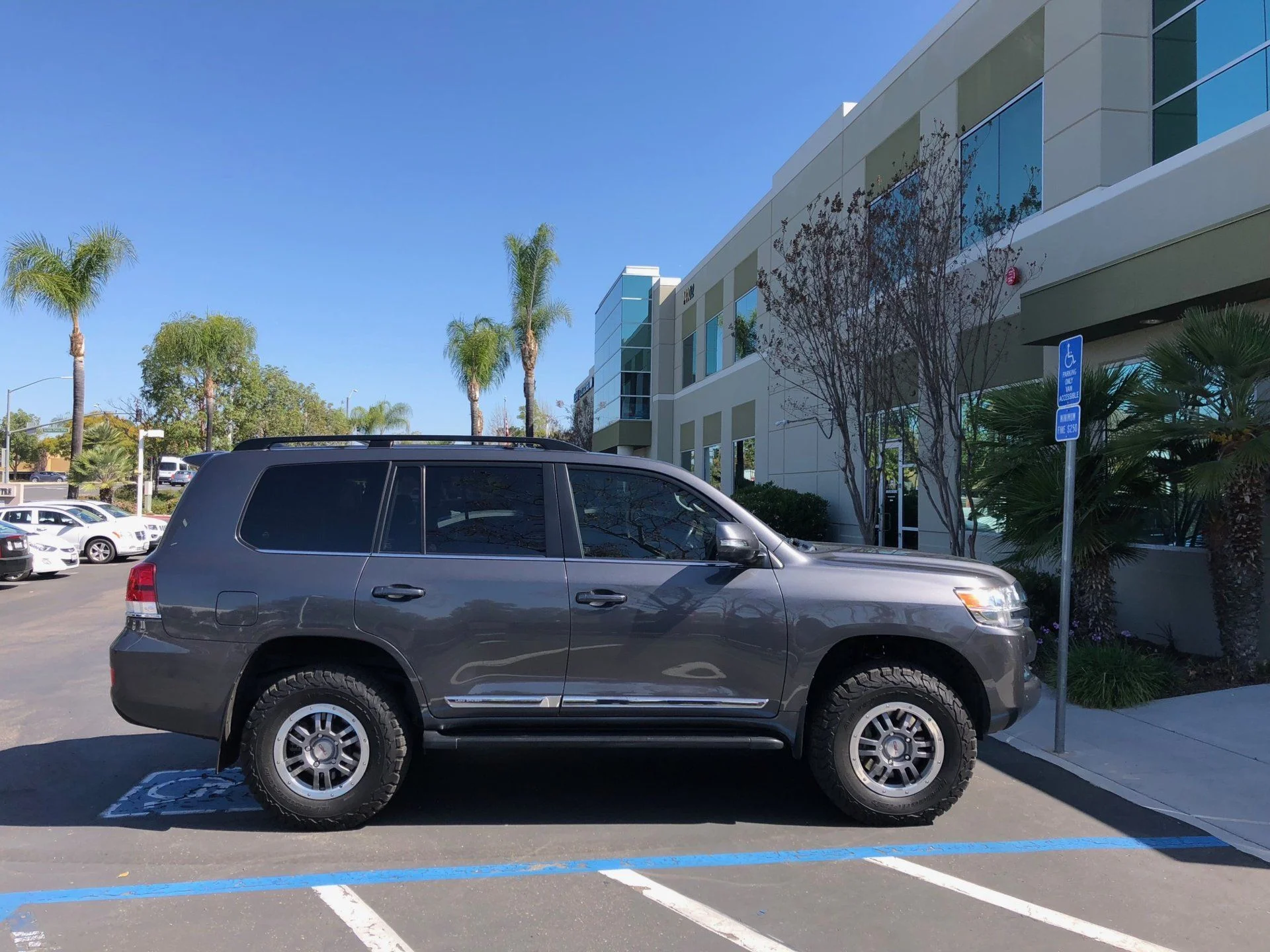

Just received our 200 back today from Bilstein. They used it as a test rig for a stock cruiser for the 6112's front and 5160's on the rear for the last 2 weeks and they were happy with the results. After talking to the tech they are now moving on to a modified 200 to test the same setup with no official release date to report as there are many variables from final testing to engineering, marketing and production. Not that they would release information anyway, but it seems if they're testing trucks they must be close.
Until the 6112's are finished they gave me a set of 4600 shocks to use until the release. These are their OEM replacement shocks as many of you know and I can't give a fair assessment of the ride quality after 40 miles but they are certainly less of the marshmallow ride I had endured on the original equipment setup. The tech did ask me if I wanted it leveled out when they were installed and today when I picked it up confirmed that the adjustment was due to a different type or circlips the German market gets which were put on my truck.
I'm not a suspension guru and am much more familiar with the leaf spring setups on my solid axle 40 series rigs so any questions could probably be answered by more knowledgeable folks here like @Markuson, @Mogwai and others.
I do not know what suspension was installed on the rig when Mogwai posted his pic but I have included a pic with the 4600's with the front leveled out by Bilstein. It definitely has a lifted look but it may just be that the front is leveled out. I did not take measurements.
Thanks to Mogwai for helping to get this testing rolling!
