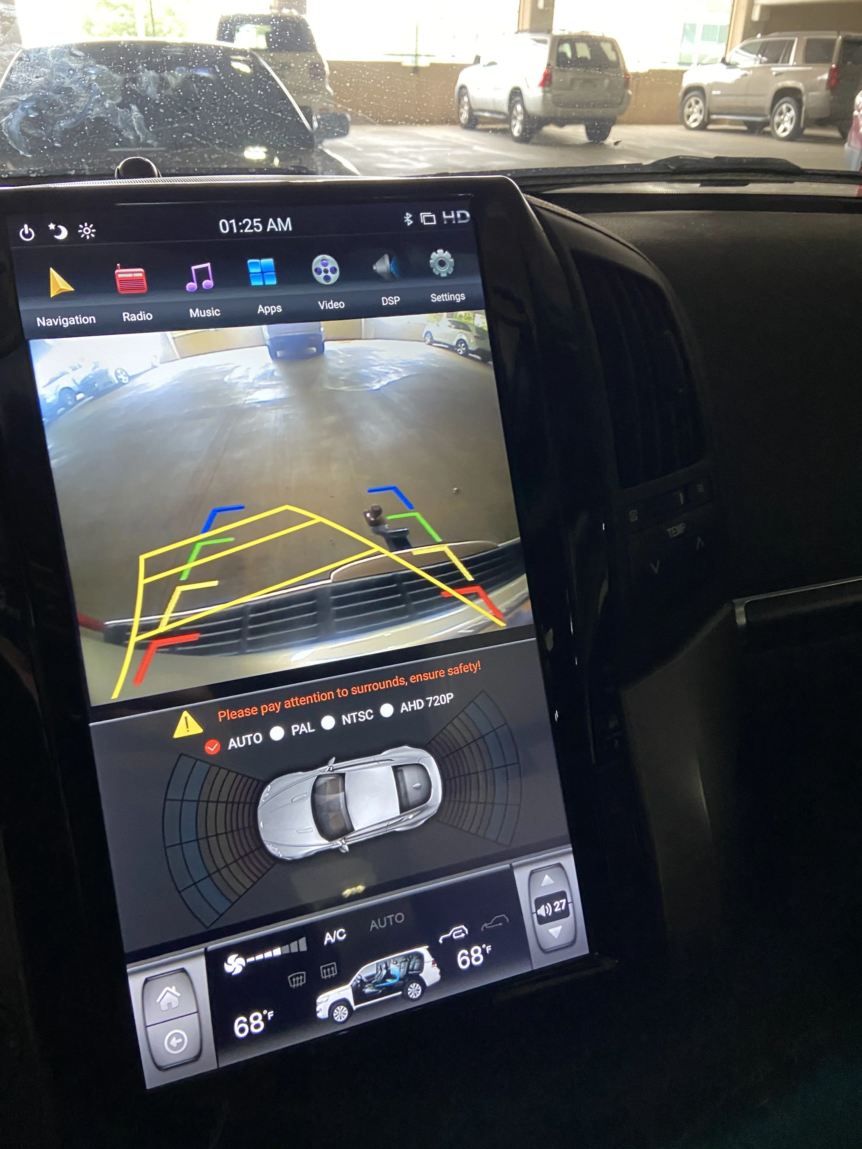

Thanks @schiller2300 for blazing the trail on this. I got the same unit and everything works but the factory backup camera. Did you have to do anything extra to get it working? Was there a certain connection that you knew was for the camera? I basically just blindly plugged in everything that would fit somewhere 😀 Not alot of skill here!

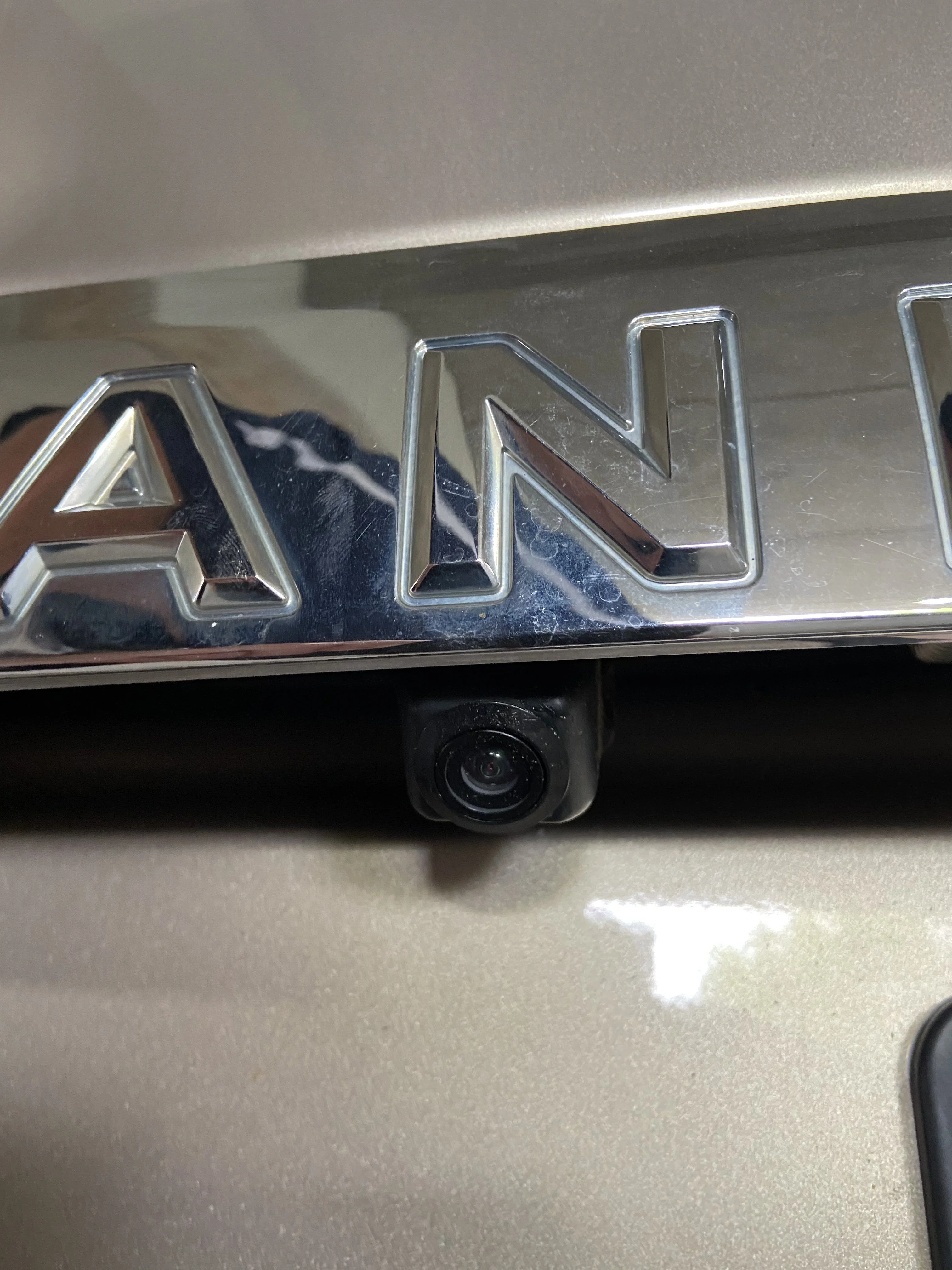

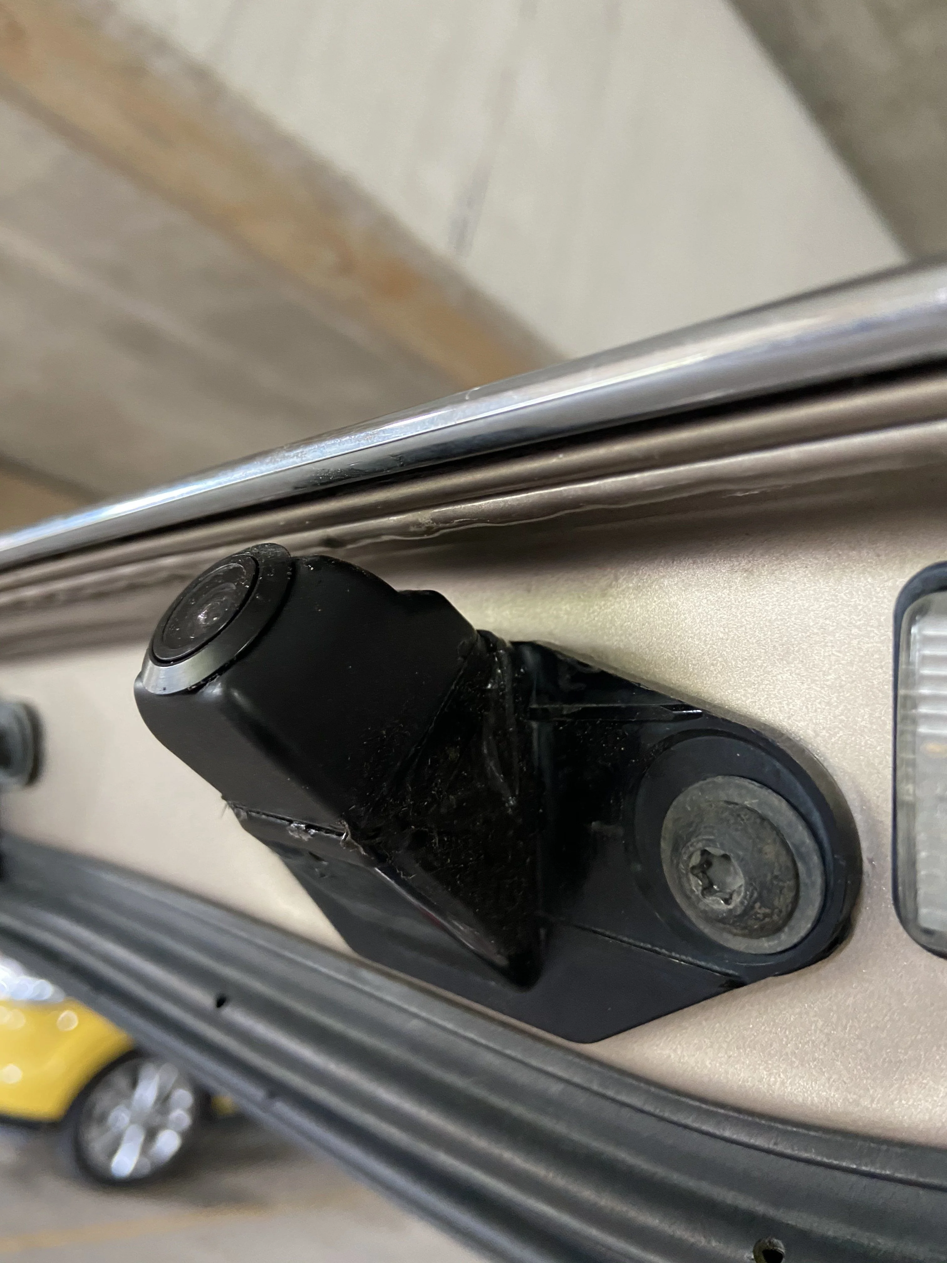

Blindly plugging things in is a very good description of how it works when installing these stereos. I think there are so many stereos for so many vehicle models that it would be way to time consuming to try and add instructions to each unit purchased for a particular vehicle. Hence the blind method. I did not use the factory camera. I replaced the factory camera with a cheap better quality HD from Amazon.
Amazon product ASIN B074P45P7G
There are quite a few to choose from - they are all the same for the most part. I did modify the original mount to take the camera that I purchased. The hook up required that I provide power and connection to the reverse light along with running the video RCA plug to the unit. That was not fun but it was worth it with the better picture quality. Another unexpected perk was the back up guide lines from the camera overlay with the steering wheel guides. I have gotten used to this double feature because I don’t make an absent minded mistake of turning the wheel the wrong way on occasion.

i have a 2008 land cruiser, when I installed it, the harness for my vehicle had a yellow RCA cable that said camera, when you plug the other yellow RCA connector to it, it should work with your stock backup camera.
Thanks @gomez268 and @schiller2300. You guys got me over the hump. I got the camera working.
