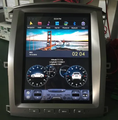

Tesla style head unit - has anyone seen this?
Hi, can anyone with this unit installed send me a picture of the advanced and system settings? My unit was working well but the a/c controls stopped working.. I think I may have changed a settings by accident ( I should have taken pictures be for I messed with it!). Overall the unit is great so far beside my a/c problem.

Everything was working great. But now my climate control stopped working. I was messing with the settings a bit so hopefully that’s it, I’ll keep you posted. If anyone has a pic of the correct advanced/system settings I would love to see them. I should have taken a pic before I messaged with anything. Tech support at AliExpress is trying to help me also

Re: HVAC - did you change the 'Car Type' in the advanced settings?
To access: Settings > Advanced > enter password [mine was 8861]
From there, you can affect different things. If it was working and stopped and you didn't change anything, you may re-check the connections to the black box on the back. Mine worked fine out of the box on a 2004 LC.

Can you verify your settings are the same as mine. Especially the baudrate settings. I haven’t got around to taking the unit out and checking connections, that’s the next step. The physical buttons on bottom still work to operate the climate control... so I’ve been using that for now.
