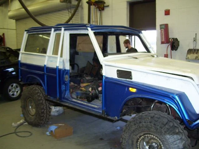

Cage is painted. I'll get it on the truck tomorrow.
That's the bee's knees, right there. I think it was a stroke of genius to paint it the same as the truck. Very cool. Your powers of fab are inspiring!

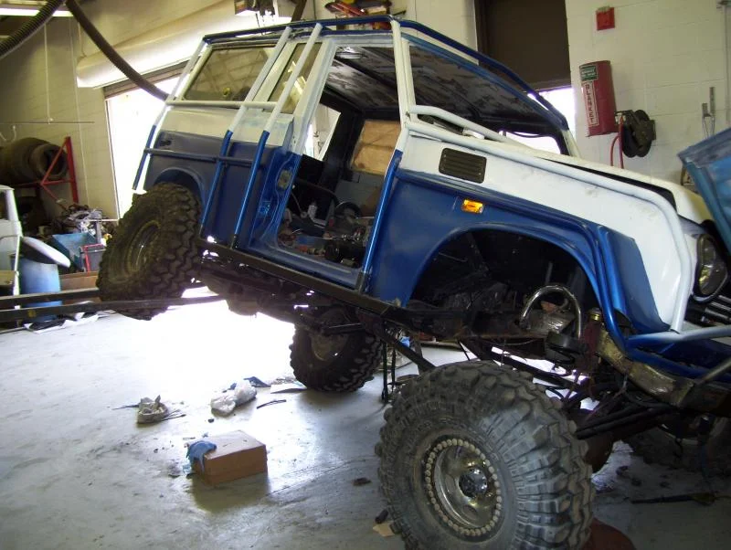

I had the fork truck over today so I flexed it out a little. Still no bump stops or shocks and the coils aren't captured, but it still does OK. I think it'll do better once the coils are captured as the body won't flop nearly as much. The shocks won't limit travel. There is way more shock length that I'll use.
The rear stuffs a bit and it'll need some trimming on the left front too.
Drool is an understatement! I'm not even worthy of living in the same state. Great fab work! Can't wait to see it on the trails.

best pic yet. the fork lift shows just how well the thing can flex. very cool. hope that thing is around when I finally get a hold of a trailer to get my junk there. I'd love to see how my thing will flex with the 37's on there.

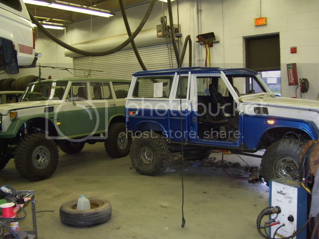

Saw the 50 in person today and it is coming along amazingly well! That thing has mnore cool stuff then the pics show. I can't wait to see how well it does on the trails. It's getting real close to it's first outing.
Thanks for the tour of the shop by the way. I sure wish I lived closer cause I'd enroll in the class to get a chance to play with all of the tools Todd has access to. Sure was nice to actually see two pigs and a 45 lv in one place. Especially in the midwest!
