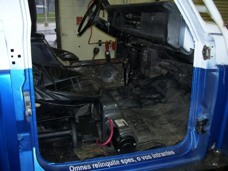

Got the shifter mounted and the front locker shifter built and mounted. I have to build a new top for the console and mount the console into place, but that's really easy. Mounted the seat frame and the seats. Messed around with the winch mount. Got the parts cut for the mount, but I still have to tub the hole where it will sit and build the mount itself.

Very nice door sill sticker. Do any of your Auto Shop students know what it means?
How long did you work to translate that into Latin?
Oh come on man, it's the information age! It took me 5 seconds to translate that into english :D

Great- now that education I'm still paying for can be replicated by Google. I knew studying the Classics was a waste of time. I can't even impress a bunch of Cruiserheads on the Interweb with my useless knowledge:censor::bang:
Dante wrote it in Italian, but I liked Latin better. I got the translation off of the interwebs.
Usually when the students ask, (none of them know Latin) I tell them without telling them the source. Some get it, some don't.
Most folks that have ridden on that side don't really need to be told.
