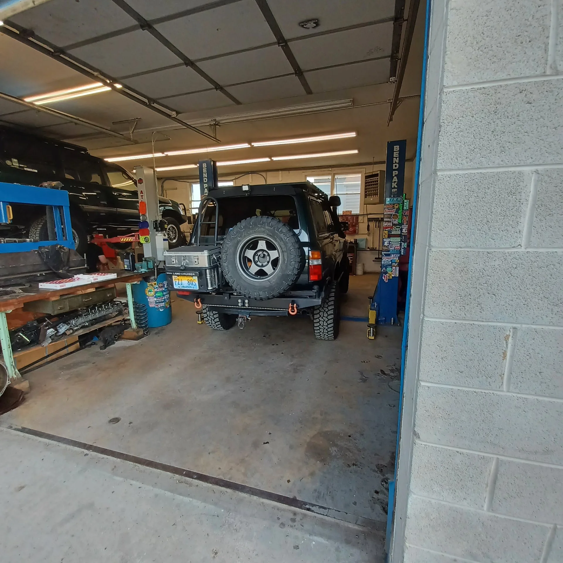

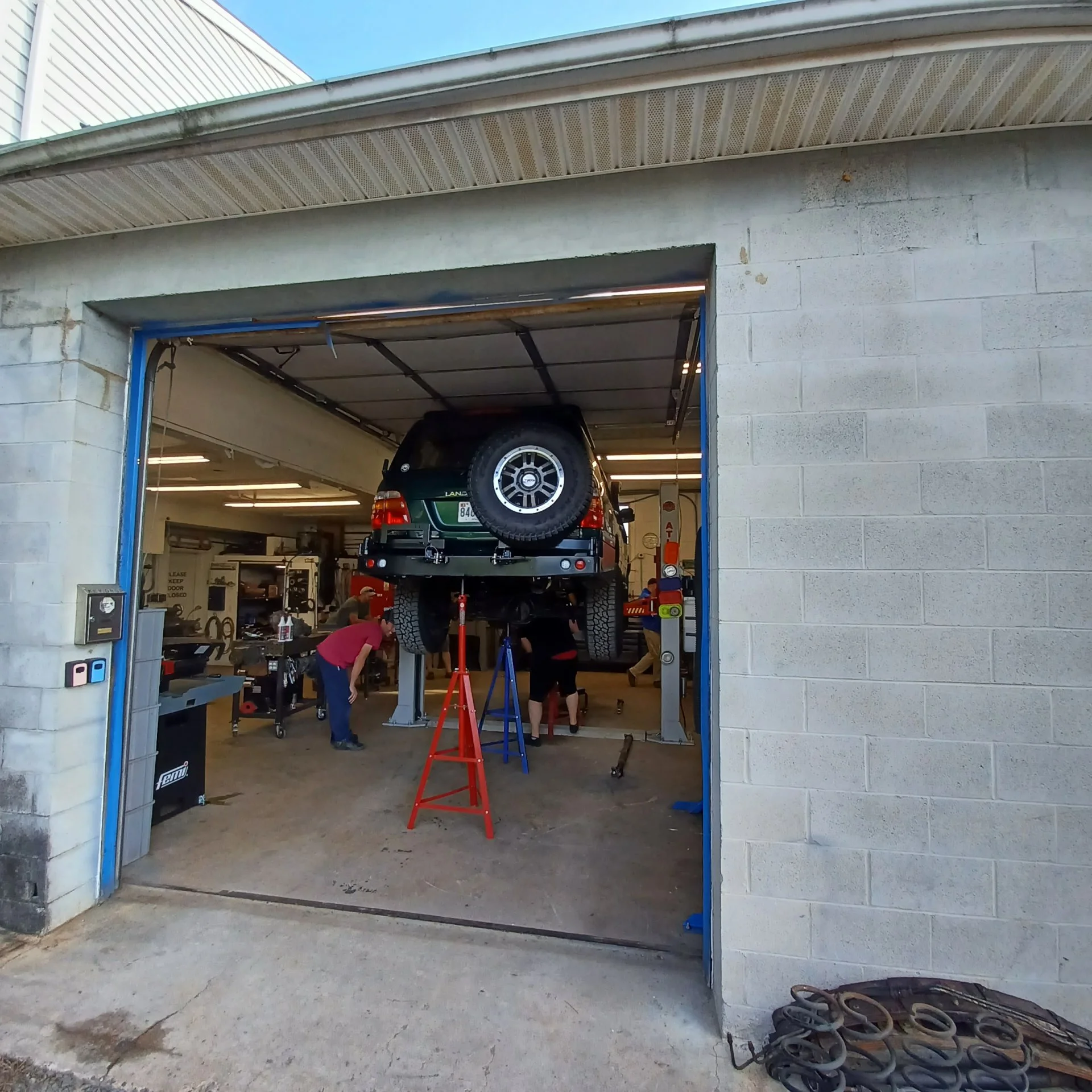

are we up for stuffing a transfer case in my 100?
if you need two hands and a strong/questionable back to help, I'm game. I am not the guy to lead this job, but I can put bolts in without crossing them and other stuff.
hahaha appreciate the help, swapping cases isn't really a hard job. it's just nice to do on a lift and have an extra set of hands. @OTRAMM replace my center diff lock actuator with a new OEM unit not that long ago so that is the only thing that would need to be removed from my case and swapped into the new one. should be a fairly straightforward install
@TRDdrew you would know better than I on a 100. We should be able to if we can get on the lift early.
