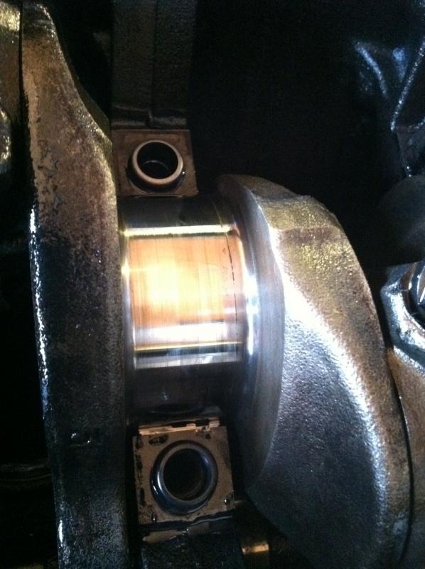

Bearing cap check
Got the oil pan back, but decided to pull a few bearing caps to check the wear before installing it. They looked good and the plastigage says they are OK.
