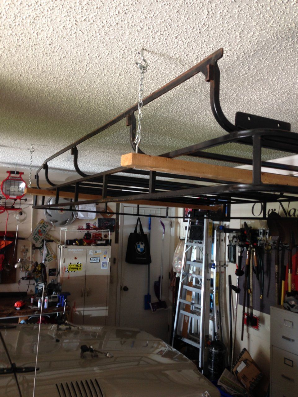

If someone wants a roof rack like that one, I've got one hanging in my garage. I'm not going on safari anytime soon.

Send me pics of your roof-rack

Mine doesn't have the bottom bar and my ladder comes off at the back. I don't have the bottom support bars either. Mine simply sits in the rain channel with similar hold down hardware. My gutters are not going to be gouged by the rack ever again. Rusty gutters are repaired. I may have to scrap the roof rack if nobody can use it.
I have a troopy now and would be interested in your roof rack. If the previous mudders fall through let me know.
