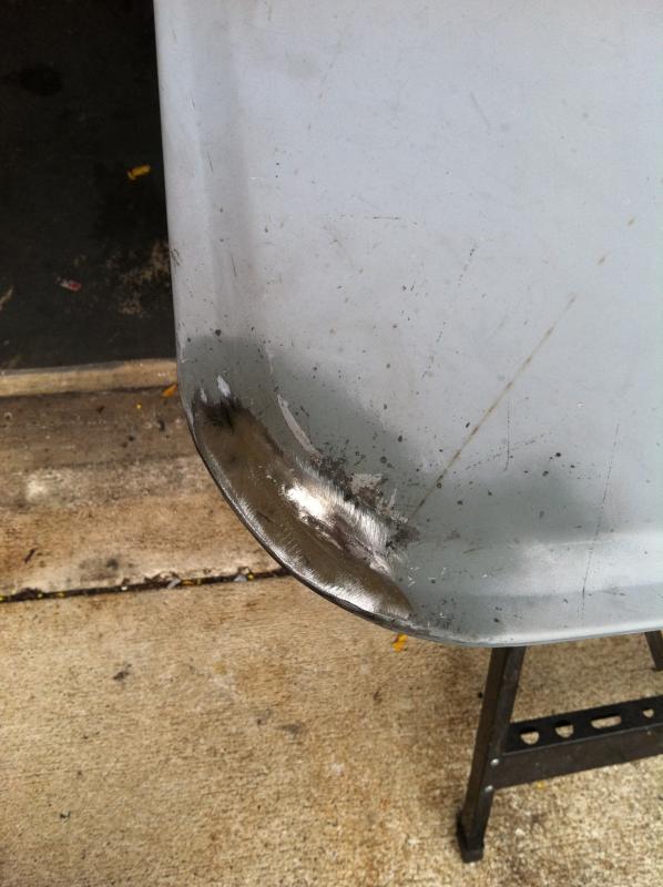

I got to the first door today and am pretty happy with the results, again hoping that the body shop gurus can make it look right before they paint it.
With a little primer on this patch, it doesn't look half bad considering I used a flat piece of metal and managed to get it to conform to the curve of the metal. Amazing what a hammer will do.

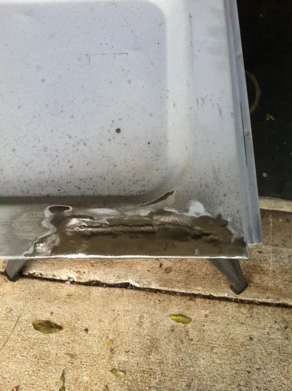

Interior ambulance door repair. I checked with my friends down in Hobe Sound at Stoney's and they didn't have any old doors that I could cannibalize for this patch, so it's on me to fabricate something. They did have a new repair patch piece for that area, $200 for the set that takes care of the front and back lower area. Another area that all these trucks seem to rust. I would have paid the $ 200 if the whole area was bad, but it's only the piece in the pic and the front area that's adjacent to it. I'm thinking nobody will see this area and I'll get to practice more on my fabrication techniques. And again, I'm counting on my body shop to make my crap welds disappear.
The first part of the door patch. I just need to finish the welds on the top and then fabricate the other lower pieces. Probably three more separate pieces to complete it, not counting the front part which is flat but curved, so it needs to follow the outer door jam correctly. I may have to mount the door first to make sure the curve follows the door opening. This would be obvious to anyone who does this for a living.
I'd starve if this was my source of livelyhood.

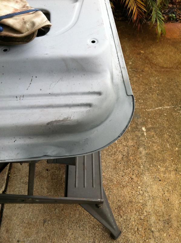

I Just need to wrap the edge and grind more of the welds down. A little more filler for the body shop to apply. The panel behind it gives you an idea of the desired shape; I'm not too far off. The other door is upside down so the grooved area is not relevant.
Just make sure you get a good deal of fish oil in those areas after it's painted to make sure the Florida air doesn't make you have to redo it in a couple years. Better yet, if there is a place nearby which has the facilities to dunk your doors and roof panels in zinc primer...
