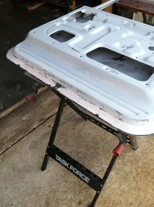

I did the POR 15 prep wth the Marine Clean degreaser and the Zinc solution the they also recommend. Tomorrow I'll hit the inside lower section of these doors with the actual POR 15 paint. If it at least slows down the rust, I'll be happy.
I chickened out of trying to use the welding wand to add the CO2/Argon mix to the paint can. The truth is, it's so little paint in that pint can, the effort to preserve it is ?? But, anything to save a buck. My gas is just about empty, so I took it off the welder and used the gravity method to add the gas to the can. I'm pretty sure the gas is heavier than air. I put a piece of plastic wrap on the can and hammered the lid shut.
FWIW, I've had good luck storing POR15 by putting a plastic bag in between the lid and the can before closing it (I think this used to be in their instructions). Then, just be careful not to "tip" it so the plastic bag stays mostly dry of POR15. I've got a gallon sitting here that I've had for at least 2 years and I used it not too long ago. There was a dryed layer on top, but good POR underneath. HTH
Yes, you need to use plastic wrap . C02 is more dense than air , so yes it will work with the gravity method. Argon is the best overall if you have access. Just saving a little is a good idea for coating small parts that crop up later , the stuff does go a long way in coverage .
Sarge
I got a little body-filler work done on the inside edge of the door and will get the other door started with the POR 15 tomorrow.
