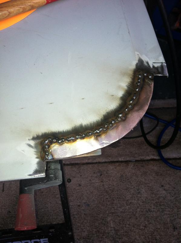

A little more done. I welded a 1/8th strip of metal around this curve to match the way the rest of this section looks. Then I grinded it down to the 1/16ths or smaller size. Obviously this detail adds some regidity to that section. A real body guy might do it differently becuase he has the tools to bend metal for this application; I have to improvise.
Looks pretty good there Gswest.

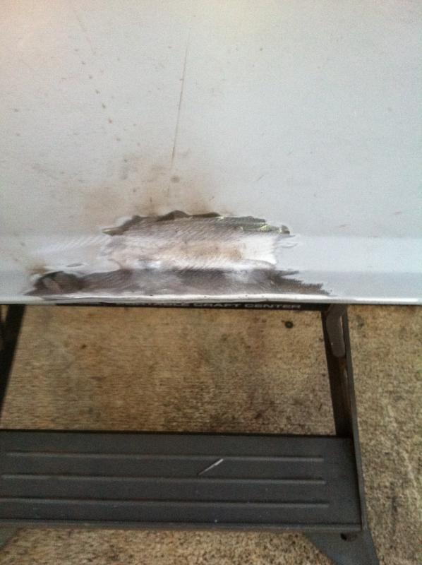

I got most of the back side of the door done today. Just need to finish the corner and smooth it all out with the grinder. I may have to straighten the front a little after all this heat hit the metal. I looked at it after today's welding and grinding and one of the lower corners looks like it moved outward or inward a bit.

Since it's not in a real visible area, I think I'll use some filler and smooth this area out as opposed to paying the body shop guys to do it. Then I'll use the POR 15 on the inside and hope for the best. They do make a repair patch for this whole inside lower area, but it's about $240 (Spector OFF Road). My repair may not look as good now, I'm happy saving the cash and don't think it will look too noticeable after its filled and painted.
