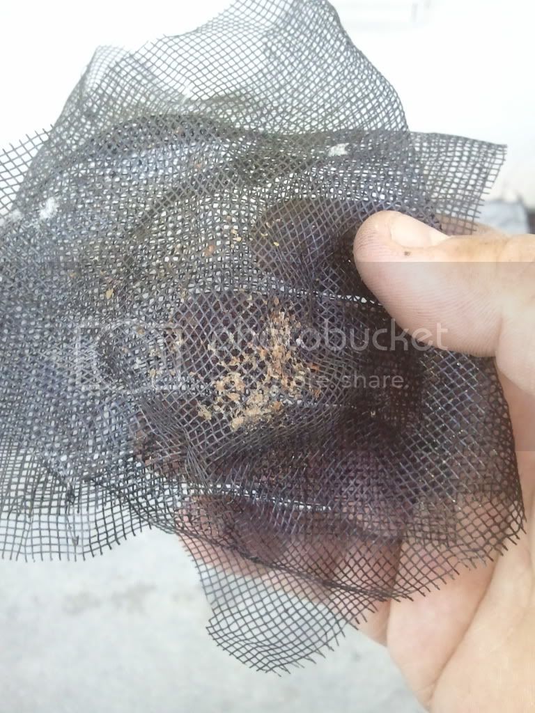

Ok.... So with an aftermarket gauge ive ran my Engine temp up to 220-235 a few times... I cant run my AC in hot weather and it all just sucks! And the main reason is loose gunk in the block.... There used to be more but its less and less....I clean my cheapo cooling filter (window screen material) often and rotate radiators and get them serviced when needed.

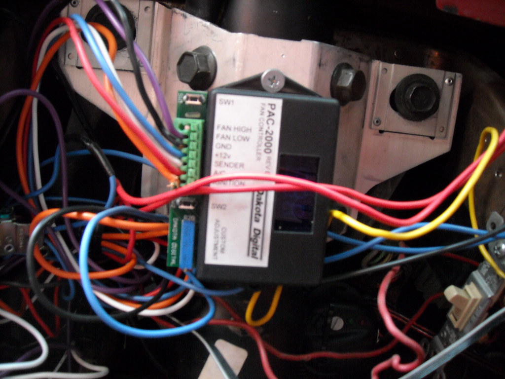

And it runs on crazy high amperage. Slow speed is like 80 amps at start up with a 30 amp continuous And the high speed is like a 160 amp at start up with a 100 amp continuous... Or something like that... It might be more like 80 amps.... Anyways... I plan to run a relayed controller
Compressor Works/Electric Fan Thermostat (733647) | AutoZone.com
But even with relays, some folks have doubts.... So I might just go with a spal controller or even this controller write up here....

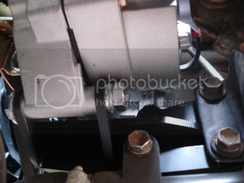

And Here is one using a CS144 Alternator (The one I will be using)... (in my opinion the best due to a bigger casing)
http://toyotatrekker.proboards.com/index.cgi?board=help&action=display&thread=641
All are rated at 140 amps. 80-100 amps at idle to 150-160 amps running speed. Now both have different connectors... (I could be wrong)
And here is a mating connector that will mate the existing connector to the CS144 Alternator...
461804 Adapter Plug Fits CS Series Alternators in Toyota and GEO Vehicles
Here is the bracket... I still need to see if its still available.
22r-re GM Alternator Bracket - Pirate4x4.Com Bulletin Board
Bracket in Action!
And here is what looks like a stock bracket install with minor modification to the alternator only. Can someone tell me if that is a V6 or a 22r?

I will be posting various schematics later, Or if fellow mudders have suggestions, please post! I would like to get the right one for me... Or maybe get an informal Vote on the best/less prone to fry my electrical system? Also, some people say wire fan directly to the Alternator... Is that really better? And I need to start ordering parts ASAP! If I can get away without the bracket, it would be awesome.
Also, if I could go straight relay (no brains to fry) with sensors like Corax used with the low speed wired to AC and an override for river crossing, it would make my DAY!
