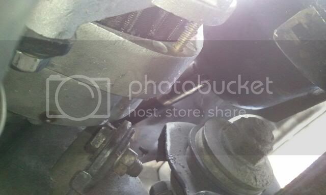

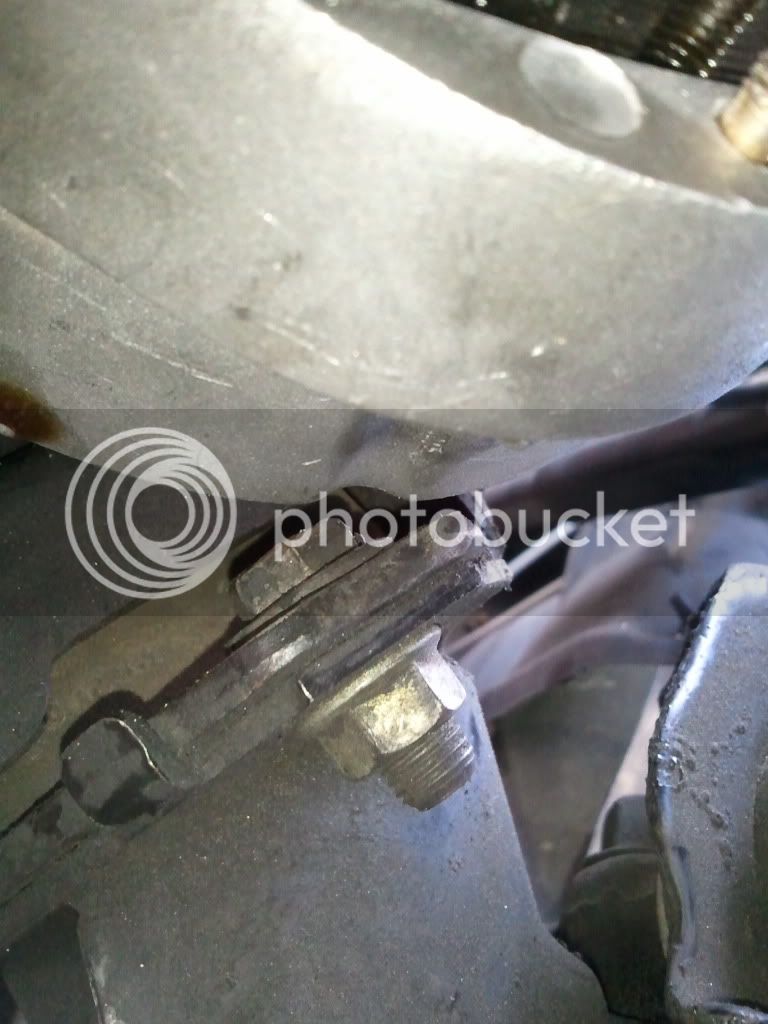

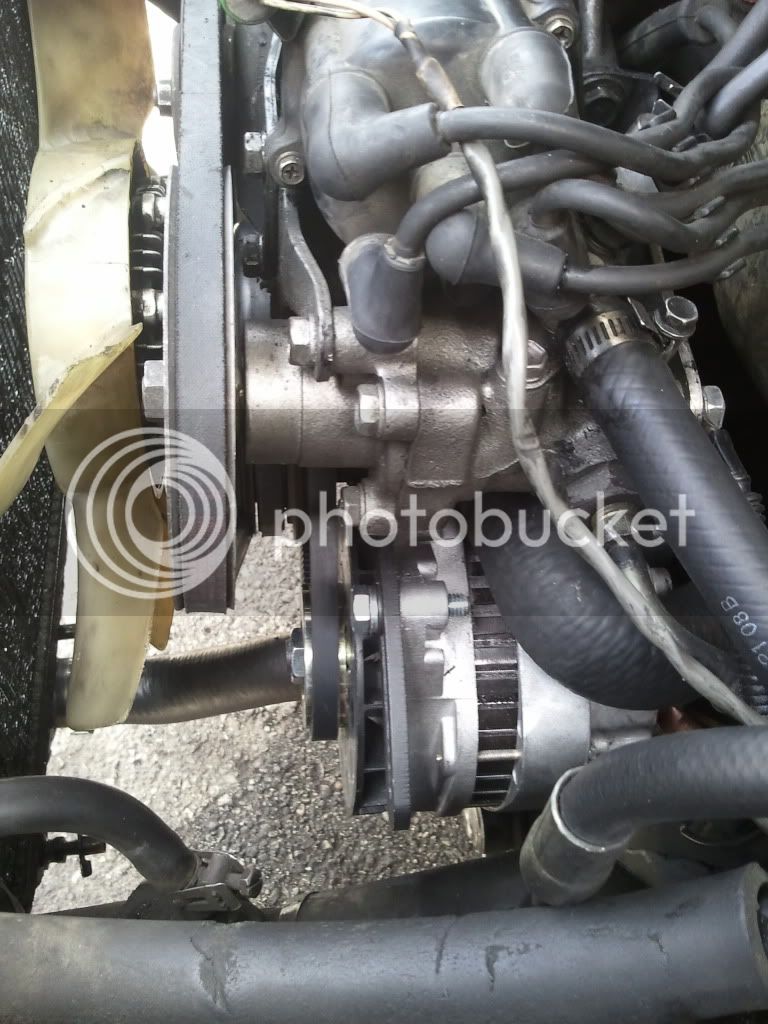

YOU WILL NEED TO GRIND IT TO MAKE IT FIT..... See the link to the CS144 amp alt. thread... Grind exactly where it shows on the pictures... Be careful not to grind off too much to where you grind through. Its a tight fit and I had to go with a bigger fan belt. One size bigger than the AC belt.
And there is little to no clearance near/at the motor mount.... LOOK!:eek:

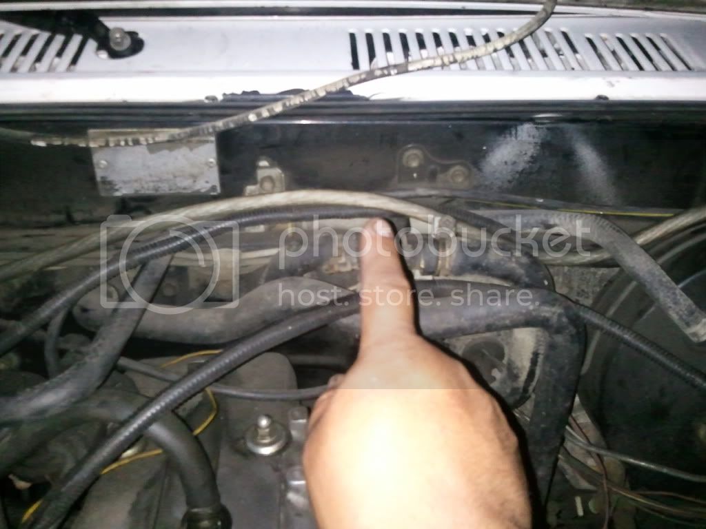

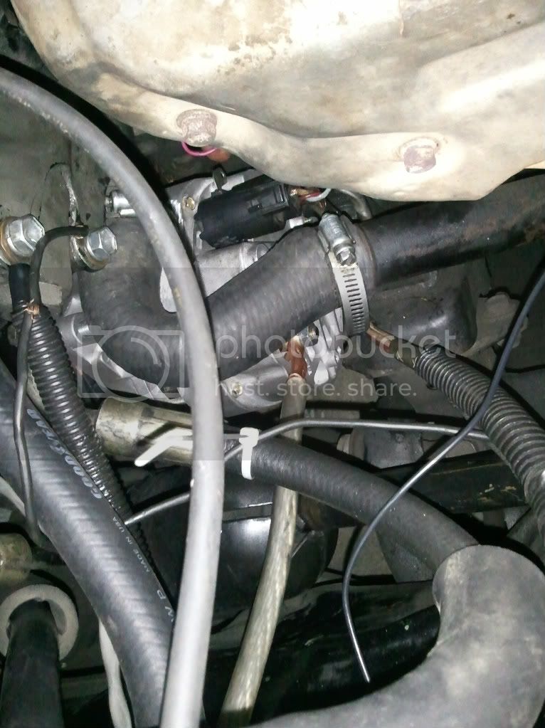

Here is a shot before zip ties
And...

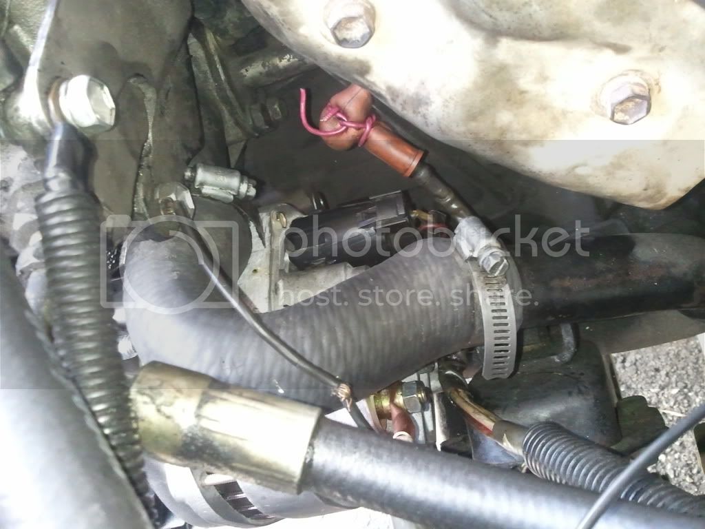

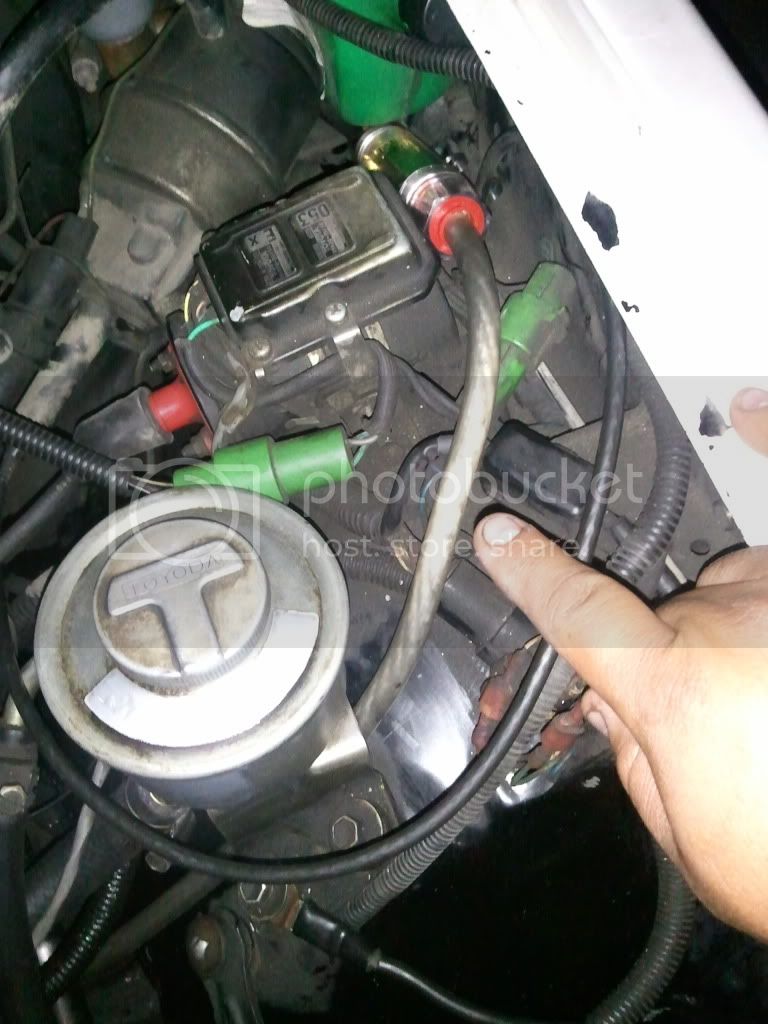

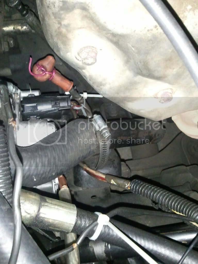

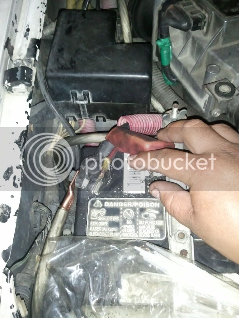

Basically I ran 2 gauge wire to the amp (close to the alternator) around back of the engine bay to the positive battery terminal and that is pretty much it.....:cool:.
My brake light finally went off and the charge light does not come on anymore when I press the brake or while the lights are on during idle.
And that was with a rebuilt OEM alternator. So now the next step is to place the 2 gauge wiring in a more permanent manner. And start working on the Taurus package. Oh and liquid electrical tape on that plug as well.
