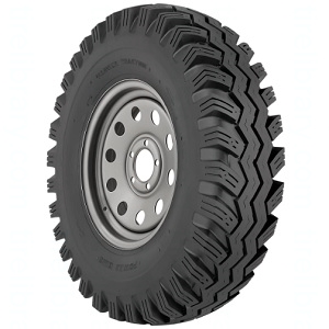

STA Super Traxion Tread E LT9.00/--16
Size​
UTQG​
Max. Load​
Inflation Pressure​
Tread Depth​
Rim Width Range​
Sect. Width​
Tread Width​
Overall Diam​
LT9.00/--16​
0​
3,030 lbs​
50 psi​
21/32nds​
7"​
10"​
N/A​
36"​

I just asked about these on chat before realizing there was an ongoing discussion about tall skinnies.
Does anyone have any real world experience with these - cough - bias tires...?

16in rims from @Racer65. Used for some rock crawling and desert sand dunes. The tires are from an online trailer supply store, however, the tires purchased are for "light truck" applications.
Get them HERE..... Available for 15in and 16in rims. Ply ratings are either 8, 10, and 14. Tires are in 7.0x15 or 7.50x16
They were what I thought the closets to OEM design available in the USA. Bias ply tires and they ride very quiet and super smooth. Can't hear the notorious bias ply "humming" on these. I use to run 7.0x15 power kings with aggressive tread. Big difference. Feels like driving on radials now.
