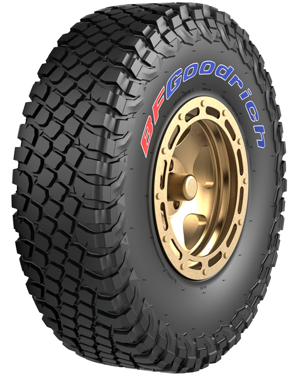

You guys realize that if you go taller in height you have to do one of two things. Increase rim diam or width of tire to make it stable. A 37 10.50 17 would be so sloppy unless you kept 80 psi in it, it would be all over the place, too much sidewall flex and would fall over on itself. You can get a tire close to that size but you have to bump the rim up to a 19.5 or 22.5 to make it stable. Look at big rigs. As cool as it sound it is not going to happen. BFG had come out with a 35 11.50 15 for the the super light rail cars, but they are non-dot only.

I disagree. Yes, you will loose some stability cornering on the street, but I don't think it is dramatic as you are portraying. For example, look at the old Q75's. That is a bias 36" tire on a 15" rim and only 10" wide...
Furthermore, I'm not going to treat my '85 pickup like a 911 in the corners. I'm willing to give up a sight bit of stability in the corners (because it is already crappy) to have the benefits of a tall skinny tire off road.
