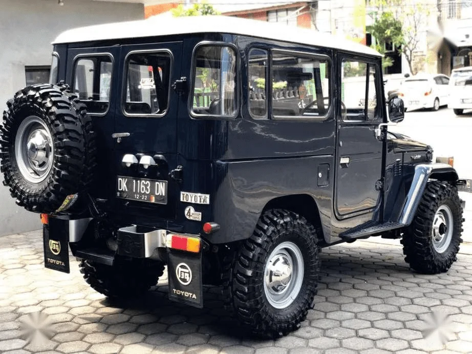

I don't if it's available there in North America but this tire is widely available in Asia. It's an aggressive / dedicated mud tire.
What's really amazing is they keep growing the list for new sizes but only stay exclusively on the narrow profile(for now). Hence the coveted "tall and skinny" profile that we yearn and love on our cruisers.
Here it is installed on a 1983 BJ40 Cruiser (31x10.50 r15 variety).

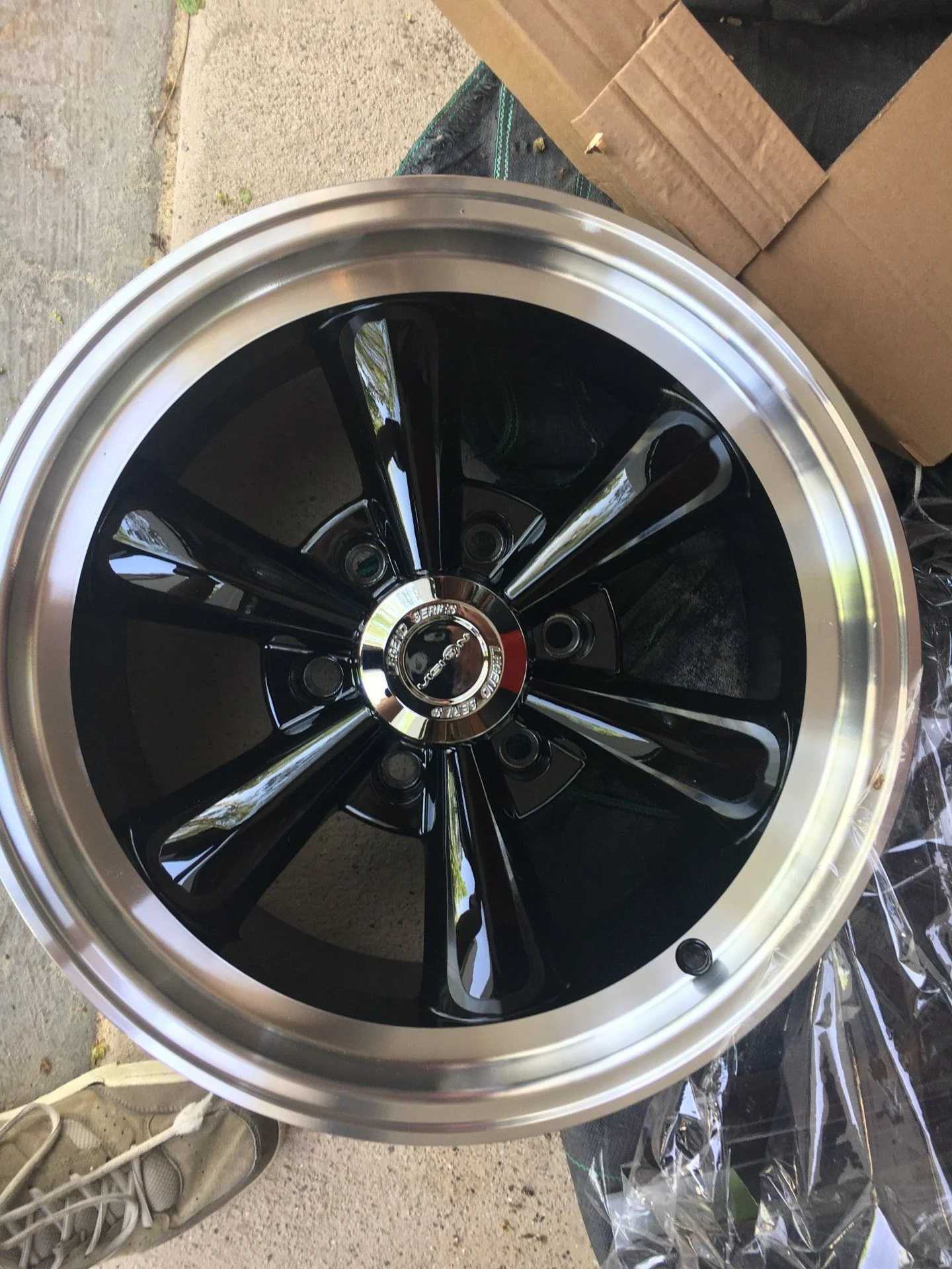

Found some rims. Old school. 17 X 8’s. They’ll do...price was right at $147 per rim. (Speedway.com)
Sorry it’s taking me so long to mount ‘em & size ‘em up. I’m busy building a new shed for my truck. Old 14 X 4 inch bridge planks sure came in handy !

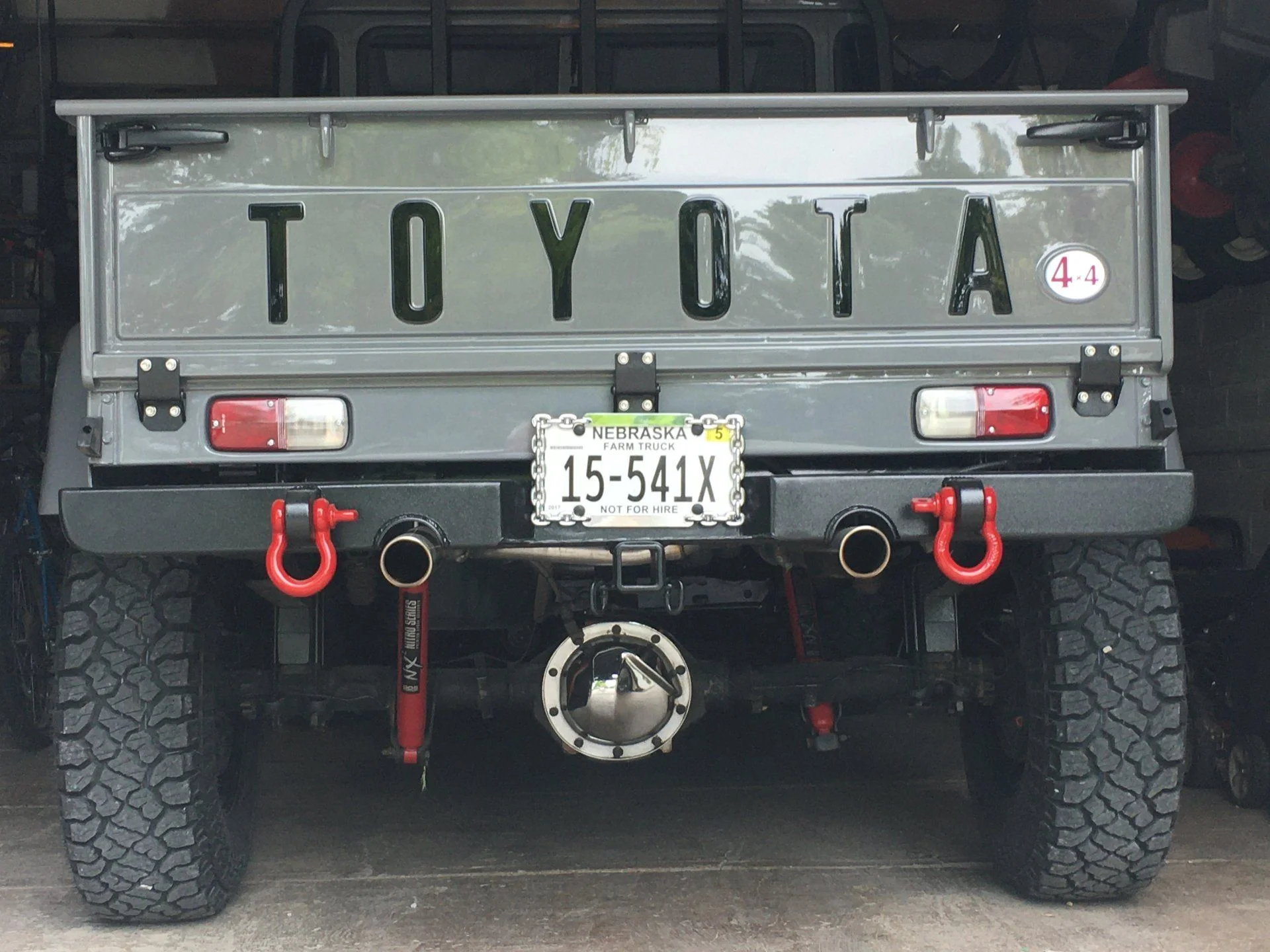

After a 9 year complete makeover she’s finally home again...(last time I drove it was in the ‘90’s ! ) I’m an old “geezer” now...:oops: ...! But a happy old geezer...though !!! :rofl: Can’t wait to put that 5.3 smallblock to work, those Kenda Kleevers (35 X 10.5 X 17R’s) ought to make it a real challenge to STEP UP inside !
The tires that were on it were just “sluffs” so it was moveable, 31 inches tall, still she sits 7ft. at the tallest point on the “headache” rack. Ended up tearing off my garage door trim at the top as I eased her inside !
I will have to let air out so it won’t be so close next time. So there she sits until I get the new shed built. It will have an 8 ft. opening. Worth the wait.

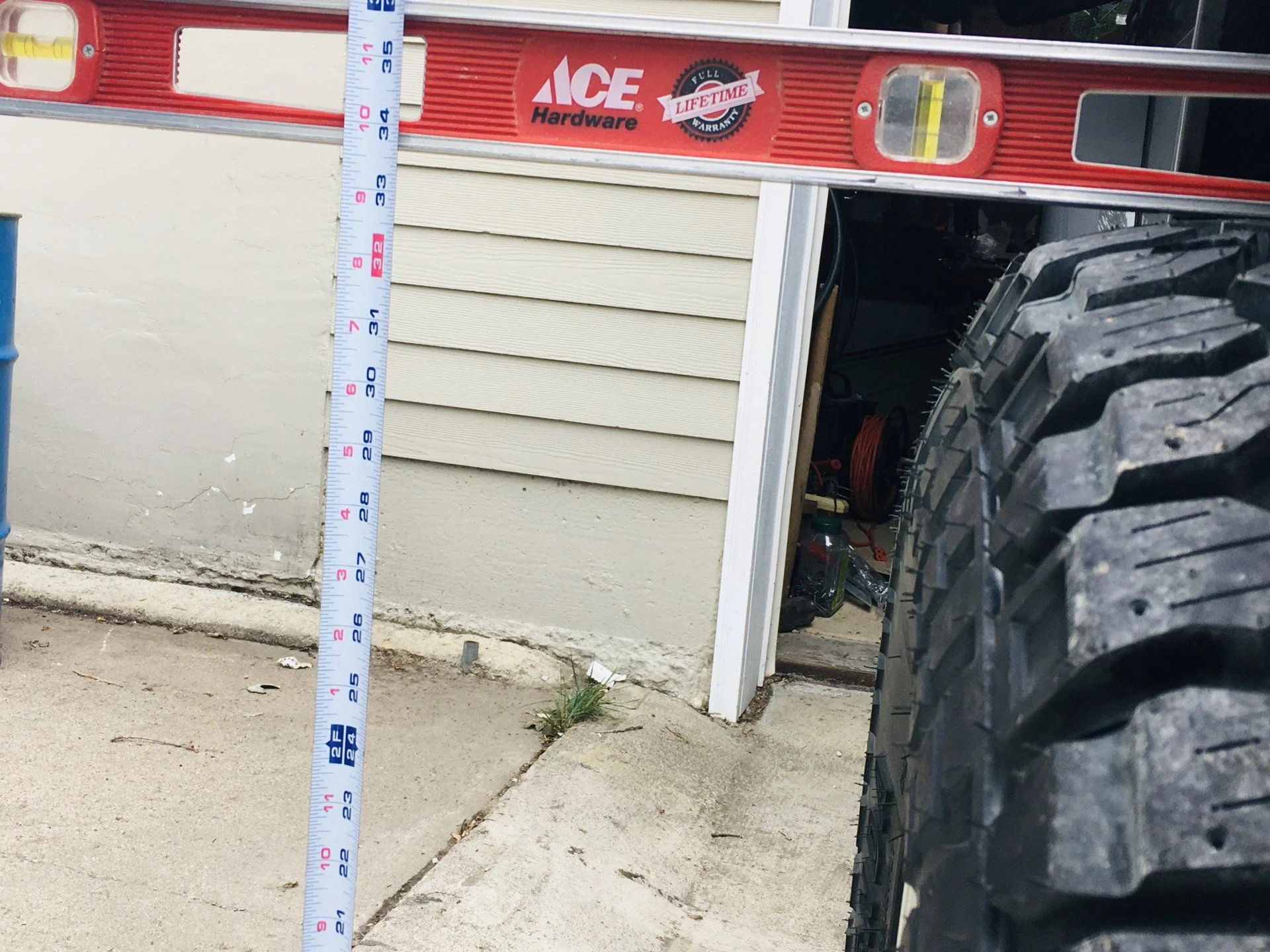

Well....looks as though we’ve been lied to again. The seller stamps 35 on the side of the tire, but they are NOWHERE NEAR 35 inches !
Aired up at 32 p.s.i. these Kenda Kleevers don’t even measure up to 34 let alone 35’s !! They come in just a tad UNDER 33.75 inch !!!
What a rip-off !! :mad: A full inch and a quarter under what they really are ! (@wngrog...Nolen was right !). Yes it’s just like I said earlier in this thread...the consumer is sold bags of potatoe chips full of air and 4 chips in ‘em. :censor: The only thing that can kill Capitalism is...
GREED !! The only silver lining in these tires,for me personally, is that they don’t protrude beyond my rear fender flares....for me, this is a +plus+
But the tape doesn’t LIE !!

Pretty much all manufacturers measure tires the same way... max designated PSI, no weight on it, measured from highest point to lowest point..... crown to crown. Measure again.
No weight on them !? But even if I took’em off, they’ll never grow 1.25 inches taller....ya know ?
They even specify how much the tire has to be inflated before measuring... something like 12-24 hrs. "35x10.5R17" is the category, not the specification. Specifications are as follows....
If you can prove differently, you would certainly have a case... even a class action lawsuit. Free tires for everyone that purchased them....

love those 10.5’s ...👍
They look great though
I don’t doubt what you’re saying at all. The majority of people who would look at the “category” markings on the tire are unaware of “tire science.” Most would think that they’re buying a 35 inch tall tire. How much LEEWAY is allowed in each of the “categories?” Is there a limit to how much WE, the consumer, are allowed to be deceived ? Is it like...anything over 33.5 inches falls in the “35 inch category.” Anything 35.5 inches falls in the “37 inch category etc.? Do you know ?
The strid got me interested so I went out and measured my tires:
My tirecappers extra grip retreads were advertised as 32". On the web page it States minimum recommended 65 PSI. I called them before I bought the tires because I did not want to run 65 PSI and I was assured I could run lower pressures. At 30 PSI sitting on the truck with weight on it my tires are 30 and 7/8 inches tall.
If I measure the diameter sideways instead of bottom to top with it sitting on the car it's 32 1/4".
If you measure your tires both ways I think you'll get a number that's closer to 35.if you inflate them to maximum pressure printed on the side of the tire, jack up that wheel measure the circumference of the tire at centerline / 3.14 should give you 35.

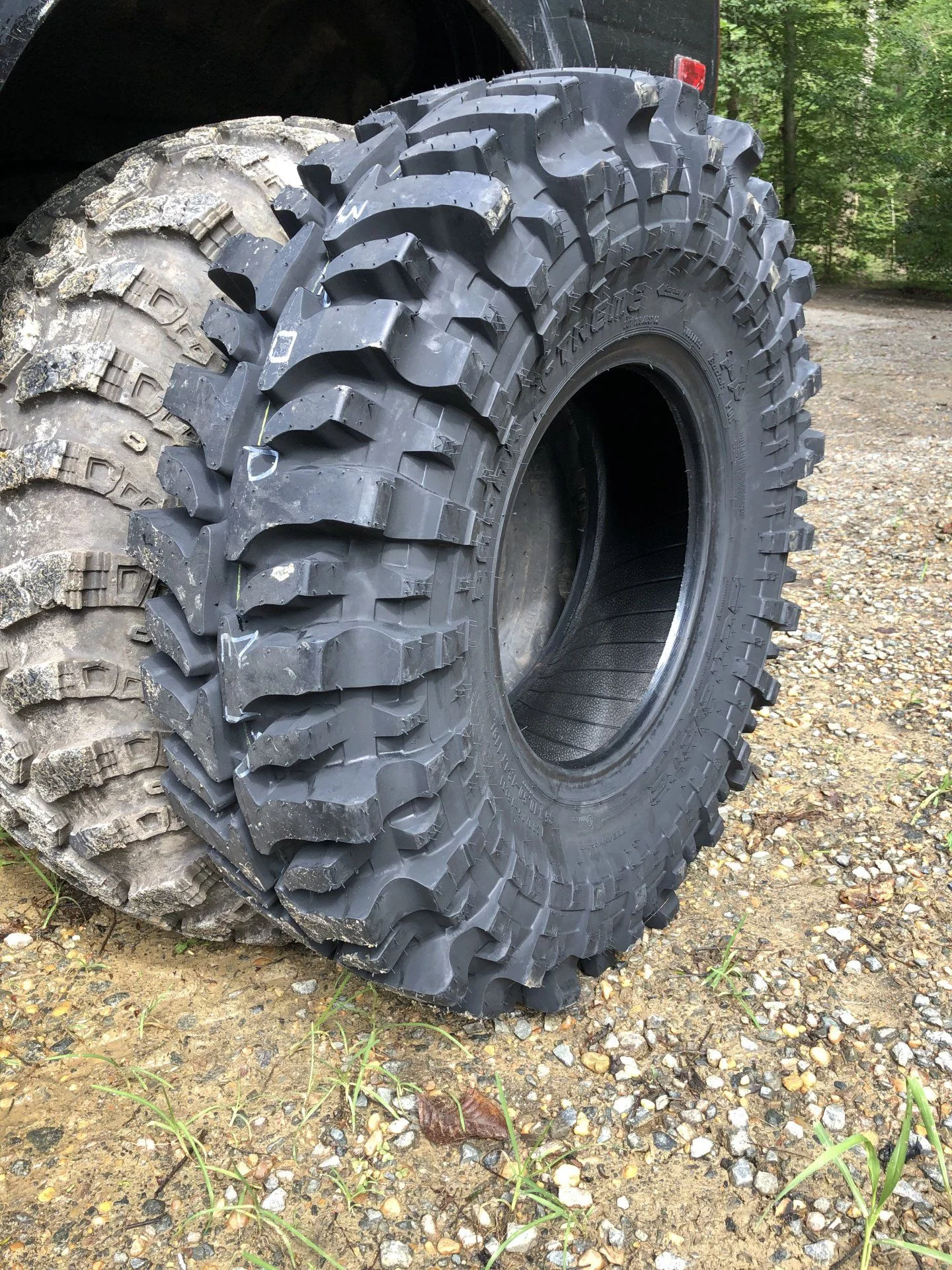

Well for those still looking for the tall skinny tires you can get the Badak Xtreme in the US now. I have one of the first sets. They are being distributed through a company called tire streets. If you get them from tire streets tell them you saw them on here. These things are sick though. ! I’m mounting them tomorrow on factory FJ80 wheels to go under my 80. These are the 35x10.50s compared to my 36” iroks but the badaks are unmounted with no weight on them so we will see how they sit Once they are on the truck. They still have the metric size on the side though and when you do the calculations it comes out to almost a 36” tire. I’m going to make a separate post about them later this weekend with more details though.
WoW !! I wish I would’ve held out for those ! Those are killer L👀K-ing chunkmeister’s ! Can’t wait to hear your report !
Do ya mind telling us the costs ?
