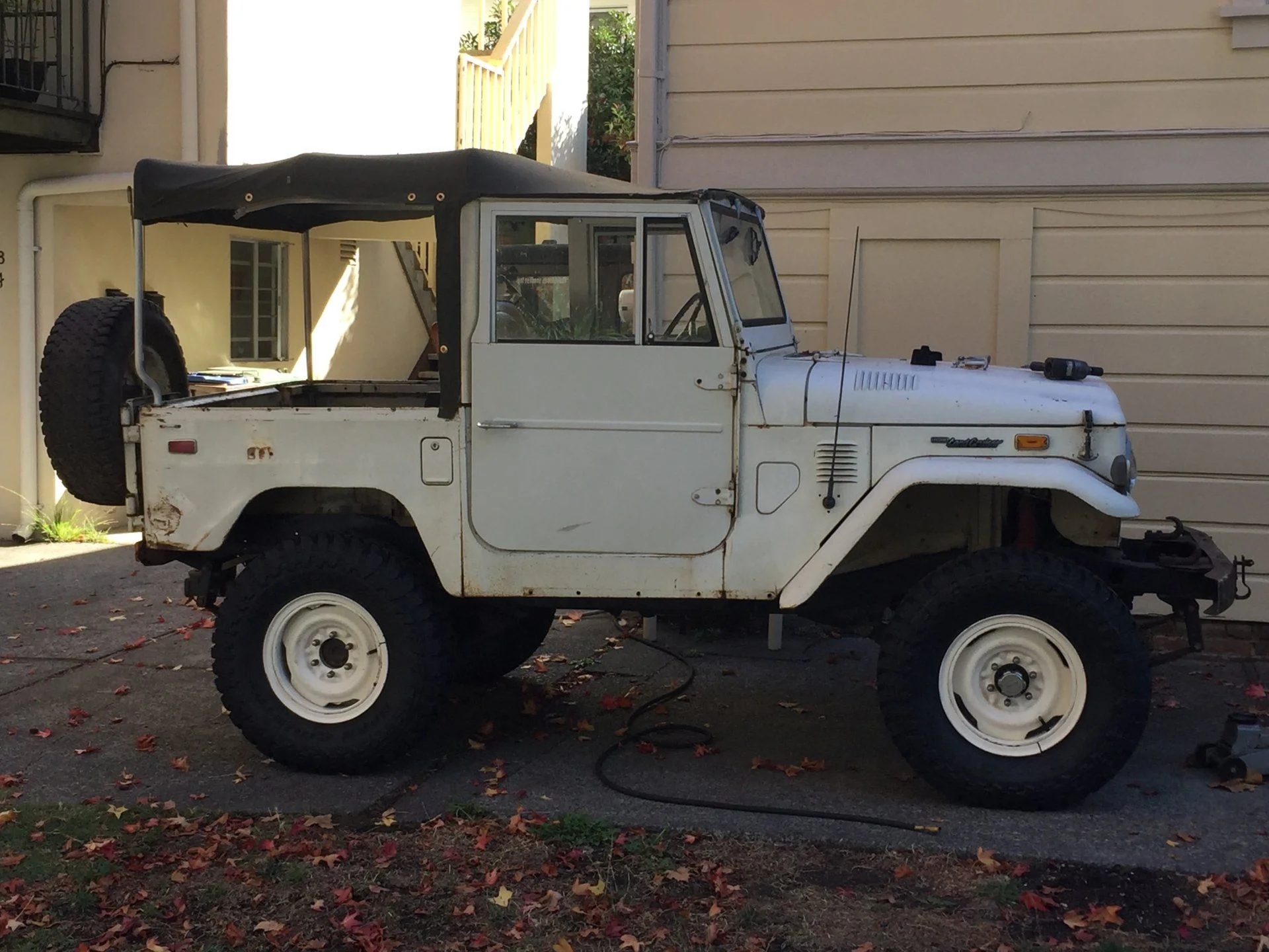

I have a 40 and a 45 I'd like to put tall and skinny on but I want to run stock steelies too. That being a 15" rim, what choices to I have for an aggressive (not Swampers aggressive) about 33" tall on the 15s? Am I too old for this equation?
In the words of an old friend... Dammitman!

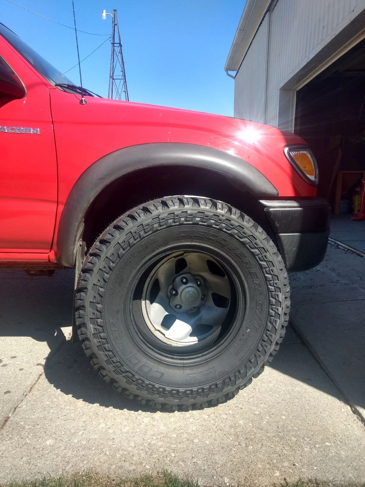

I put a tape on some 255/85-16 BFG KM2 yesterday on 16x6 Toyota split rims
Height was 32.5” tall and 9” wide
For comparison, my 33x10.50-15 KM3s on 15x7 OEM wheels are a mere 30.5” tall and 10” wide
This almost makes me think it's a mis-label of a 31x10.5x15. That does seem pretty far off.
