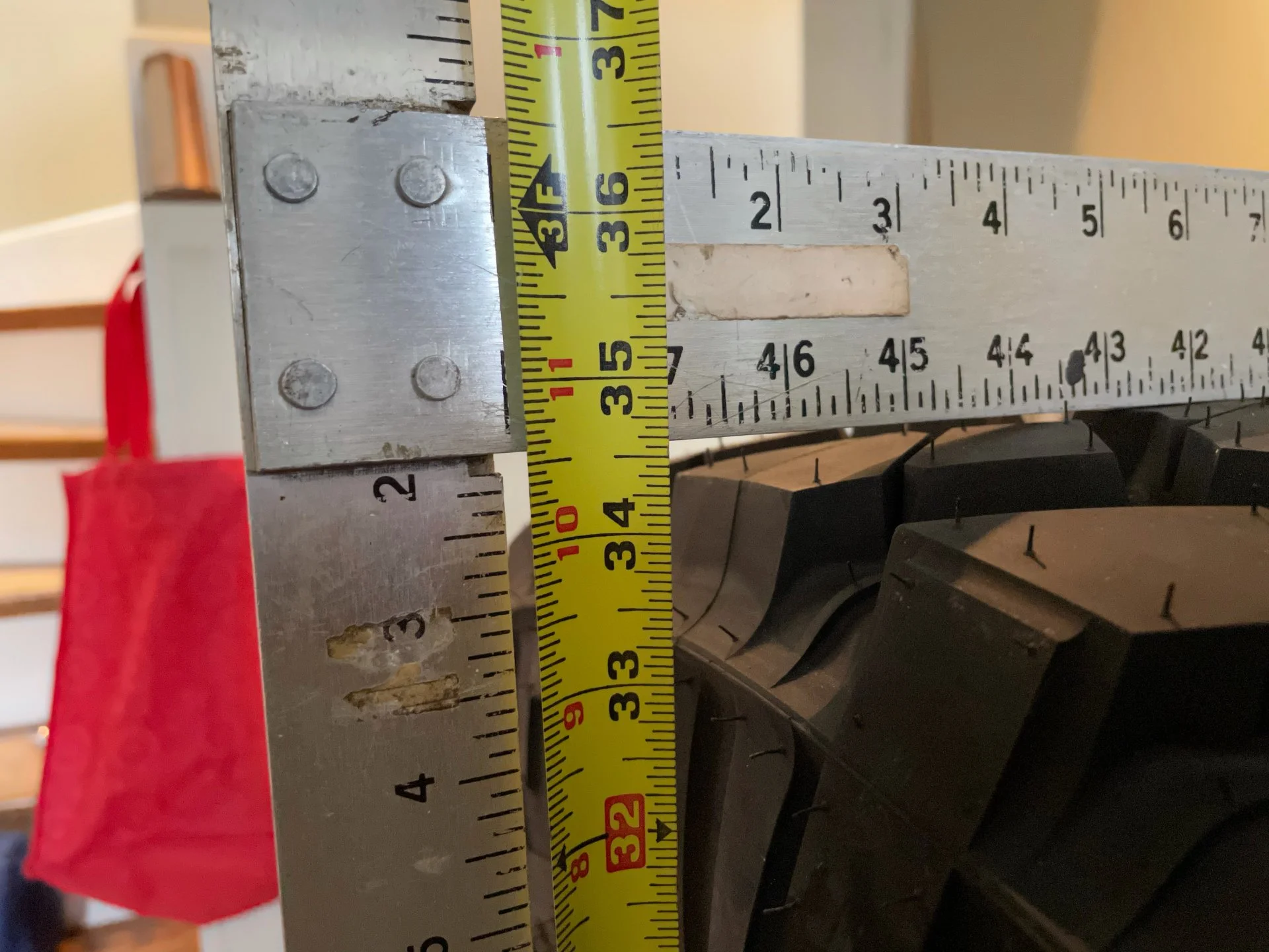

These arrived recently. 35x11.5R18 Manufacturer spec is 34.76" diameter. Here it is unmounted with zero PSI. I think it'll measure 34.76" with 80 psi....

“The website says they weigh in at 64 lbs and I can confirm that is the case, and when not on the vehicle they measure around 34.5" in diameter but once installed it is more like 34" of true diameter, even at 46 psi in the tires”

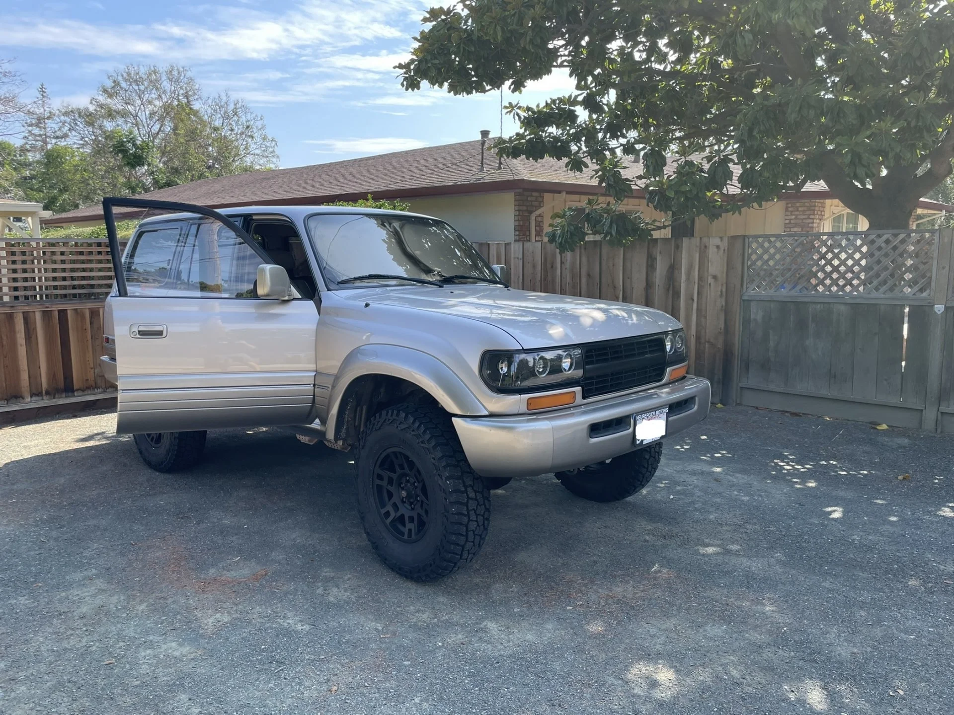

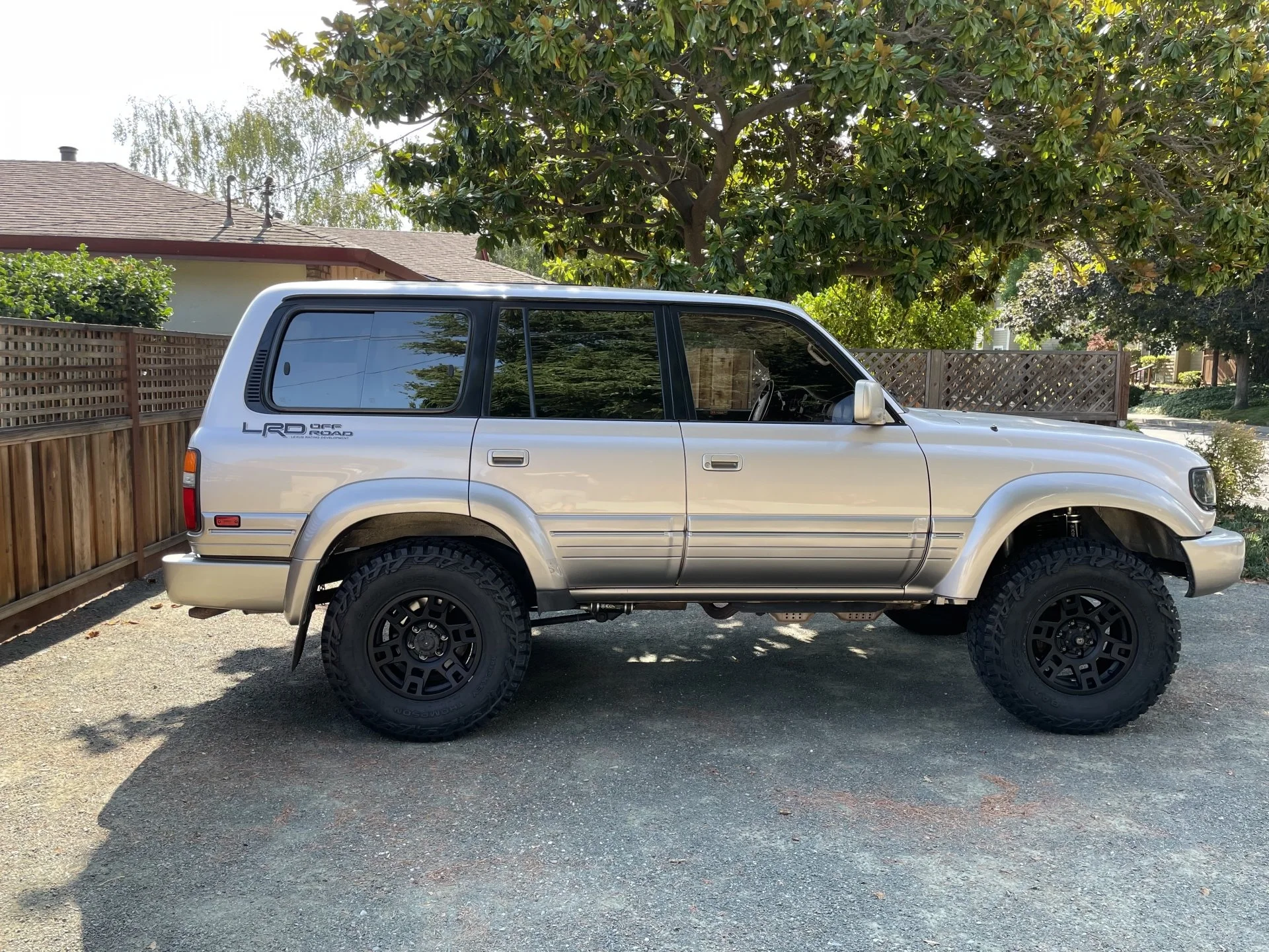

Took a chance on the M/T 255/85R17s but they are in fact “tall and skinny”.
I just ordered the wits end spare tire lift bracket so I’ll test fitting it into the spare location as soon as that arrives (hopefully this weekend).
previous tire was a 275/70 so not much skinnier than I was used to seeing on the car.
View attachment 2745136View attachment 2745139View attachment 2745140

they were excellent for the 2 miles from tire shop back home 😬
honestly didn’t seem any louder at freeway speed than previous A/T tires. Upgrade in size (+4” diameter) was noticed because turbo spooled boost at lower RPM than before but car wasn’t any slower because of said turbo.
I can measure them tomorrow to get a more accurate diameter.

Those are M/T's? No disrespect intended, but that's the mildest M/T tread I've seen. It looks to me to be an A/T tread which is probably why they're not any louder than your previous A/T's. Also, both M/T's & aggresive A/T's run the quietest when they're new, so enjoy the silent period for now.
