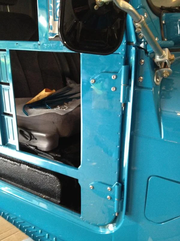

the standard fst hinges can be made without removing the hinge from the truck just requires a saw cut on the body hinge .cut the door hinge and weld a metric cap screw to it and your done takes less than an hour and i have had them on all my fj40s.
Shelfboy1,
You are totally correct in what you said about modding the stock door hinges. However, if you have nice doors or expensive aftermarket tube doors or home-made half doors that mean blood, sweat and tears there is value in the security of locking the doors in place with the hinges. With fst hinges they can "walk away". Also, the fst hinges were never meant to carry the weight of factory hard doors or any other metal door. There is no provision for wear preventative bushings in that configuration. I applaud anyone for doing their own mods to ease door removal. This was my own way to fix my own hinges and I chose to share it with other fj40 owners.

Finally got the fst doors back from paint.
