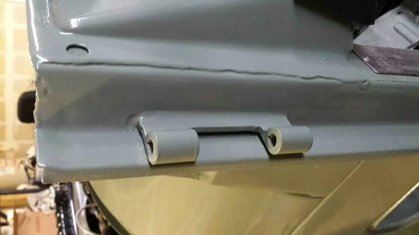

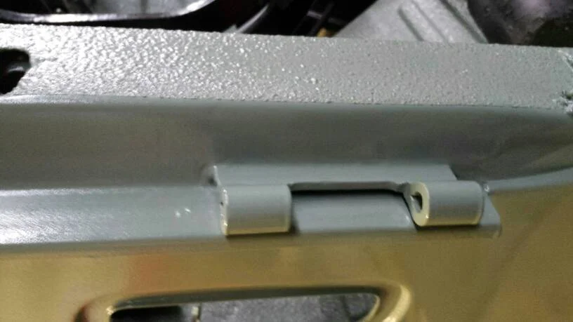

Not the quick hinges but same idea
I thought seam sealer would be tough but it worked great. Smoothed with a finger dipped in paint thinner
You have to apply the sealer from the outside and inside
What are most people doing with the small gap at the tub where the OEM hinges have rubber? Leaving the small gap? Seam sealer? Looks like a tough spot to get a clean application of sealer.
Great looking product!
A bead of silicone RTV. If you use a long nozzle on the tube and have your doors off, you can get around it pretty well.
