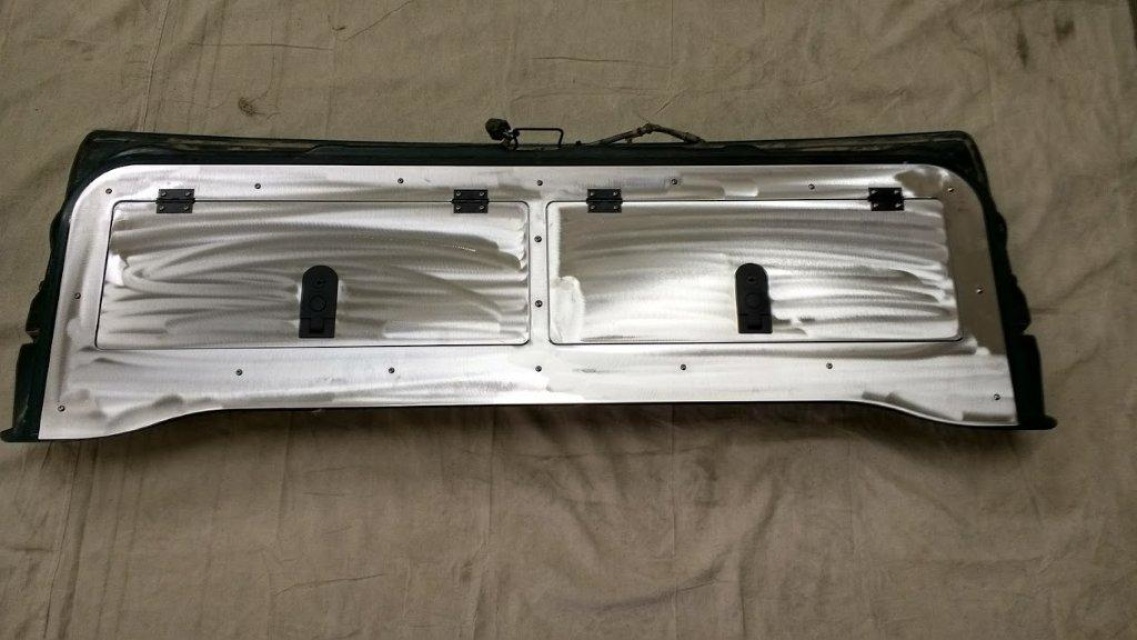

I have finally gotten all the numbers in and have pulled the trigger at the laser cutter to make a run of these.
PM me for pricing.
Lids will be 3/16" aluminum with dual doors and Soutchco sealed locking latches. Stainless bolts and nuts with allen wrenches and antiseize. Doors are fully supported by an inner perimeter rail that is welded to the main face frame.
I've flipped the latches and locks for various reasons. So, the door will now open into the cab instead of out.
These are bare metal and available for order now. Currently at a 5 week lead time.
Thanks to the orders already made. I'll post updates as I receive them from the cutter.
J

What are the black latches you used called? I'm looking for some for door latches on my trailer
