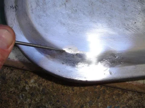

Here's another rust hole in the driver's door patched:

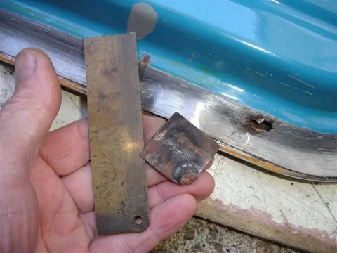

It can be useful to place a scrap of copper or brass sheet behind where you're welding to stop too much birdsh#t appearing on the other side.

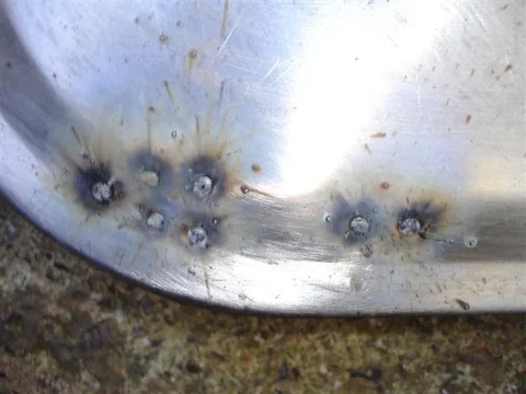

And another hole with before and after shots:
And here's that rusty corner I started yesterday:
I can no longer find any weak areas where I can push the point of a scriber thru .... so I'll call that done.

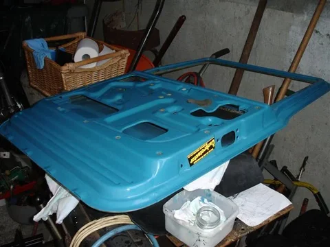

Well work is progressing on my RH door.
I'm waiting for fine weather to spray the outside but at least the inward-facing surfaces are all done now:

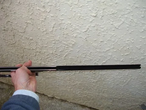

And these photos explain why you shouldn't ever attempt to use "flexible bailey channel" in the top section of your doors:
Because the rubber is flexible, I think it needs to be held/supported within a metal channel. And this channel is simply not present in the larger part of the door. (So you must use "metal-backed-bailey" for that.)

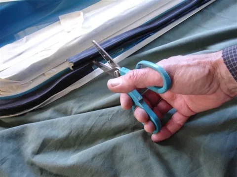

And strangely enough, unlike the LH door seal, this RH one had surplus length that needed trimming:

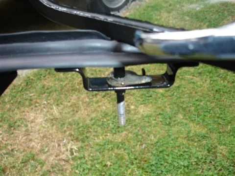

And these pictures show the importance of having the vent window "wide open" when either inserting or removing the vent-window-assemply from either door:
(It turns the "stop-plate/cam" into a position where it won't interfere with the sill.)

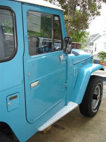

And I'll finish today with a couple of pics of the RH door refitted:
(The weather's fined up now so I'm off outside to refit the door trim etc.)

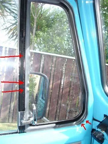

I got "crinkles" in my vent window rubbers:
