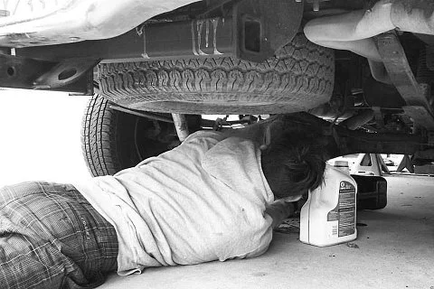

I did a bunch of maintenance work and fixed a couple small issues.

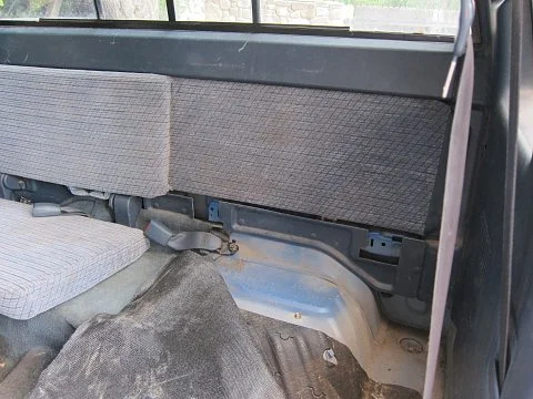

Next, I got to work inside the cab. We ditched the bench for bucket seats and removed half the rear bench for extra storage/dog bed.

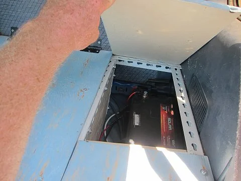

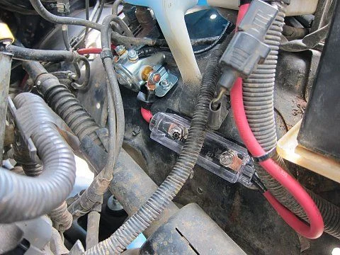

We also installed a 150ah house battery. It is wired through a solenoid to be charged by the alternator while the truck is running and will also be charged by a 300 W solar suitcase.

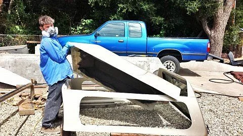

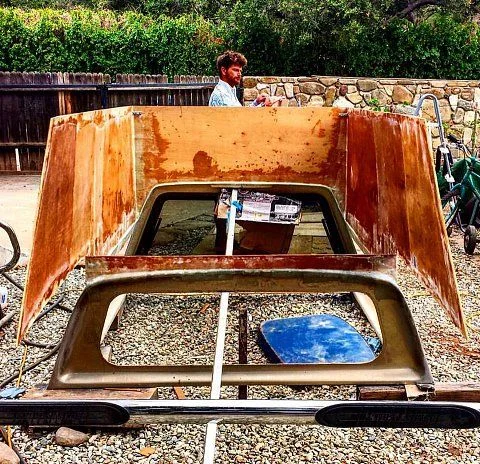

We started by purchasing a used fiberglass shell off of craigslist for $90 and cutting the top off with an grinder and cutting will.

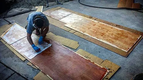

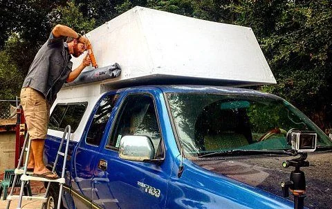

I then used 5mm plywood and 6oz fiberglass with epoxy resin to build a tall camper with cab-over storage for surfboards.

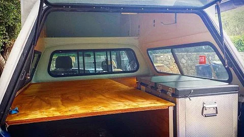

We constructed a sleeping platform that rests on the bedrails and a divider wall built out of 1-inch angle iron and 1/2 inch plywood.
The platform itself is 1/2 inch ply with 1/2 ply supports glued and screwed at the unsupported edges.

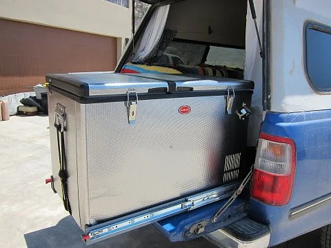

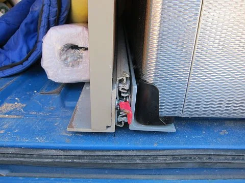

We built our own fridge slide to accommodate our 66L SnoMaster fridge/freezer using angle iron and drawer slides.

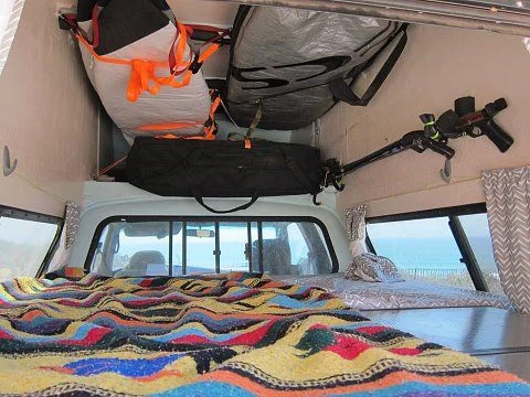

Here's a shot of the inside once we started packing.
