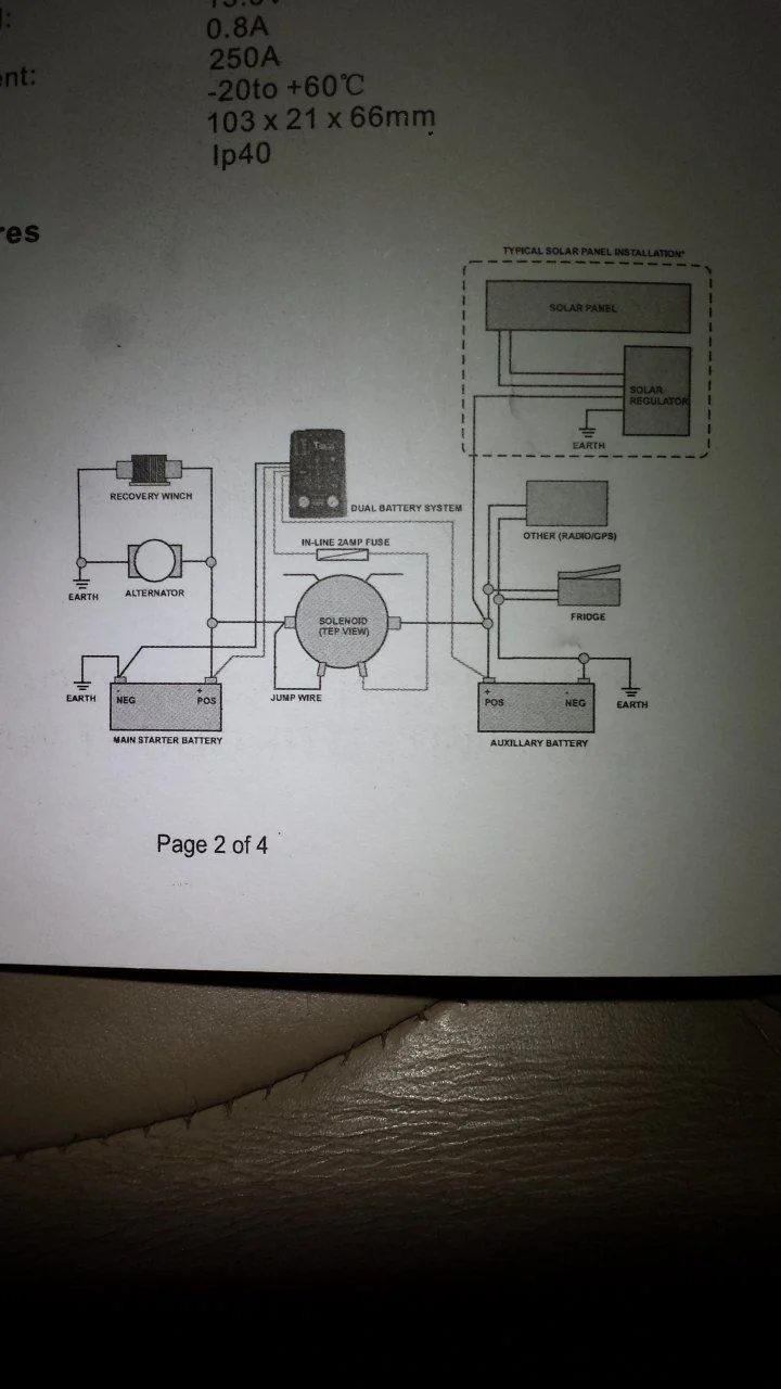

I am having an issue with my T-Max dual battery system switching back and forth from linked when charging from a solar panel. I thought I would post it here since similar issues have been discussed and maybe someone can help shed some light on something I might be missing. I'm testing a setup that is installed with a solar panel to charge my dual batteries. It is a 100w panel that is wired through a morning star 10A controller(SS10A) to the axillary battery just as described in the T-max instruction manual in accordance with the SS10A instructions. The T-max instructions state that the controller will automatically link the batteries when charging from a solar source to the AUX battery.

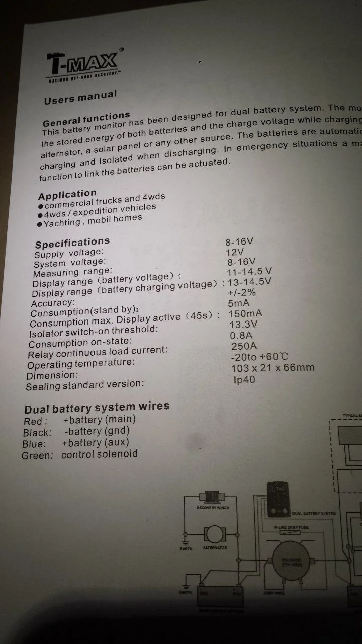

I Found that at ~13.3 volts the T-max controller will connect both batteries for charging. The owners instructions provide this cut in spec, but do not provide the cut out/off spec. In any case, it is relatively easy for my auxiliary battery to reach that 13.3 volts with minimal charge from the solar controller. Then the T-max controller activates the solenoid and links both batteries. At this time the voltage drops. This is based on the state of charge of the main battery and the voltage drop across the solenoid or other loads. My voltage would often drop to 12.8 volts. This is low enough for the T-max controller to disconnect the batteries. Within 30 seconds of being disconnected, the charging voltage of the auxiliary battery reaches above 13.3 volts and this cycle repeats itself.

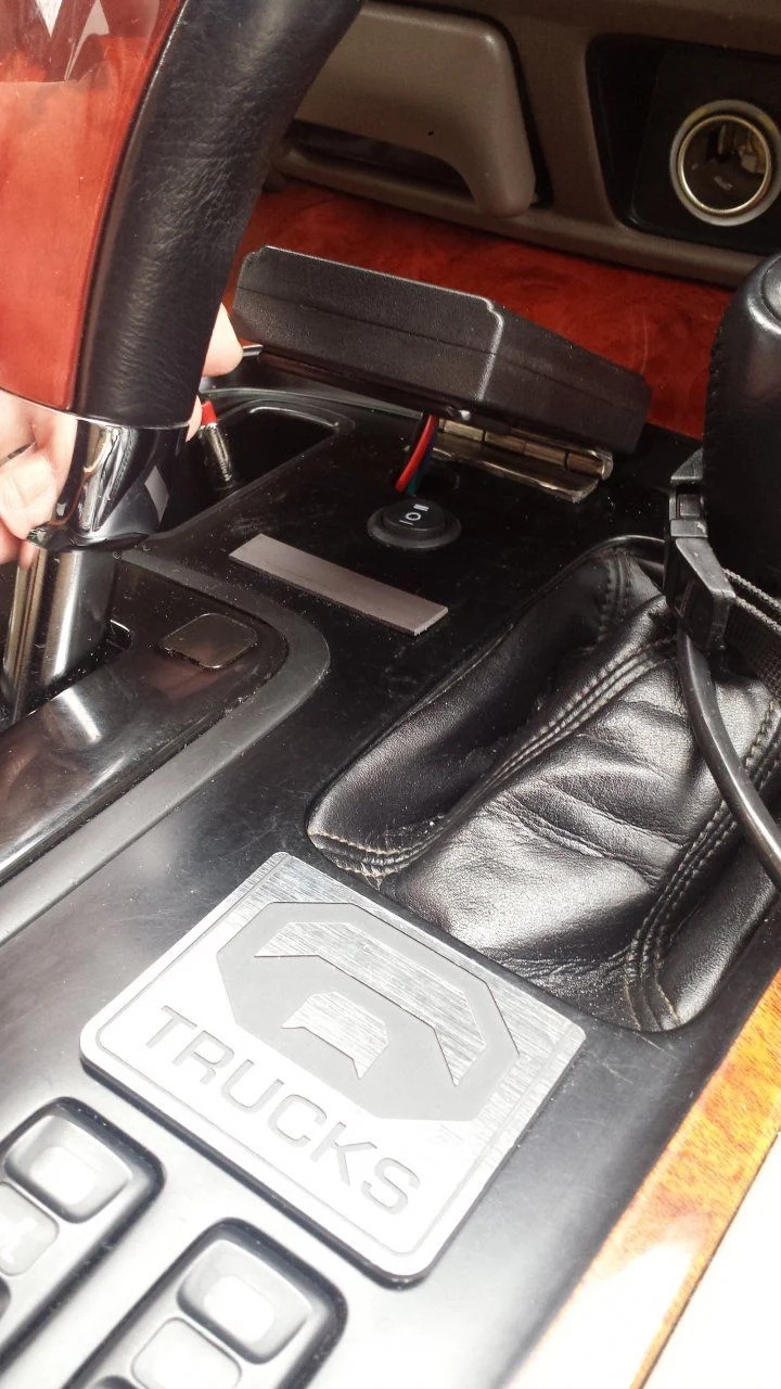

I decided to add an on- off -on switch to the green lead from the controller that operates the battery link solenoid. This gives me 3 main options.
1- ON-(green to ground) both batteries linked all of the time allows jump starting and charging and avoids any timers to automatically disconnect the batteries.
2- OFF- keeps both batteries disconnected all of the time. (this is the one that I am using most often) In a standard single battery setup the main battery does not need additional charging from sources other than the alternator during normal operation most of the time. This prevents my main battery from being discharged by auxiliary loads. My Solar panel is an adequate charging source to keep my auxiliary battery charged most of the time, depending on the sun and loads. I can always connect both batteries during a long drive, if my auxiliary battery needs charging.
3- ON- (green to green) resumes operation as designed by the T-max controller.

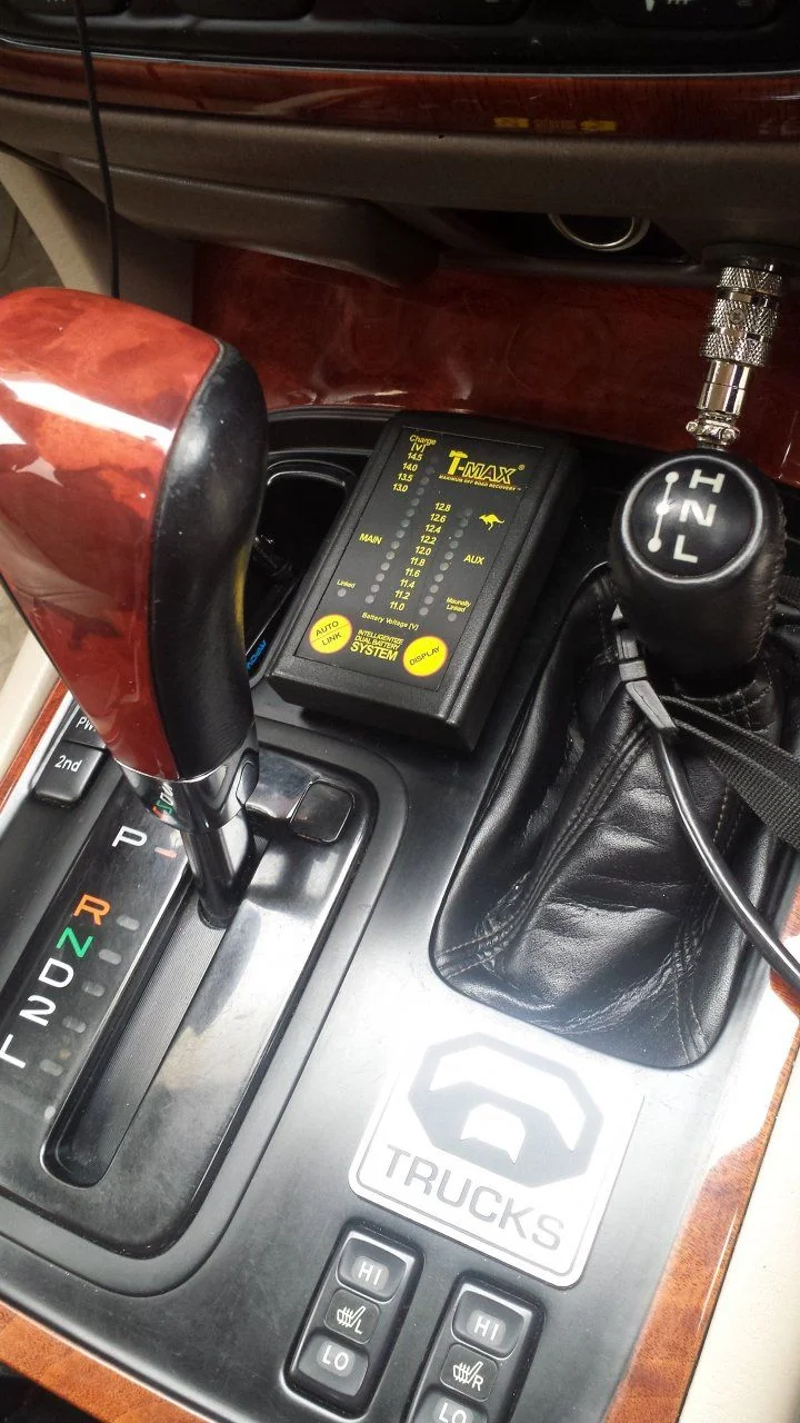

Here is a picture of my switch under the T-max controller. easy to access yet out of the way. My T-Max controller is installed to a hinge with a magnet to hold it shut.

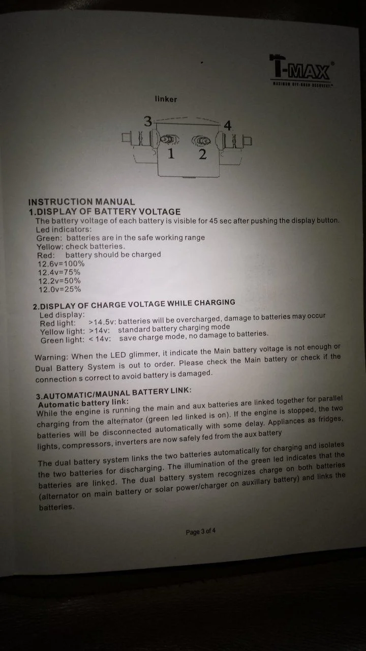

As additional information, I am going to attach a few photos of the T-Max user/operating manual. sorry if they aren't the best pictures, hopefully they are good enough.
