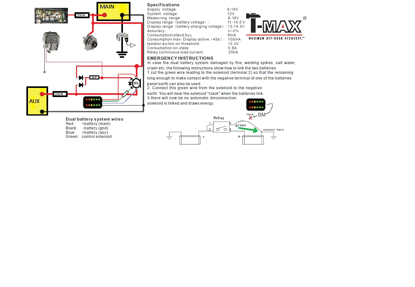

Great Write Up ! If you accidently short the green wire out of control module to 0volt ground , trying emergency override or testing your new install, trying to get coil to pull in, you will destroy the Mosfet output. Typical symptom is the control module always has the solenoid on as soon as green wire connected, no green link light on module. Emergency jump requires you remove the green from control module, then jump coil to 0V gnd. You can repair module if your an electronic hobbyist/Eng or know one. Part you need is any old n channel 3055 type mosfet in a dpak surface mount package.

This may or may not help - I have used my aux battery to start the engine when my main battery was low and having a hard time turning over. I pressed the "manually link" button and was able to get it going with no problem. However, I recall that if the main battery was too low, then the "manually link" button didn't work properly. Hope that helps.
Ed Driscoll's post above has a picture with text that describes how to force the batteries to connect by cutting the green wire and touching it to the negative terminal - T-Max Dual Battery Install

On a side note, instead of messing with the green wire to turn on and off the Solenoid manually. The other option is to remove the black jumper off the main battery lug (big lug) on the solenoid. Keep it installed on the small lug like the diagram shows and either use a relay or attach it to a keyed ignition source.
This way the solenoid will only operate when the key is on. This will eliminate the cycling in and off the the solenoid if you are using a charger or solar.
One other thing is that you can keep a pig tail to the main lug and with a female connector and have a male attached to the small lug so you can connect them incase you need to self jump start and the main battery is too low to trigger the solenoid.
