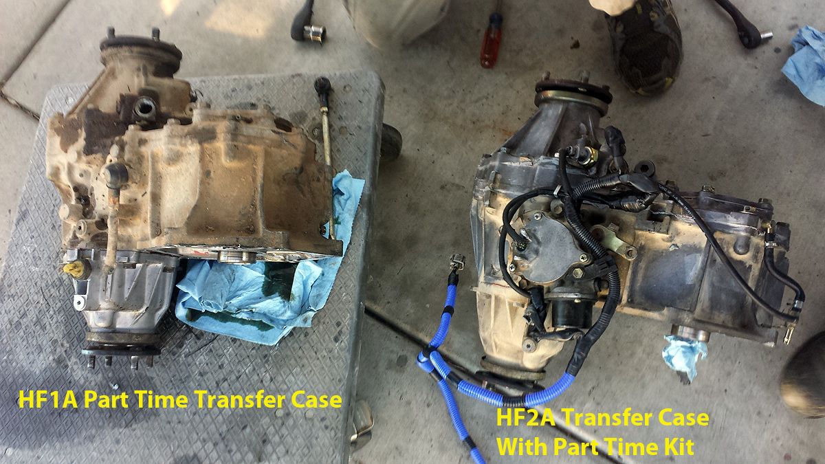

Pic related, plates have touched rocks.

There are three 80 transfer cases:
HF1A- part time
HF2A- full time
HF2A(V)- above + viscous coupler
HF2A is ~ 5" shorter than the HF2A(V), the distance the rear extension housing for the viscous coupler.
All are electronically engaged, electronically controlled (**)
They're all interchangeable, as far as BH, bolt pattern and spline counts, between HD/FZ specific autos and H150F/H151F manual transmissions.
That does not mean they're interchangeable across the 80 platform, since most (if not all) HF1A were absent ABS.

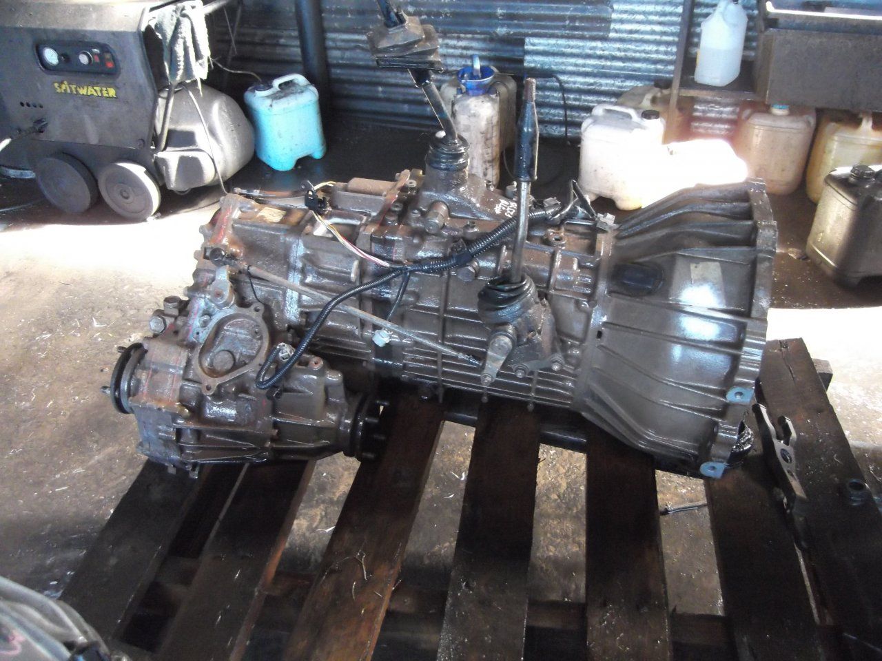

There is one variant of the HF1A wich it's complete manual ..

No 80 series institutions that I've found, only 7Xs, and few and far between since they'd be limited do the FZJ7Xs.
Not to say they don't exists, but so damn few even Google can't find them, and the shifter would come up somewhere under the 80 dash.
