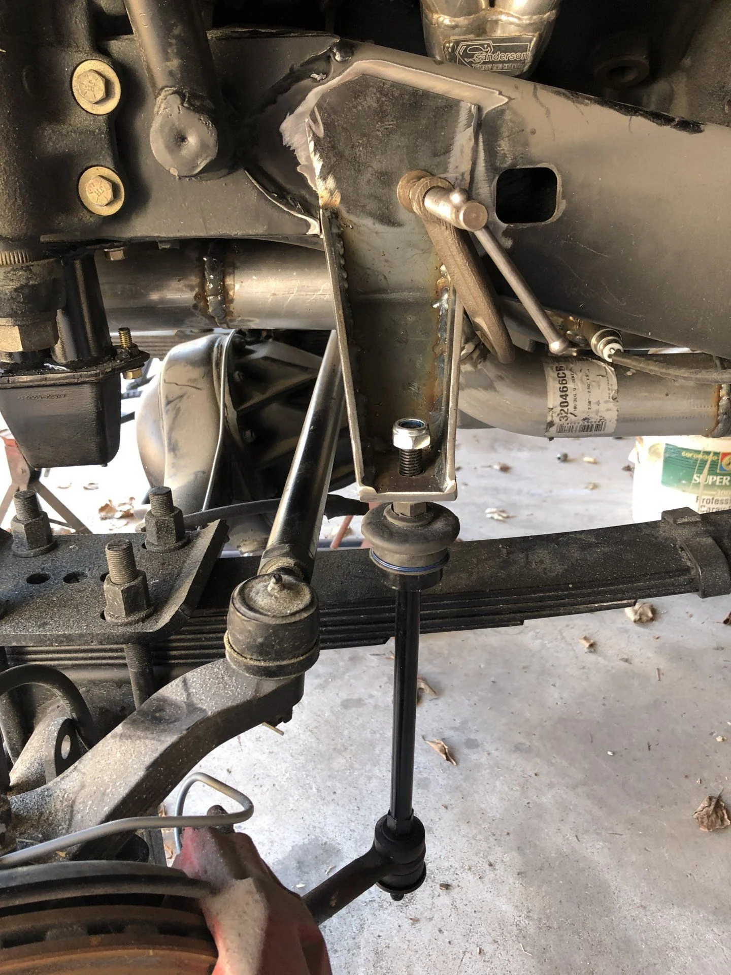

@NikP would you have a pic of your front connection points? I am thinking of just running the rear, but hanging on the the front bar just in case - I don't even know if the one I have is for the 60, might have fallen off one of the other trucks...
This is one picture I have handy. If you need more I'll be back united with my 55 next week and can take more
