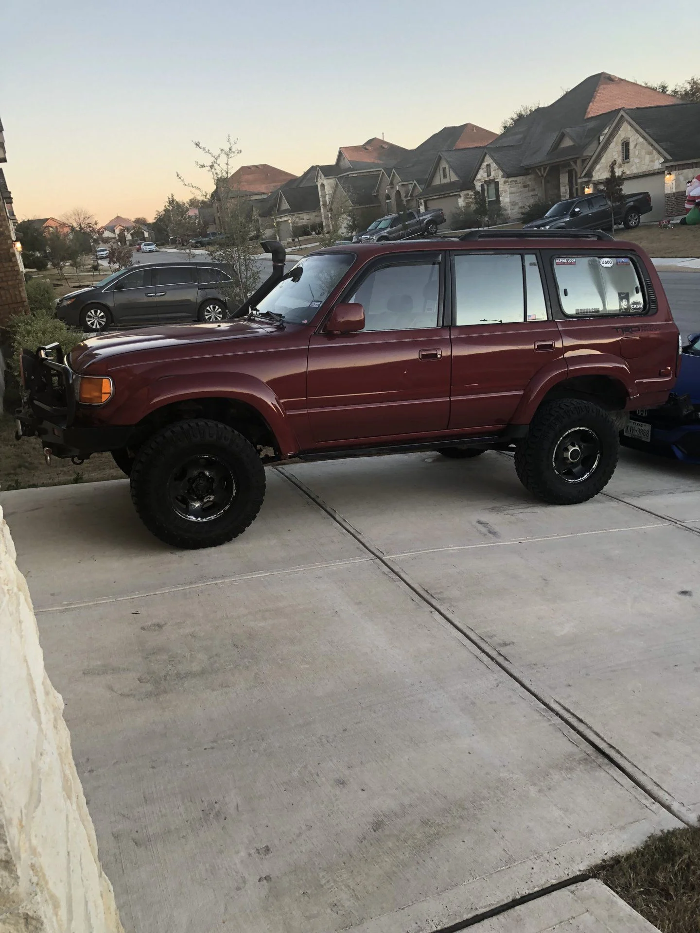

I have a 1993 FZJ80.. 225k when purchased last month. Want to look at options for S/C but i wonder if it would be a good idea with the miles on the rig. Where can I get one? Manufacturer? and or is it not a good idea?
Just spent 3k baselining the rig so I would think it is good to go.
Thanks. Brian
