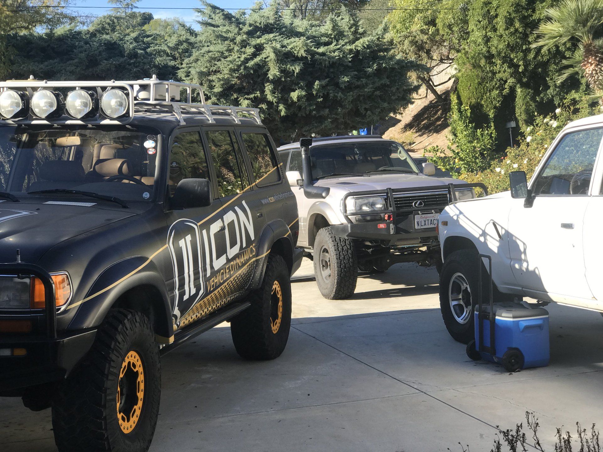

Awwwwwwwww s***! It’s about to go down!
Picked up the Test Mule this morning. I got one totally stock and unassuming. I can totally fly under the radar with no one guessing who’s truck is getting worked on to be the first. You’ll never guess so don’t even bother trying.

Don’t care whose truck it is. Only care that it works as planned. I’m excited. Do you need a working truck for CARB?
Yay. We need pix. Once the truck is running any idea how long CARB takes?
