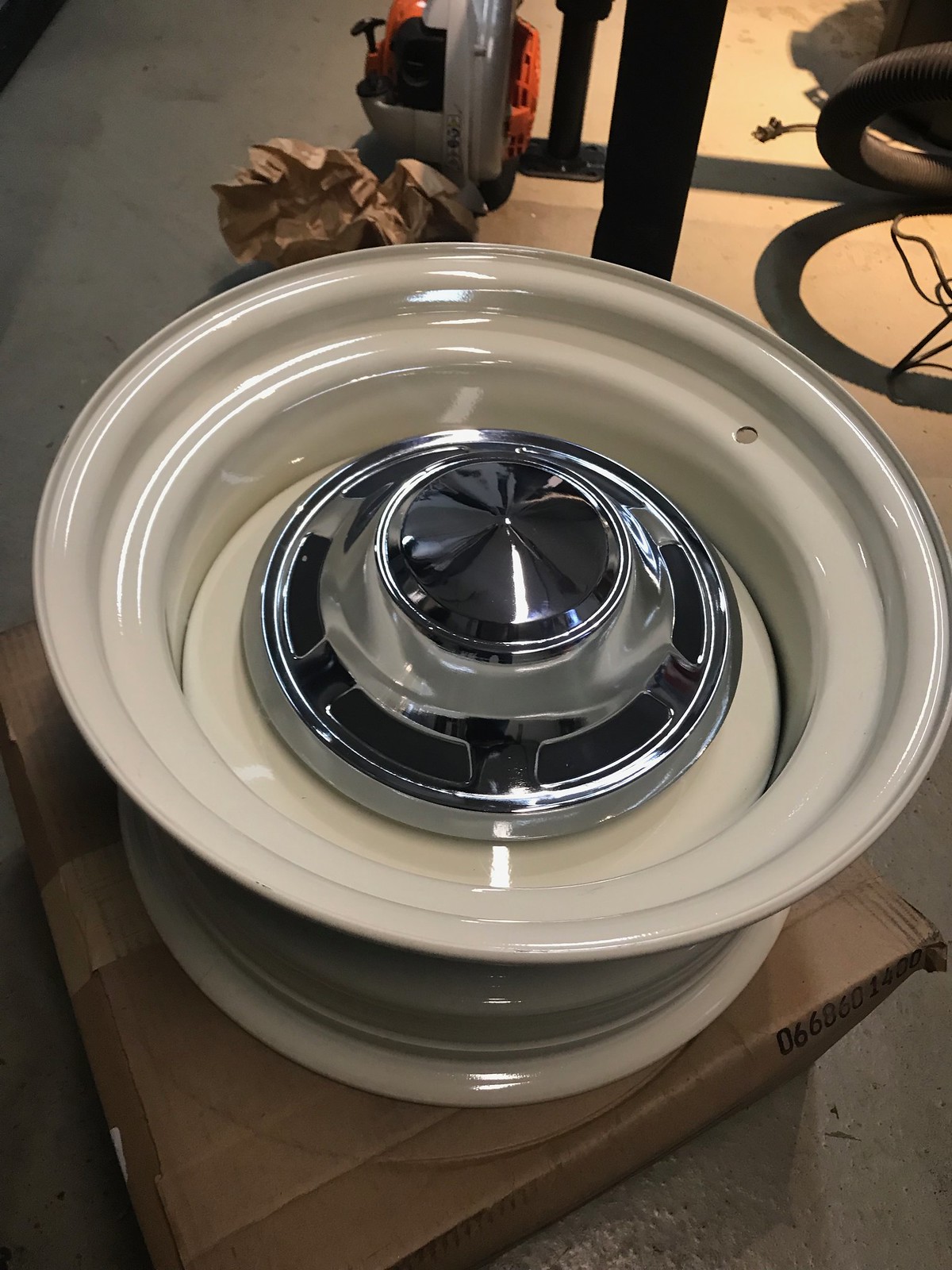

A little more progress today. My laser cutter jammed out some concepts for the cap adapter. We may roll our own rings out of stainless. He made some strips that can be rolled into a circle, bead rolled, and interlocked/tig welded. Also some donuts for adapting the Toyota cap to the new ring.
It looks like no matter what, there will be a gap between the hub cap and the wheel at the outer edge. It looks good still but it doesn't sit tight to the wheel like the original.
Nice! Can you get away with just painting the new ring and welded area? Or will the whole cap need to be re-chromed?
It might not effect the face at all actually. The Toyota cap has a back piece and the front piece so I am hoping to just mod the back piece to fit the Vintiques wheel.
I did completely remove (ruin) a hubcap to see how deep it can set to try to minimize the gap between the edge of the cap and the wheel face and it still has about a 1/4" gap. That's a bummer but it really still looks good and is pretty much unnoticeable. It's not bad enough for me to give up!

Looks good. That's what I had done on my wheels too. I just dont like how much the edge of the cap is away from the wheel but then again you really can't see it much.
Cost isn't bad to do your own. 15 ish for the Toyota cap and 10-12 for the smoothie cap. Just cut the dome off the smoothie cap and the lip off the Mr T cap.

Actually there is no gap, the cap was not actually snapped in the wheel, they are just sitting there in the pics I have above

I don't know how he made that work but that's good. On mine there is still a lip you can grab with your fingers with the cap snapped on. It looks fine that way but I had hoped to get the lip of the cap flush with the wheel like the originals when installed .
