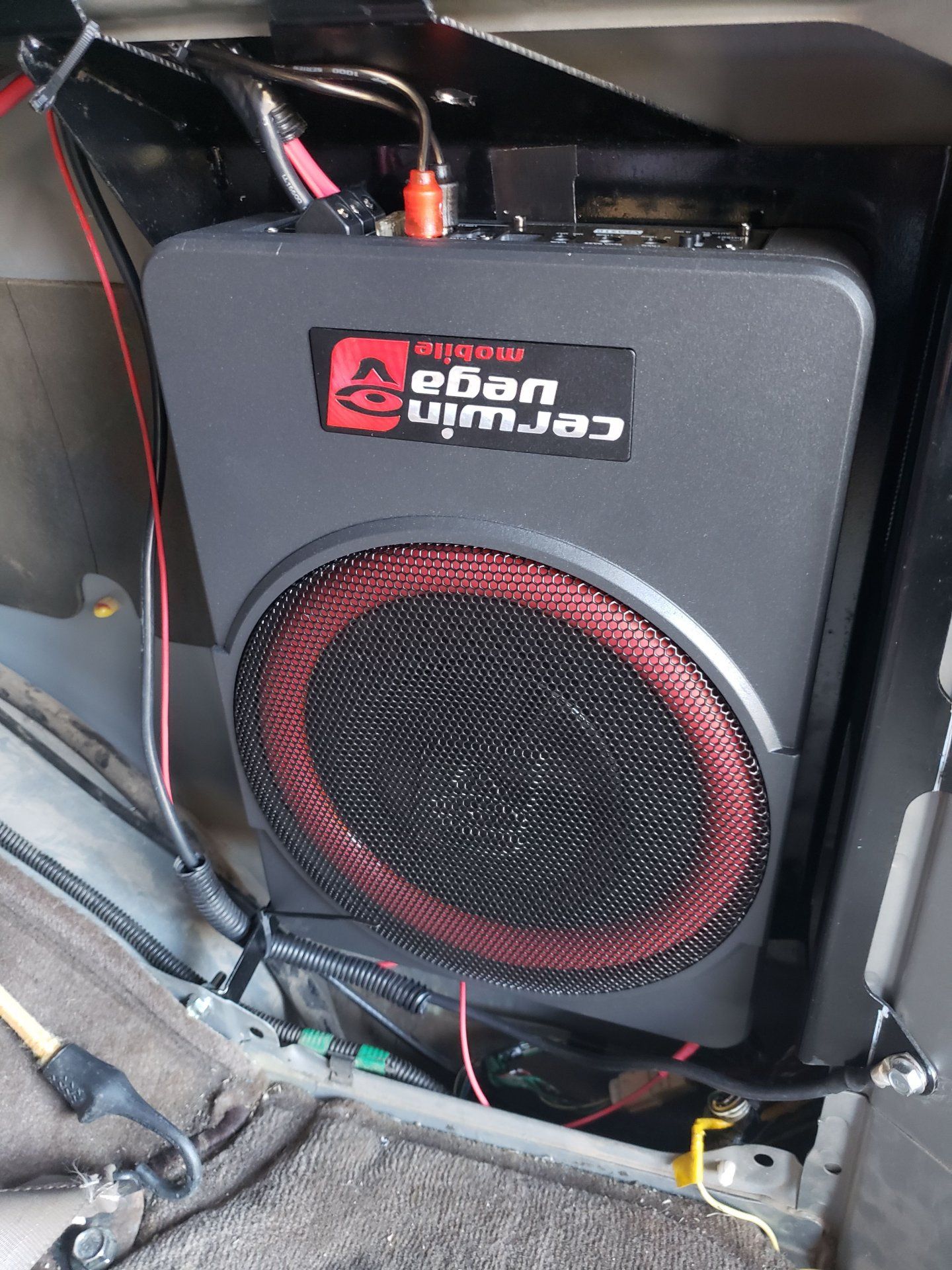

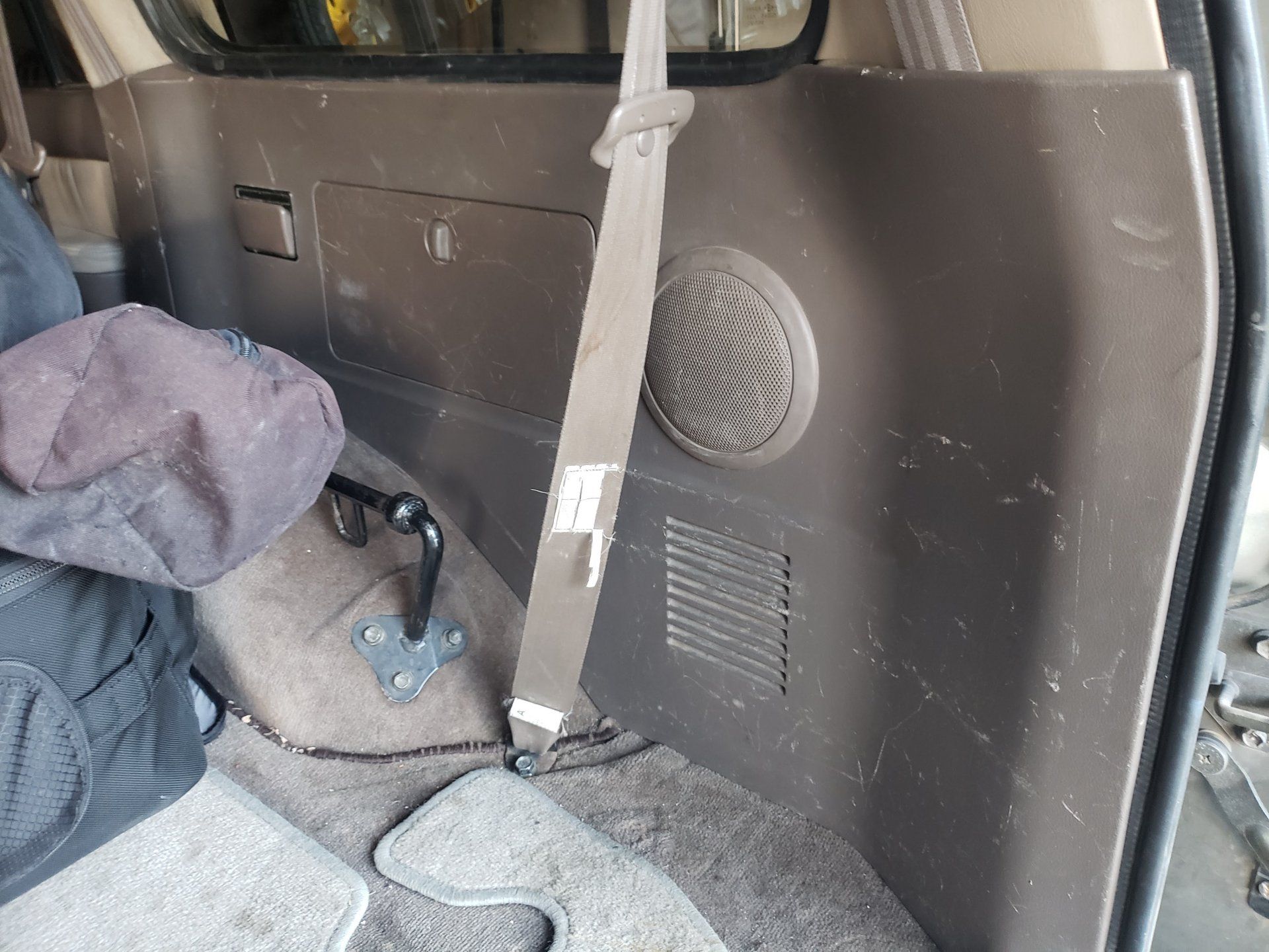

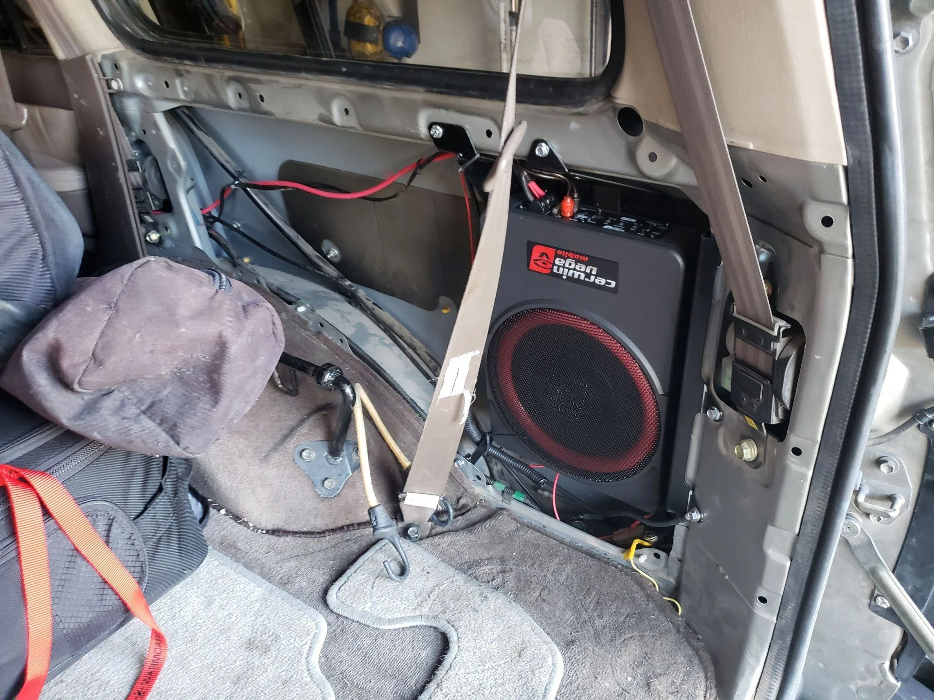

Forgot to follow up on my install. Worked great with the CV VPAS10. Much more bass than I was expecting, but it certainly isn't a tuned system. Some frequencies go by the wayside while some really come alive. Still 1000x better than before.

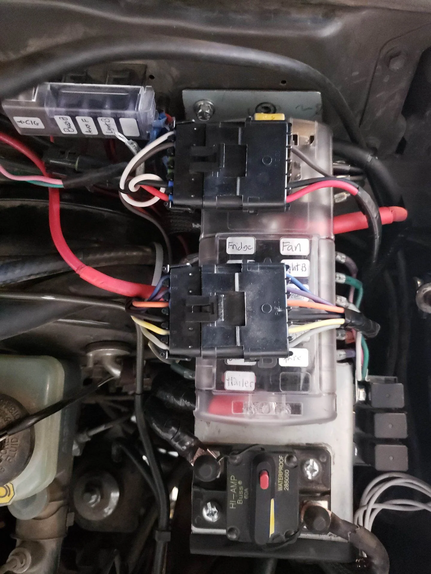

Was originally going to make it ignition hot, but the auto-on feature only drew tiny TINY amounts of power (less than 10 mA) so I decided to leave it battery hot.
You can see my big chonky 8AWG coming out of the battery hot side (top 6 circuits are battery hot with 2 being switched relays, bottom 6 are ign hot with a giant relay turning the entire buss on at once)
I may have missed it but did you use any of the factory wiring?
Thx
Thx
The only factory wiring was a single wire in the harness that wasn't being used that used to turn on the factory sub, I used that as the trigger from the aftermarket head unit to the sub to turn on. Everything else was 100% custom.

Im not sure if i ever posted my solution. Used a @NLXTACY wits’ end quarter panel mount to mount the VPAS10 and my speaker amp. Had to modify it to be able to wire my amp but it has worked great. Cheaper than what fab guys in my area wanted to make the mount in this thread. Can’t really put the trim panel back though as it rattles.
I’d be interested in the file or better yet, a spare bracket if anyone has one. Just curious if this bracket only fits this CV subwoofer or could be adapted to other similarly sized boxes. Also, i think this was mentioned before but all wiring/power would need to be re-run and not really feed off existing sub wiring?
